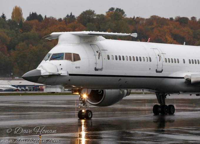

I don’t think the F-22 flying test bed was ever modified for Cheek array testing but I can check the ATF bible to see if that was the case. Adding cheek arrays is a fairly straight forward process as long as the operator considers the capability worth paying for compared to alternative investment priorities. Software development and testing is likely to be lengthier than developing the hardware itself. APG-77 came out of a partnership between what we now know as Northrop Grumman and Raytheon - companies that between them currently produce roughly 200 fighter AESAs a year with organic foundries Being US DOD certified for producing both GaAs and GaN for airborne radar applications..so it is not going to be a heavy lift for them. Of course alternatively, they may instead choose to invest in the DARPA MIDAS based next gen MMW LPI data links and gain SA and targeting data via off-board manned and unmanned assets. It will be a tougher and more technically challenging lift given the TRL/MRL/IRL levels for that program but things may well be happening in dark to support B-21 and other classified programs. I think a lot will be determined by what form of guidance and communication solution shows up on the AIM-260 JATM.
