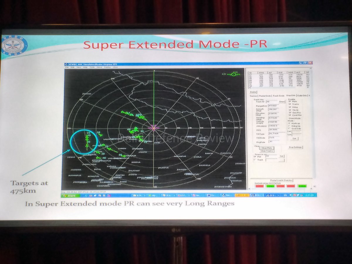

Just a reminder of how capable the Netra radar really is (via DDR):
Karthik S
Posts: 5380
Joined: 18 Sep 2009 12:12
Re: Airborne Early Warning & Control: News & Discussion
Post by Karthik S »
It has the same range as phalcon.
Posts: 20844
No, the Phalcon would have much greater range for the same RCS, but even so, it is substantial.
