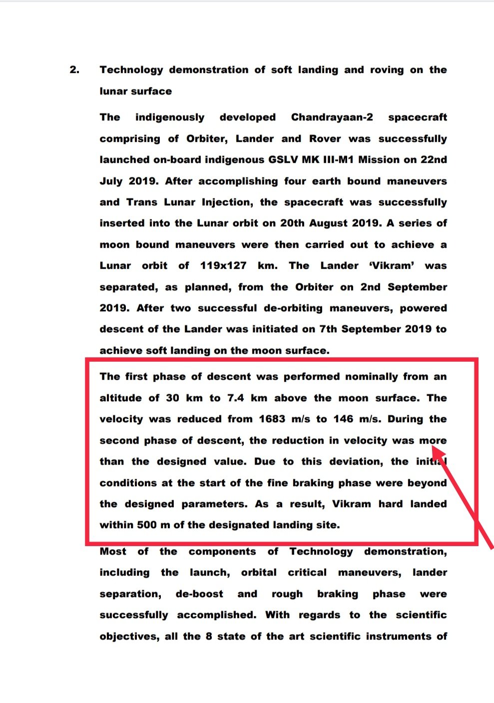

So how does this happen?
The control system expected the lander to be at higher speed for start of fine braking?

It appears that the reduction in velocity during the fine descent period was higher than the designed parameters. This might have thrown the software into tizzy and hence the crash landing.
My speculation, the lander has to go from point A to point B, but the braking is higher and the software realizes that it can only go to say A.5. Now it cannot add thrust! But it is designed to go to point B. And the software goes into an irrecoverable loop where all it has control on is varying braking thrust when it actually needs a 'boosting' thrust!
Re: Chandrayan-2 Mission
disha wrote: It appears that the reduction in velocity during the fine descent period was higher than the designed parameters. This might have thrown the software into tizzy and hence the crash landing.
Yes, S. Somanath had hinted at this in the podcast I had linked before. It was not a bug or glitch. The parameters of the craft were outside the design parameters of the software. He had said that the spacecraft is designed for tolerances around ideal values. Tolerances can be increased, but that comes at the price of added fuel.
He had said that there is no reason to not make the whole report public as soon as it is ready. Let's see.
Indranil wrote: Yes, S. Somanath had hinted at this in the podcast I had linked before. It was not a bug or glitch. The parameters of the craft were outside the design parameters of the software. He had said that the spacecraft is designed for tolerances around ideal values. Tolerances can be increased, but that comes at the price of added fuel.
I do not think I ever said it as a software bug or a glitch. My first post on this subject did say that the control software might have been presented parameters out of its design bounds. My thinking at that time was Vikram could not get a lock on the safe spot to land and that might have presented unbound parameters.
Now we know that the more than anticipated reduction in fine descent created this situation. And throwing software in tizzy is what I mean by control laws not able to gain control over the situation due to out-of-control events. :)
IMPORTANT: What Vikram attempted was far far far more complex than landing a craft in a region which is as smooth as a baby's bottom (comparatively and figuratively).
I am also *not* in favor of revealing the whole report in public. First of all the DDMs will not understand a difference between control and law and go into #Blow2ISRO mode. Second it will reveal the antecedents of the software. Since what is the difference between landing Vikram on a remote spot and a 'dharmo' on another remote spot? Other than former being more complicated.

Finally, an official response on how #Chandrayaan2 lander #Vikram lost control. See attachments: Left: My story that "extra brakes may have sent it out of control", Right: Govt reply in Lok Sabha saying the same.
Read Full Report Here:
Extra braking caused Vikram to deviate: Govt in LS

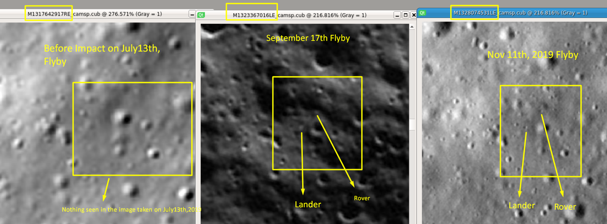

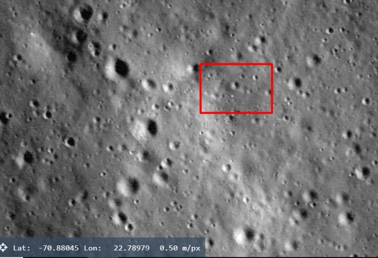

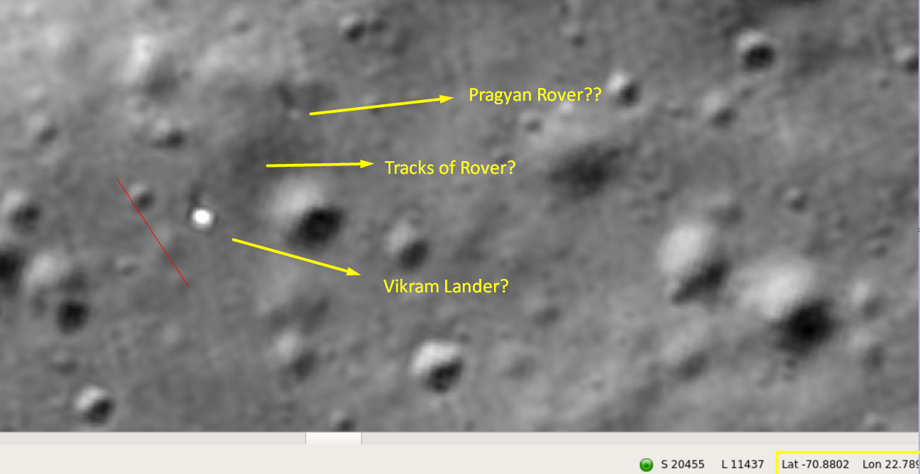

NASA Finds India’s Vikram Moon Lander Crash Site, With Amateur’s Help
NASA has found pieces of Vikram, a small spacecraft that India attempted to land on the moon in September. They did it with the help of an engineer from India who scoured the lunar surface in his spare time.
Vikram was part of India’s Chandrayaan-2 mission to the moon, which launched in July. If the spacecraft had reached the surface in one piece on Sept. 7, India would have been only the fourth country to successfully put a lander on the moon. But less than two miles above the surface, Vikram veered from the planned descent trajectory and fell out of radio contact.
India’s space agency said the next day that it had located the lander. But it never published any images of the hard landing site taken by the mission’s accompanying orbiter, which remains in operation and is carrying out a scientific mission that will last for years.
A NASA spacecraft, the Lunar Reconnaissance Orbiter, has passed over the mission’s intended landing site, on a high plain near the south pole, several times since September. But initial analyses of the images did not reveal an obvious impact scar comparable to the Beresheet lander launched by Israel this year, which crashed in April. NASA scientists noted that the spacecraft might have been hidden in the shadows.
A lot of people were looking, including Shanmuga Subramanian, an Indian computer programmer and mechanical engineer.
“The crash landing of Vikram rekindled an interest in the moon not only for me and others also,” he wrote in an email. “I think even if Vikram had landed and sent some images, we would have never had such interest. For the first few days I was scanning the images randomly and there were lot of false positives.”
After reviewing the last known velocity and position of Vikram, Mr. Shanmuga shifted where he was looking. He noticed a white speck on the lunar surface that was about two-thirds of a mile from where Vikram was supposed to have set down. That speck was not visible in an earlier image. He wondered if the crash might have buried the lander in the lunar soil.
Mr. Shanmuga reported what he had found to NASA and scientists working with the Lunar Reconnaissance Orbiter’s camera, who confirmed his finding and scoured the surrounding area. Comparing images taken before Vikram’s landing attempt and those taken on Nov. 11, they were able to identify the impact point about 2,500 feet to the southeast of the planned touchdown site, and a spray of debris emanating outward.
The pieces of debris were not much bigger than the minimum of what the camera could make out. The resolution of the camera was about 1.3 meters per pixel; the three largest pieces of debris were about two pixels by two pixels in size and cast a one-pixel shadow, NASA said.

Few comments:
1 - This was by a joint effort - NASA's LRO/LROC's images are in public domain and thousands of people use it -- many were looking for Vikram. There were *many* reports/joint-efforts - people finding something "intersting" and other better experts looking it, verifying and confirming it.. slow process. These images were from October 15 flyby , and as I posted then it was likely to take months to go through all the millions of the images .
2 - It is quite *hard* to "identify" using images - very hard, difference is literally pixels - you can't really resolve it to see anything other than seeing a dot which was not there before.
3 - See <this> to see before/after images. Gives some idea why not everyone was able to see it right away.
Now perhaps one can see CY2's high resolution camera to see more details since we know the actual location now.

They have said that earlier clearly
Link - https://www.isro.gov.in/updates-archivals

Gerard wrote:Vikram Lander Found
Update from Shanmuga Subramanian (The person in above news) on twitter: Chandrayaan2's Pragyan "ROVER" intact on Moon's surface & has rolled out few metres from the skeleton Vikram lander whose payloads got disintegrated due to rough landing .. More details in tweets <click>
1.Debris I found was of Langumir probe from the Vikram lander
2. Debris NASA found might be from other payloads, antenna, retro braking engines, solar panels on side etc.,
3. Rover has rolled out from lander & has actually travelled few metres from the surface
South Pole region is not always well lit and the lander was in a shallow depth of 2 ms from the surface so it was not visible in Nov 11th's NASA flyby due to different angle of incidence & would be difficult for anyone to find it unless the sun is directly above the surface
Since sun is never directly above moon's surface in that region, it would have been so difficult, the above image was taken on Jan4th, 2020 | The 1st image I tweeted is enlarged version of the below image
The person has communicated to ISRO - Have not seen official response.
