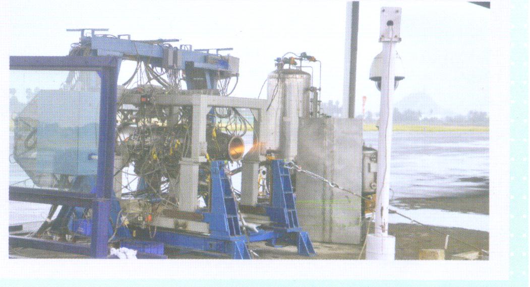

https://twitter.com/ReviewVayu/status/1 ... 11137?s=20 ---> HTFE-25 Core Engine Sea Level Trials Successful: The team of AERDC achieved a milestone with successful competition of Hindustan Turbo Fan Engine (HTFE)- 25 sea level trials at Tambaram Air Force Station, Chennai.
https://twitter.com/ReviewVayu/status/1 ... 92896?s=20 ----> Core engine of HTFE-25 was tested for various phases including starting trials with indigenously designed and developed Air Producer (AP) and Air Turbine Starter (ATS). Light-up trials with different fuel flow settings/air inlet temperature condition were carried out.
