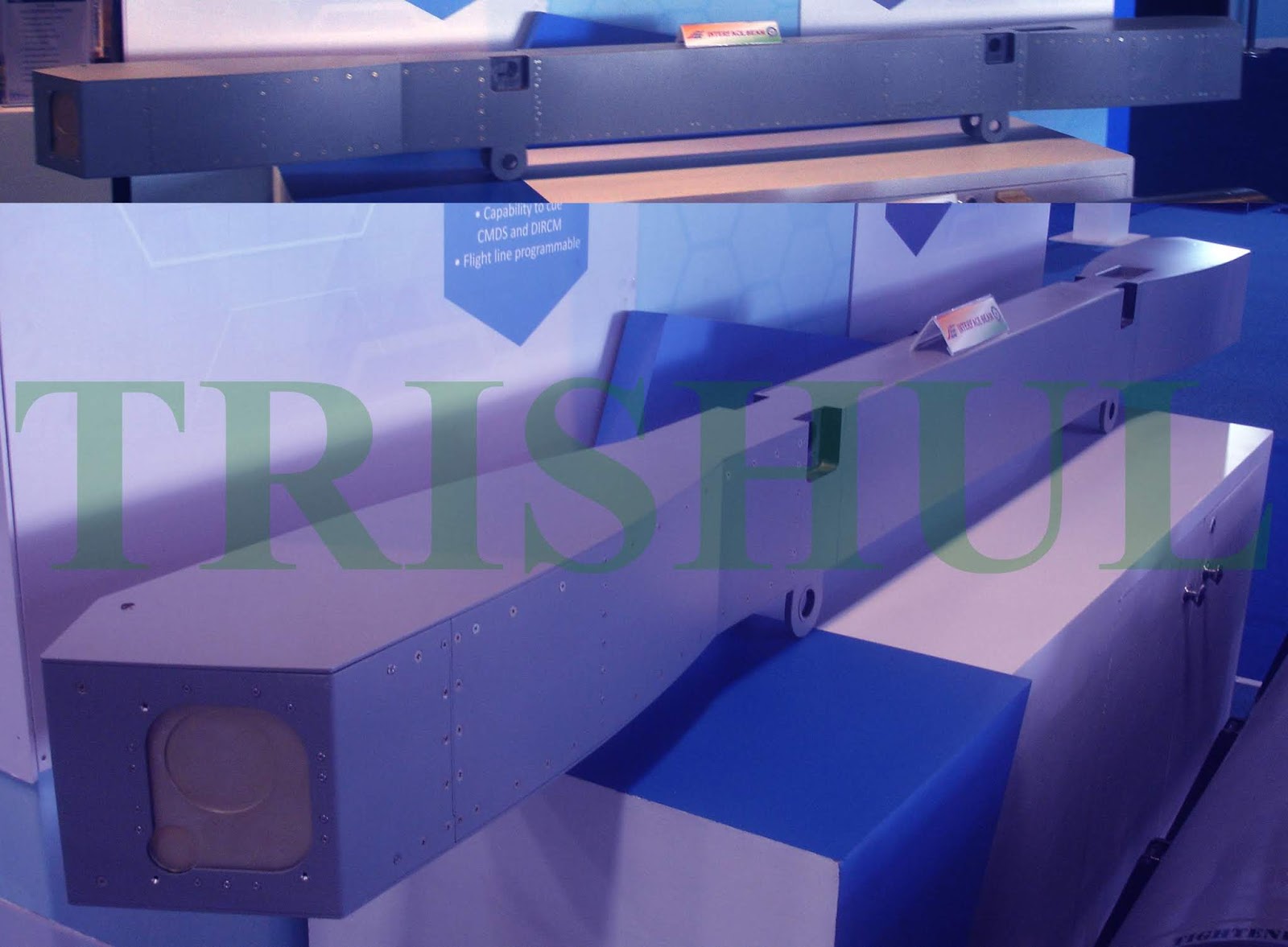

Next, the fitment shown as a pylon is actually the DCMAWS fitment. Not the MILDS-F fitment. For reference see this:
As we can see, each pylon now has two DCMAWS and one up and one down sensor.

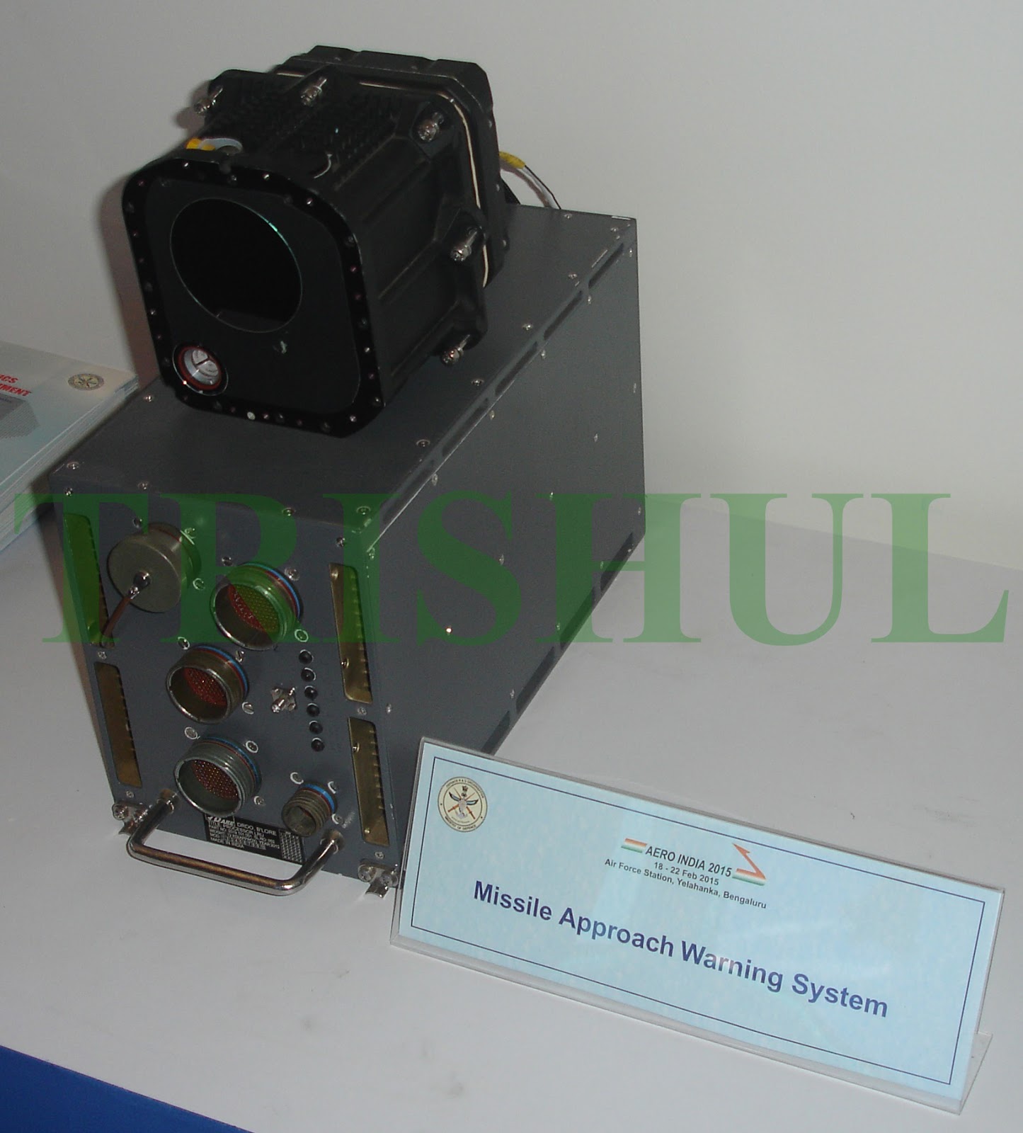

Now lets look at the DCMAWS picture release. Check the characteristic *two-windows* in each sensor but the sensor housing itself appears substantially bigger.
https://4.bp.blogspot.com/-Q6s3hfalkQ4/ ... MAWS-3.jpg
This matches what DARE itself displays, look at the bottom part of the pic:
https://2.bp.blogspot.com/-VHkYtIYz580/ ... -30MKI.jpg
Or
https://4.bp.blogspot.com/-kfhn4evoHg4/ ... 2BMAWS.jpg

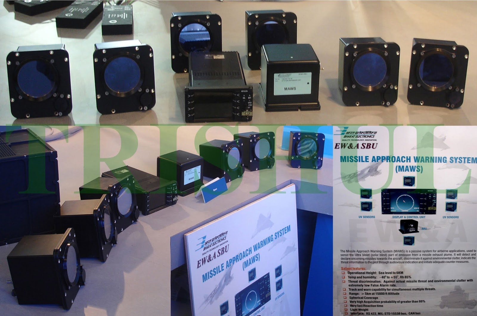

The Cassidian now Hensoldt MAWS units which were sold to India as part of the Cheetah upgrade project for the IAF, but which are now being added to the IAFs Mi-17 choppers may look similar but they appear smaller and a second aperture, even if it is present, is located elsewhere:
https://1.bp.blogspot.com/-fWOYqq9vJ2w/ ... 2BMAWS.JPG
But these do not match the top part of the collage which is Hensoldt's MILDS-F proposal as advertised by Alpha Design (their India representative) which image again matches the Hensoldt brochure above.
Putting all this together, it does not seem probable at present that Hensoldt has a 2nd DC MAWS sensor specifically for India which is also competing with their primary offering the AN/AAR-60 which operates in a different band.
If DARE uses the simpler MAWS optic, then their proposal would no longer be a Dual Color MAWS, so why even retain the name.
DARE continues to maintain its MAWS is not a UV MAWS but one based on the DC concept. 2019 updated website,

IR based MAWS based on the dual colour concept has been developed by DARE for fighter aircraft and currently is being integrated into Su-30 MKI aircraft.
Re: Su-30MKI: News and Discussion - August 9, 2014
DARE's MAWS is indeed the midband IR based system and does not use UV. UVMAWS is on helicopters atm working with an RWR. Dual colour from
By carefully choosing two wavelength bands [1] (red channel 3.5-4µm and blue channel 4.5-4.8µm) in the MWIR (3-5µm), the contrast between missile plume and background can be maximized.

I think you guys are right. And I am happy that you are.
The gent who told me this was obviously confused between the parallel project with EADS+Alpha+BEL to provide MAWS for the wide-bodies and rotary-wings.
Yes, I think so too.
He has mixed up the DARE program with Alpha for a MSWS solution for cheetahs and chetaks with the DCMAWS.
This was a project done along with Alpha, this accounts for those BEL MAWS posters:
https://economictimes.indiatimes.com/ne ... aign=cppst
Meanwhile HAL also has a parallel program sourcing Grintek now SAAB MWS/LWS etc for its ALH, LCH etc.
Alpha has also won a tender for the Mi-17 upgrade program which includes MAWS.

Well what do we have here! (Wingtips are loaded with the SAP pods)
https://twitter.com/hvtiaf/status/12364 ... 32160?s=20 ---> SAP-518 integrated on Su-30MKI wing tip stations. It's an electronic counter measure podded system. Impregnable. Extremely effective against radars & EM/RF missiles in its operating band of 5-18GHz.
https://twitter.com/hvtiaf/status/12366 ... 73984?s=20 ---> SAP-14 of has some envelope limitations. Su-30 equipped with SAP-14 & two SAP-518 pods is in-famously called Growlerski by some westerners, due to its immense ECM capability. I presume Growler also has envelope limitations.

^^ Looks like the SAP518
