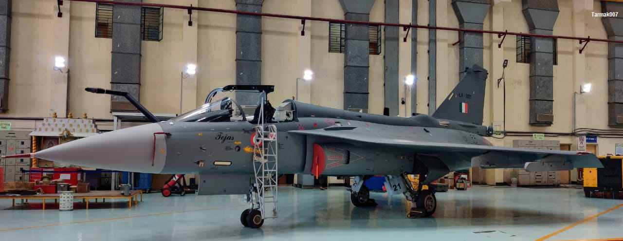

HVT Twitter Link: First pictures of SP21 from Deb Rana!
https://twitter.com/hvtiaf/status/1239941938758860801
Posts: 5546
SP-21 boasts of key features like air-to-air refuelling probe, Gsh-23 mm gun, pressure refuelling with three drop tank configuration, improved wing navigation lamp, tandem pylon and auto-low speed recovery, to name a few.
Great news. Any pictures of the tandem pylons? What kind of payload can we expect? 2 x Derby? Are these Derbys the ER variant?

The first flight didn't have the ubiquitous wvr aam on the outermost pylon as flutter weight.
Also the midboard pylon were fitted to cover the Kuchemann Carrot behind it.
Happened before? Are these the new normal?

IR and other gurus two questions. I presume the gun hasnt been fired till date in air, true/false? Second, in one of the LSPs the small little hole on the spine(pardon my terminology) close to the vertical stabilizer was have a rounded clam shape however, nowadays they have gone back and made it regular duct shape whats the story behind it.
Posts: 5872
It is still the same air intake at the base of the vertical tail. The inlet pops out during certain phases of flight and then pops back in during others. No change here.
Posts: 5872

https://twitter.com/writetake/status/12 ... 16673?s=20 ---> In this pic, the man wearing the jacket is M S Velpari, HAL's Director Operations. This is said to be taken an hour before yesterday's first flight of Tejas SP-21. Not sure what he is checking. Velpari was with LCA Division before Govt picked him up for top board role.

Posts: 14744
Rakesh wrote:https://twitter.com/writetake/status/12 ... 16673?s=20 ---> In this pic, the man wearing the jacket is M S Velpari, HAL's Director Operations. This is said to be taken an hour before yesterday's first flight of Tejas SP-21. Not sure what he is checking. Velpari was with LCA Division before Govt picked him up for top board role.
The GSH 23 mm canon is very neatly placed, but from the place it is kept it will be more useful in Ato G role, in a turning fight the Tejas will have to out turn its opponent to get a gun kill.
suryag wrote:IR and other gurus two questions. I presume the gun hasnt been fired till date in air, true/false? Second, in one of the LSPs the small little hole on the spine(pardon my terminology) close to the vertical stabilizer was have a rounded clam shape however, nowadays they have gone back and made it regular duct shape whats the story behind it.
1. The gun hasn't been fired in the air. But did you notice the unpainted area just ahead of the gun in SP21. First time ;-)
2. The inlet at the base of the fin is for the ECS and heat exchangers. The previous one was very draggy. They tried to replace it with a hump and a NACA inlet. That was tested in LSP 7 and 8. But, the NACA inlet did not produce adequate air supply. So they have now settled on the current inlet. Kartik, it is fixed, doesn't open and close. It is an engineering solution that works well enough. To me, it is an eyesore. I give the friends a hard time for it :-).
Huh! A bullet flies straight relative to the aircraft (parallel to the longitudinal axis of the aircraft). It doesn't matter whether it is shoulder mounted or belly mounted or wing mounted. The aircraft doesn't come in the way of the bullet. Aircrafts always have to turn "inside" the target in an aerial gunfight. Similarly, Tejas no advantage over aircrafts with shoulder mounted guns in A2G gun-targets.
