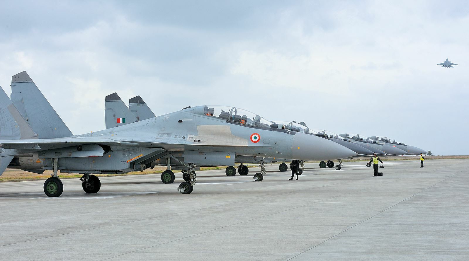

In my eyes - this is the best looking flanker and definitely amongst the most beautiful fighters ever. Have to give credit to the russkies - all around, any angle, the flanker and the 57 look great. French fillies are nice too and the Americans are TFTA personified. But the flanker is gorgeous even more than the fulcrum...
