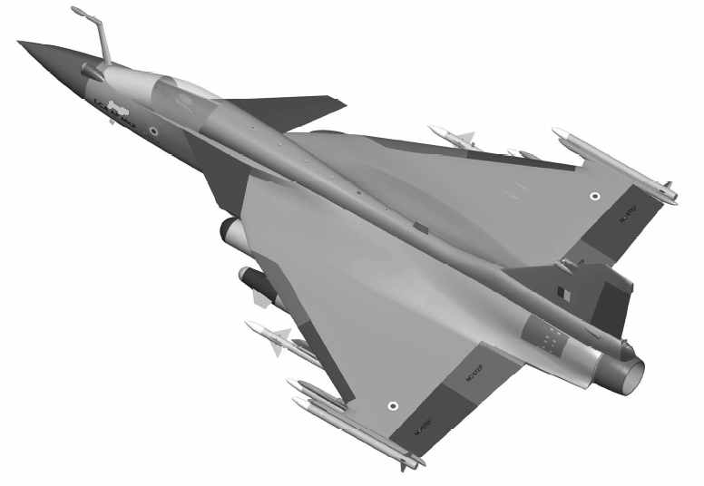

From Vayu's March-April 2020 issue
-Preliminary design is almost done.
-Detailed design to begin from March 2020 (with Covid-19 most likely adding some schedule delay)
-Raw Material and LRU procurement has been started
-Development activities towards new LRUs started
The Tejas Mk.II for the Air Force was initially planned to have a higher thrust engine. However, in its new configuration it is no more a light combat aircraft but will be a Medium Weight Fighter (MWF).
This evolution of the MWF began with the IAF projecting a platform to replace the Mirage 2000, Jaguar and MiG-29 in the 2030s. The IAF wanted a multi-role fighter with improved range, endurance, lethality and increased payload carrying capacity. Based on these requirements, configuration optimisation studies were initiated by ADA in November 2016, a configuration with improved performance and increased internal fuel has thus evolved. Subsequently, the IAF also indicated their requirement for integrating heavier standoff weapons.The final configuration was agreed to in September 2018 to meet these capabilities.
Preliminary design of the MWF is at the final stages of completion and detail design activities are to begin from March 2020.
The procurement of raw material and LRUs has been initiated and development activities towards new LRUs initiated.
The engineering cockpit simulator of the MWF was on display at Defexpo 2020, with a Large Area Display (LAD), sleek Head Up Display (HUD) and side control stick.
