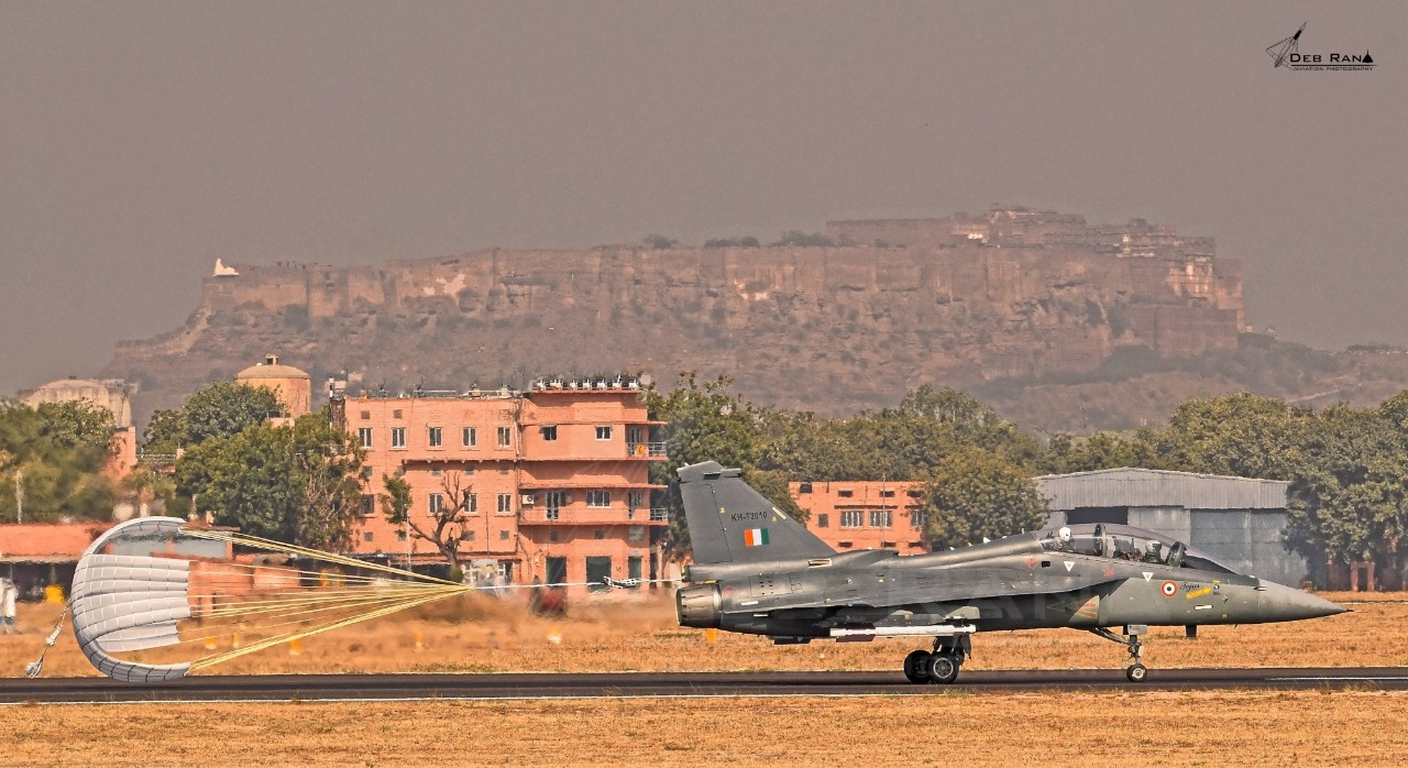

I don't know if we have discussed this here. This was a ferry flight from Bangalore to Jaisalmer.
They landed with 800 kg of fuel left. Flying at around FL 280-290 (28000-29000 feet). Higher cruising altitude will lead to higher endurance and range. Current flight ceilings during ferry flights are regulated by DGCA. So, brochure ferry range and endurance without refueling should be around 2800 kms and over 3.5 hours.
Unfortunately, the DTs are not optimized. Addition of the 3rd tank increases range by a little over 100 knots. The 1200 ltr DTs will be changed to 1360 ltr DTs which dont have much higher drag and have better weapon separation characteristics. The centerline tank is going to get bigger with an oval cross section.
I love this picture too. With Umaid Bhavan in the background and the USAF chief in the rear cockpit.
This one bbn is clicked by Mao sir. First flight of NP2 with tail hook integrated.
Tejas in front of Umaid Bhavan and Tejas in front of Mehrangarh for have to be some of the best pictures of Tejas.
