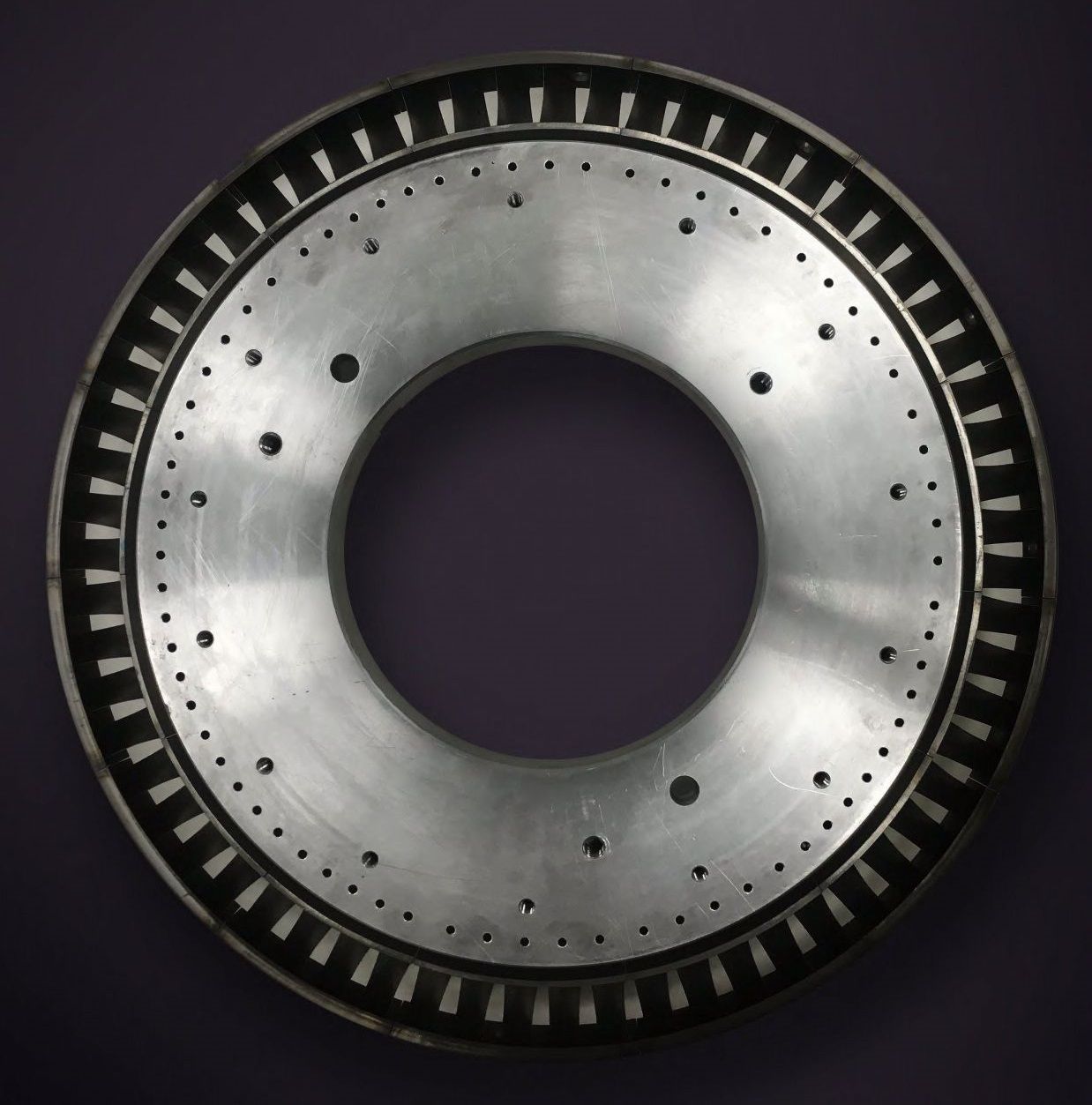

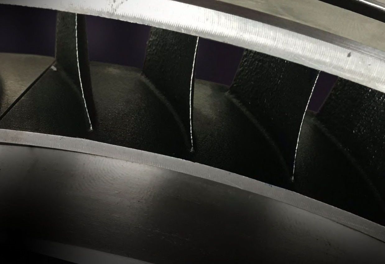

Not true ... we have had SCB Tech ready for many years now, DMRL have had been putting up SC-based (they have patented it as DMS4) HPT Blades and Vanes, in various expo-displays for many years now ... refer to one of my earlier posts, that refers to being displayed in 2015, if not even earlier.
And before somebody starts decrying it, as another-SDRE-produced-and-so-absolutely-useless thing, pls remember this is 4th Gen SCB with YSZ-TBC coating (via EBPVD) and with convection-cooling-holes.
(*most probably laser-drilled, but I myself have not seen any direct proof of these convection-cooling-holes being laser-drilled part - indirectly though, since there're not many other ways of getting convection-cooling-holes on a TBC coated surface, it is safe to assume that tech has also been mastered indigenously) - but I digress.
Betw this tech is so much more advanced than what is there in the so-called "licence-produced" and "indigenously-manufactured" made-in-Koraput-solid-SC-blades of the AL-31F etc crap that you get to hear from Rodina-lovers here in BRF, that it is beneath-contempt to even respond to it - so I don't even try.
But the above is really half-glass full story - what is really needed is industrial-level manufacturing base of "SC blade-batches" - another technology in itself. Some details on it in Points 1 and 2 of another one of my old posts.
And no, nobody, repeat nobody, is going to part that tech.
<more reading>
<even fun reading>
Drilling holes is a "oh that isn't an issue at all for us today" thing. The AL-31FP on the MKI has a TeT of 1650K aka 1376 celcius. Compared to the 1455 celcius of the Kaveri.
Btw, how much do you think the fan/engine casing weighs? SiC blades and vanes are many years away.

https://twitter.com/strategic_front/sta ... 46720?s=20 ---> High pressure compressor stator for the HAL HTFE-25 manufactured by 3D printing using the alloy Ti-6Al-4V. A stator converts KE into pressure energy. The complete design to realize cycle for the combustion chamber was done in less than 5 months, traditionally it takes 14 months.
maitya
Posts: 871
Joined: 02 Feb 2001 12:31
Post by maitya »
Rakesh wrote:https://twitter.com/strategic_front/sta ... 46720?s=20 ---> High pressure compressor stator for the HAL HTFE-25 manufactured by 3D printing using the alloy Ti-6Al-4V. A stator converts KE into pressure energy. The complete design to realize cycle for the combustion chamber was done in less than 5 months, traditionally it takes 14 months.
<snip>
Confusing tweet ... is he talking about HPC stator (looks that way) or the combustor!!!
The image is of a Stator (maybe for HPC stage, as the caption says) ...
However still good news, as it compresses the overall timeline significantly ... better would have been if they could invent a 3-D Mfg tech for CMC based stators (especially for the last stages of the HPC which uses Ni superalloys etc) - typically density of CMC is about half of that of Ti alloys (so ~half the weight for a given volume/geometry of the stator etc).
But still good news ...
