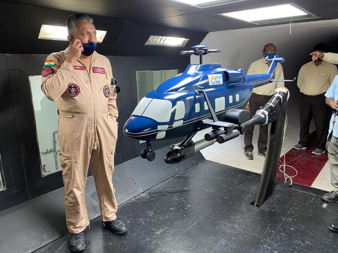

If they're conducting wind tunnel tests with wings and rocket pods then the base model design must already be the final version.ashishvikas wrote:An interesting pic of IMRH wind tunnel test under the watchful eyes of Wg Cdr Unni Pillai (Retd), Executive Director (Flight Operations-Rotary Wing), HAL. The prog is slowly and steadily picking pace. And, that'd good news on #AFDay2020 .
https://twitter.com/writetake/status/13 ... 03/photo/1
IA/IAF version with 300 nos requirement.
IN navy is still not on board for naval version of IMRH. They can't wait for a decade. They want NMRH 123 nos order asap.
The model shows 4 *19 *70 mm pod = 4*282.5 kg=1130 kg external payload.
Should be able to 4* quad ATGM launchers/ gun pods.
Why would you need ATGM launchers for a medium lift helo. This will be approximately in the same weight class as the Mi-17. There is no need for either the IA or the IAF to be arming these with ATGM's when they can easily buy as many LCH and Rudra as they require. The armed Mi-17's of Kargil came about because our Mi-35's had limitations at high altitude which the Mi-17's did not. It was a suboptimal solution that did not work very well and is no longer needed. Even those did not go beyond rocket pods.
You test all possible configurations in the wind tunnel so that any future requirement does not result in a major redesign and if the worst case scenario does not have a significant penalty then you know you've a good design. A wind tunnel configuration does not necessarily represent the final configurationnachiket wrote:Why would you need ATGM launchers for a medium lift helo. This will be approximately in the same weight class as the Mi-17. There is no need for either the IA or the IAF to be arming these with ATGM's when they can easily buy as many LCH and Rudra as they require. The armed Mi-17's of Kargil came about because our Mi-35's had limitations at high altitude which the Mi-17's did not. It was a suboptimal solution that did not work very well and is no longer needed. Even those did not go beyond rocket pods.

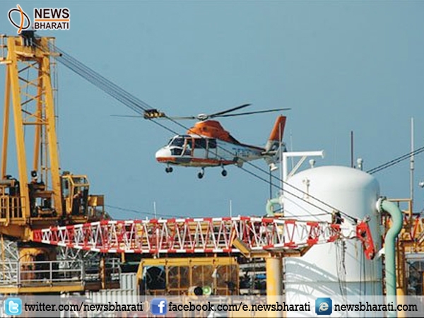

There is one more Indian agency with 42 helicopters having the same requirement as NUH. Pawan Hans.
They fly in very harsh monsoon conditions to ONGC Oil Rigs ferrying supplies in stormy seas and transporting and evacuating ONGC personnel.
https://www.pawanhans.co.in/english/inn ... enu_id=169
For 20 years neither ONGC nor Pawan Hans have shown no interest in Dhurv.
Why?
Note Pawan Hans lady pilot in white uniform.
Ship landing
On Ship Deck
Video
https://www.youtube.com/watch?v=7ayUwv_aYL4
BTW given that Pawan Hans helicopter are the only helicopters other than Coast Guard that flies into the high seas ONGC oil fields in Arabian Sea and Bay of Bengal, the IN is very intimately aware of its operation.
