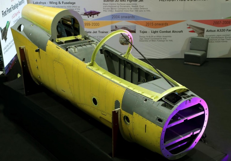

I dont think tsarkar meant ICY stuff is a deal breaker.. i think he was explaining modern manufacturing processes wrt planes.
LCA front fuselage with all the composite glory. I am pretty sure, the airframe life will be one of the best in the world, with this level of composites.
https://pbs.twimg.com/media/El0tX2nW0AE ... =4096x4096
Open in another window for the full image.

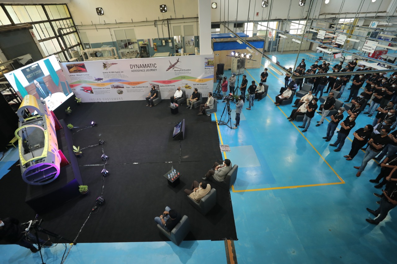

Dynamatic Technologies Limited completes the First Front Fuselage Final Operation Clearance Configuration for Hindustan Aeronautics Limited.
Dynamatic has built the first front fuselage for the Final Operation Clearance (FOC) version of the Tejas Light Combat Aircraft (LCA). This is the first time a complex fuselage section for a supersonic fighter aircraft has been built by a private sector company.
Dynamatic has been a preferred production partner for Hindustan Aeronautics Limited (HAL) for over three decades on all their major platforms.
The completion of the First Front Fuselage was witnessed by Mr. R. Madhavan, Chairman & Managing Director and other Senior Executives from HAL. The event was virtually addressed by Dr. Ajay Kumar, Defence Secretary, Government of India.
Dr. Ajay Kumar, Defence Secretary, said "I am really happy and honored to join this historic occasion, when the first front fuselage of LCA has been handed over to HAL. I would like to heartily congratulate Dynamatic and HAL LCA team who have made this joint partnership greatly successful. I think this is the model for PSU Private Industry partnership in Defence Aerospace sector and we hope that this example will hold good stead for several other partnerships by HAL and other PSUs as well.
The future generations of LCA will continuously grow. And we continue to see this as an evolutionary journey which will take India to newer heights in the fighter jet aircraft segment."
HAL Chairman & Managing Director, Mr. R Madhavan said, "Dynamatic has done it again by delivering the first front fuselage of LCA Tejas. The LCA program has a requirement of 20 Aircraft sets per year and will grow with MK2 and AMCA. Dynamatic is a known and reliable supplier for HAL, and we will also look for opportunities on trainer and UAV platforms."
Dynamatic Technologies Limited CEO & Managing Director, Dr. Udayant Malhoutra said, "Dynamatic has been privileged to be a production partner with HAL and the Ministry of Defence for three decades. The Industrialization of LCA has gone through many upgrades during the building process. This is the FOC version with a mid-air refueling probe, and is a tremendous success story both of indigenous defence production, and for public-private-partnership with HAL."

A great day for India's aviation industry.
A private company in India, just built a fuselage section of a modern 4th generation fighter *WITHOUT* phoren help. Second tweet below is from Ajay Kumar, IAS, Union Defence Secretary of India. Having IAS backing is key for this project to move ahead. His tweet is most appreciated.
What is the need for screwdrivergiri of 4th generation phoren aircraft again? Was it to get the ball rolling in other sectors of the economy? :lol:
