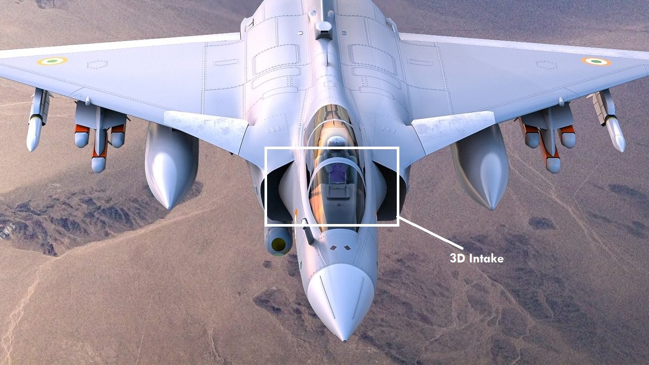

TEDBF with canards, DSI, ergonomic nose, etc. It is clearly feeding on the technologies of MWF and AMCA.
IAF should seriously consider the idea of its air force variant ORCA and stop this nonsense of MMRCA.

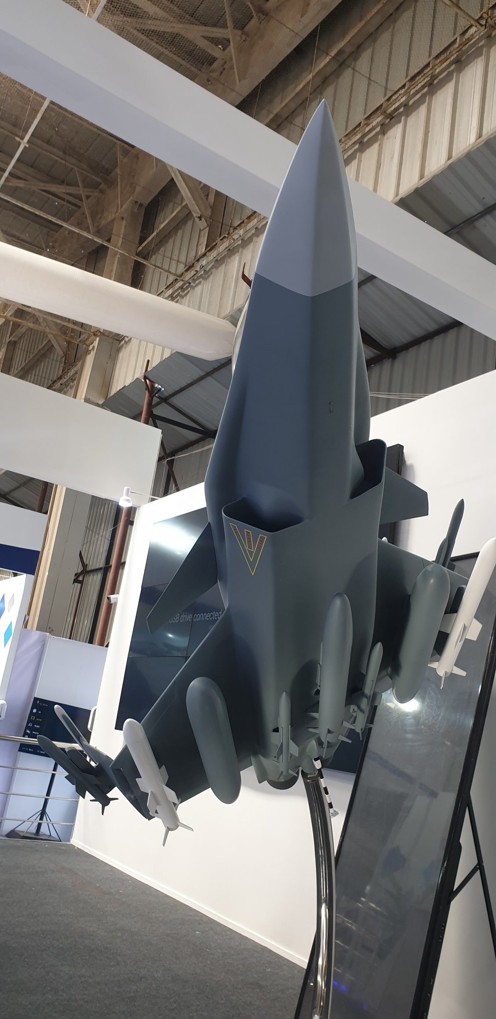

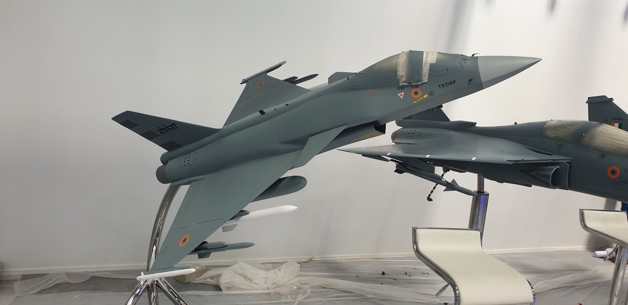

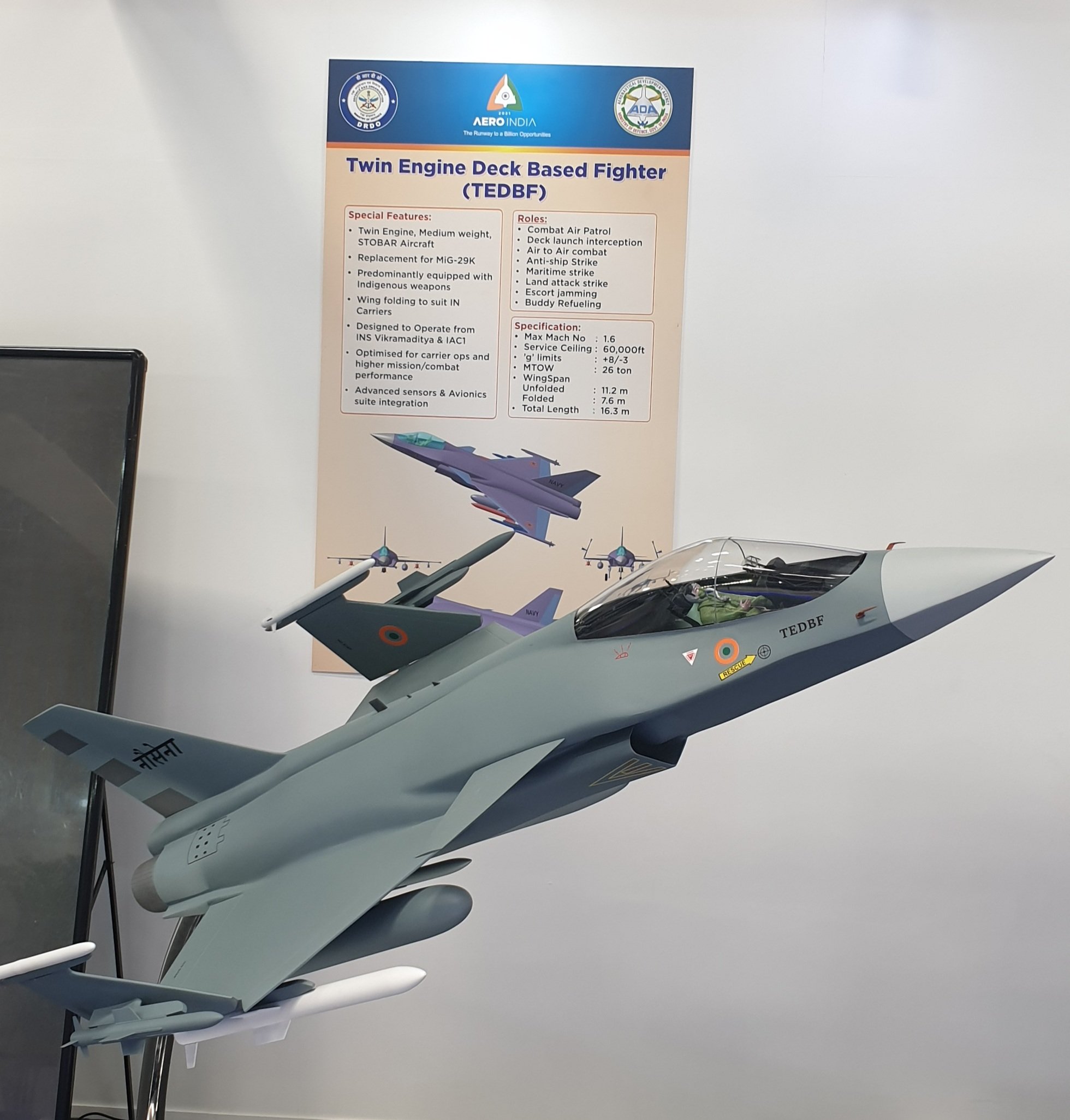

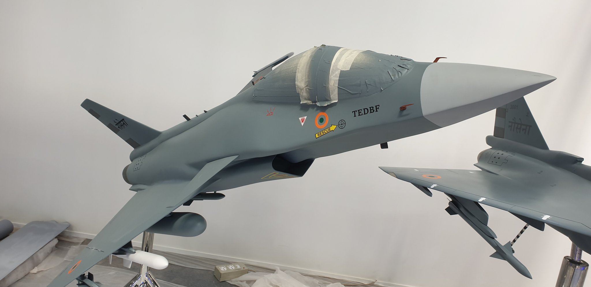

The delta wing canard configuration model of TED-BF from Aero India 2021
https://twitter.com/ReviewVayu/status/1 ... 7732033540

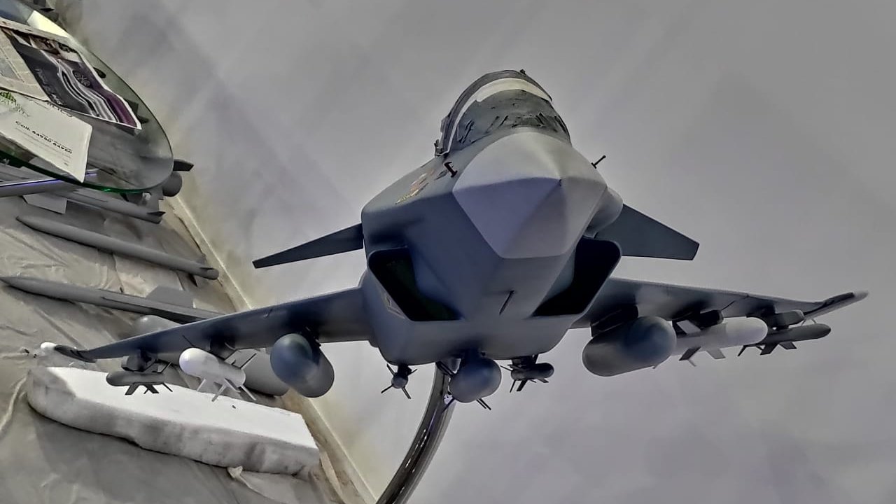

Semi stealth design which is hybrid of AMCA and MWF.
The saddle tanks in HAL rendering of TEDBF seems to be in inbuilt and I will give internal fuel at 7T.
Clean take of weight of 20t and external Payload of 6 t with MTOW of 26T. 11 external hardpoints are there.

My gosh the TEDBF with canards and delta wing is stunning! Strangely no IRST and no probe seen on the model, which could mean AMCA style retractable probe.
Wonder what the other configuration with trapezoidal wings and stabilators will look like..I doubt it'll be this beautiful though..

More like a desi Typhoon

Kartik wrote:My gosh the TEDBF with canards and delta wing is stunning! Strangely no IRST and no probe seen on the model, which could mean AMCA style retractable probe.
I think ADA/HAL might be in the process of developing our own EOTS
Still preliminary design I suppose. Lots of details will get fleshed out as it moves forward.
More beautiful than the Katrina :mrgreen:

After staring at these models, i now feel that the Stealth is from the forward look only. The multiple lines on TED-BF in the configuration might not be so stealthy when being viewed from a AWACS.
I was wondering if some learned moulana can throw some light on how much engineering effort it would need to move the wings higher WRT to the body. I feel that with the wings moved higher we will not need to have these multiple lines and we can accommodate the canards and wings in a single line with air intakes below the line

If beauty alone can kill! She is stunning. I imagined it would be a little more conventional than this (based on past renderings). I see this as is a sign of our maturity and confidence.
The rear fuselage is more conventional, less risk with adopting MWF design, which is a smart move. Perhaps chevron nozzles can be adopted at a later stage. USN did a study primarily for noise reduction on deck (before 2015) and simple chevron nozzles had a 3dB noise reduction which was considered quite significant.
https://navysustainability.dodlive.mil/ ... evrons.pdf
I think IRST, probe retraction, APU inlet, etc... are not shown here probably as they are either evolving or not included as it is only a display model? Though the wing folding lines are visible.
This wing appears to be a pure delta. For the gurus, are there any advantages of having both the canard and cranked wing of the LCA/ MWF?
Radar signature may be one reason for not having it and perhaps the crank is superfluous when a canard is present. Like the crank though; amongst other things, allows one way for a larger wing area if desired.

The third pic looks a bit boxy, probably they are CFT ? From other angles it looks cool.
Just a comment, if the french can build a beauty Rafael in 1986, I think we can still do a better job in 2021.

Latest TEDBF pic from Livefist
Twitter link

Here is the specification.
Service ceiling : 60K feet - 18 KM.
It is longer and wider than Rafale but with folded wing it can operate from both Vikaramaditya and IAC-1.

nash wrote:Here is the specification.
Thanks for posting this. Any chance a higher res image might be available? Can see front views of the second configuration being studied as well.
So the TEDBF is +8G/-3G. This is due to the wing folding mechanism that basically breaks the spars into 2 sections that are hinged. For an IAF version based on this, it should be an all out +9G/-3G fighter since it won't need a wing folding mechanism and will have a lighter airframe structure and landing gear.
