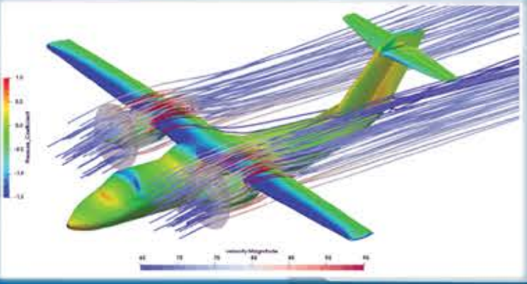

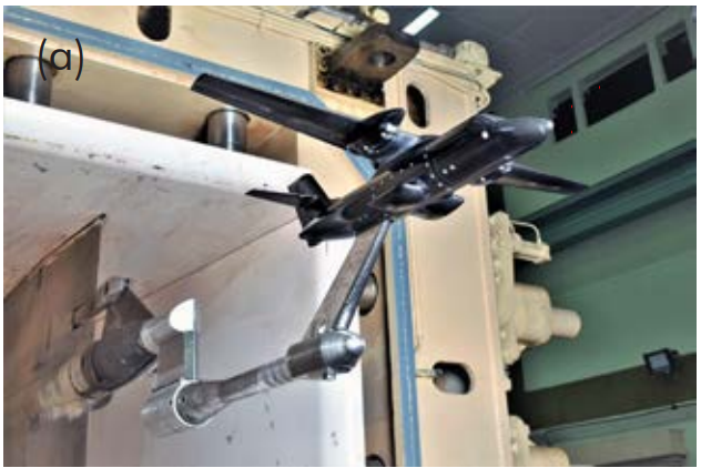

Re: Indian Military Aviation - 06 March 2019
The Saras Mk-2 program has been reviewed at regular
intervals by the Project Monitoring
Committee including participation
form stake holders. During the year,
considerable progress was achieved
in the design of Saras Mk-2 (19
seater aircraft) towards optimization
of configuration. The drag reduction
and aerodynamic efficiency, reduction in Operating Empty Weight
(OEW) and increase in useful load,
improvements in Flight Control
System (FCS) and general systems
were addressed. Significant progress was made with preliminary
layouts, preliminary configuration
documentation, CFD analysis, wind
tunnel testing, configuration design,
performance estimation, stability
and controllability and critical load
cases for structural design has been
achieved for Saras Mk-2 aircraft.
Actually not. If you look carefully, it looks like they are reusing the entire fuselage, LGs and empennage. The horizontal tail has been moved lower from the classic T, bot both the VT and HT look the same. If you have followed their progression with the rudder, the horn-balanced rudder makes sense. Wonder why no winglets.
I have a feeling that they are going to have more fuel carrying capacity. That MLG fairing is huge. I think they are retaining the whole fuel tank from there. The new wingbox should add extra capacity. The wings will be new for sure. But the tender is already out for studying and implementing the nacelles for the engines. This will be relatively straight-forward given that PT6A-67A in tractor formation is a very well understood. In the pusher format the oil cooler gave NAL severe headaches. They had to limit the engine's output and hence the MTOW severely. It took them years to solve the problem. Another problem that they had was the operations of the flaps. Hopefully, they can solve this one easily too.
I really hope that NAL and HAL work more closely on this than before. HAL can really help with optimized and certified subsystems from the 228. I hope HAL sees the potential of Saras. Currently, it doesn't see the need given its 228 offering. But, Saras has great growth potential which 228 doesn't.
This could HAL's "Bandeirante moment". Is it is coincidence the Embraer moved to Bandeirante after the Vector? It will be chance for HAL to come out of the shadows of Dornier and put some distance between itself and (say) the Tatas who can build to print.

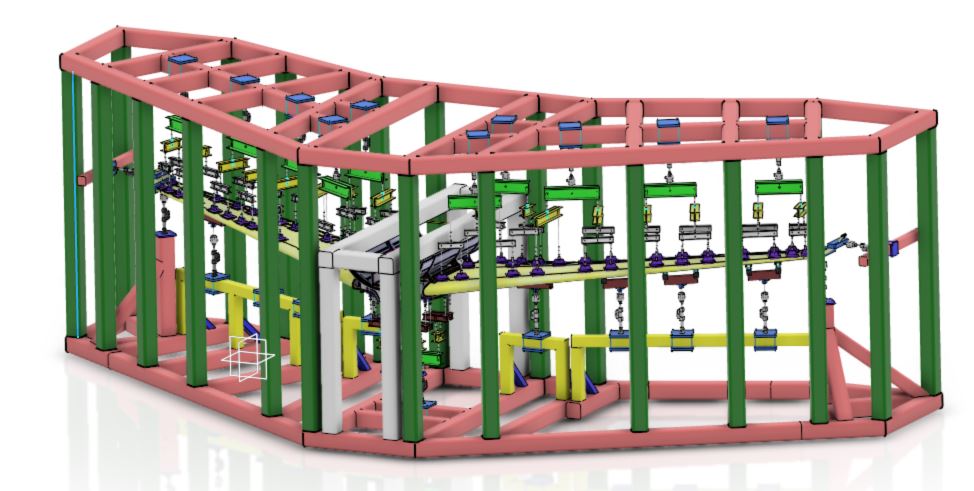

https://www.nal.res.in/medias/content_i ... rframe.pdf
Tender document for design of Saras mk2 tractor config. Good amount of details regarding work packages which have been split into 4 parts.
Did not see this posted in this thread or Transport thread. Bid open date was 29th Oct.
1. Detail design & Engineering for Fuselage structure.
2. Detail design & Engineering for Wing structure.
3. Detail design & Engineering for Vertical and Horizontal Fin structure.
4. Detail design & Engineering for Control Surfaces structure.

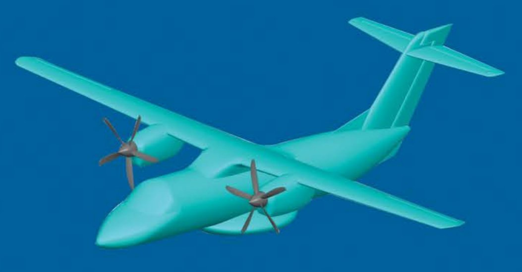

More details: Mk2 will carry much more fuel (1832 kgs from current 1568 kgs). With a much larger wing (31.2m^2 from current 25.7^2) and much higher aspect ratio of 10, its ferry range will improve significantly to 2400 kms (with 45 mins reserve). For brochure numbers: 2700 kms.
It will cruise at 400 kmph with a top speed of 550 kmph 25000'. It's service ceiling will be 30,000' although it can climb to 35,000'. Expect endurance of well over 10 hours. Max. rate of climb > 2160fps
Typically, that does not require big changes to the airframe. But it places restrictions on the envelop and a lot of time in qualifications.

Indranil wrote:More details: Mk2 will carry much more fuel (1832 kgs from current 1568 kgs). With a much larger wing (31.2m^2 from current 25.7^2) and much higher aspect ratio of 10, its ferry range will improve significantly to 2400 kms (with 45 mins reserve). For brochure numbers: 2700 kms.
This forum needs a button to allow one to like posts. :) Thank you for these details!
The increased fuel, wing area and aspect ratio will all improve the range which in turn will mean a much more useful and usable turboprop. This is what the Saras Mk1 should have been in the first place. The question though will remain on it's viability when HAL will have to manufacture and support the type in both military and civil variants.
Without getting too deep into the comparison with the C-295, what will be the business case for the full scale development of the Saras Mk2 when the the C-295 is likely to be built in India by TASL with a guaranteed order of at least 56? I'm afraid that with NAL looking for another firm to take on the full scale design and development, this may just be restricted to a paper design.
May I also say that the Saras Mk2 is quite a looker. The proportions are just right. Saras Mk1 looked stubby to me.
Currently, the plan is for production at HAL. But I hear murmurs of pushback from HAL owing to competition to its "own" Do228.
If I were HAL, I would slowly wean off of the 228 production line and ramp up on Saras. Dornier has placed more faith in TASL. TASL builds almost all of the airframe of the 228NG and these are assembled in Germany. If I were a civilian operator, why wouldn't I buy directly from Dornier? But, that's just me. On the other hand HAL can become the sole manufacturer of Saras.
I would also be super excited if a private player comes forward for serial production of Saras. That will foster competition and remove the chance of any stepmotherly treatment. There is place for both the Do-228 and Saras.

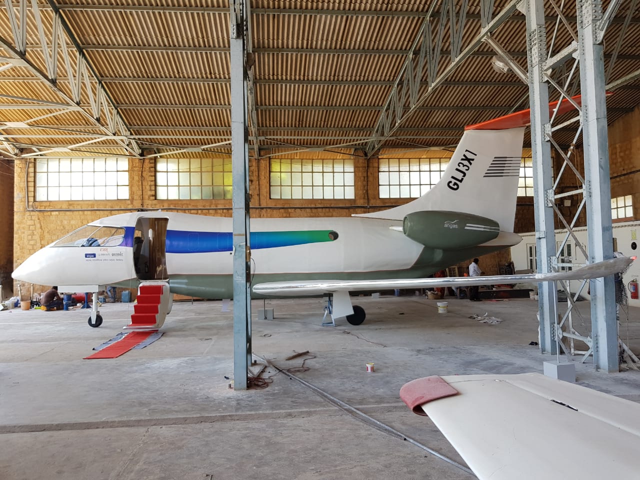

Vayu Aerospace Review
@ReviewVayu
15m
HAL, Naini & Genser Aerospace/Angas sign MoU to cooperate in Design/Development of the RAJAS platform
Gensers been spearheading the design/dev of a Light Business Jet & showcased its progress at AI’21
Aircraft is named Genjet GLJ3X1 RAJAS..rhyming with TEJAS, SARAS, TAPAS
@ReviewVayu
13m
2/3
RAJAS is also envisioned in different roles/versions; RAJAS-Kuleen for extended range & RAJAS–Rakshan for Special Mission Roles/Light Weight Special Cargo, VIP, Aerial Photography/Recce, Maritime/Overland SAR etc.
A full-scale Mock up was built earlier to get physical feel.
@ReviewVayu
13m
3/3
Genser's been working since 2015 on dev of a 2 pilot +7 seat Light Business Jet, complying to FAR 23, 5T all up weight, twin turbofan engine of 9KN each, max cruise speed 0.79 Mach, range 2250 NM.
Pix of Test Structure designed for static/fatigue testing of RAJAS wing.
