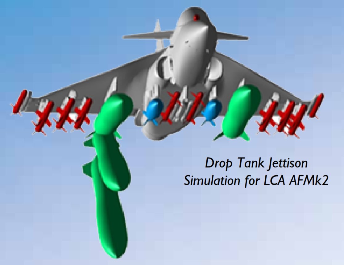

Simultaneous 8 BVR with 3 drop tanks means either the 2 chin stations are capable of carrying BVR AAM or 2 wingtip stations can also carry BVR.
It will be interesting to see what is the 8 BVR with 3 drop tanks configuration.
Interesting. Missiles on the chin stations might stick out in front of the air intake and possibly interfere with the airflow. So it could be the wingtip stations then. There were also pictures floating around showing AAM's on a dual pylon rack on the centerline. So 8 BVRAAM's + 2 CCM's + 2 Drop tanks would also be possible and more practical.sankum wrote:Simultaneous 8 BVR with 3 drop tanks means either the 2 chin stations are capable of carrying BVR AAM or 2 wingtip stations can also carry BVR.
Of course you could always skip the drop tanks altogether, fit dual racks everywhere possible and carry 12 BVR + 2 CCM
Two chin mounts capable of 1000lb bombs.
The two BVR on twin rack centre fuselage station seem to be rail launched rather than ejector.
Looks that way but the danger of missile exhaust getting ingested into the air intakes is too high. This may be just one of the configurations they are considering and it may or may not be supported in the final product. But it shows they are trying to make it as flexible as possible.
In any case these are configurations you will rarely see being used in service. The standard air-to-air fit will remain 4+2 or 6+2 at the most. I have yet to see a single photo of even a Rafale carrying more than 6 AAM's (even in French service).
