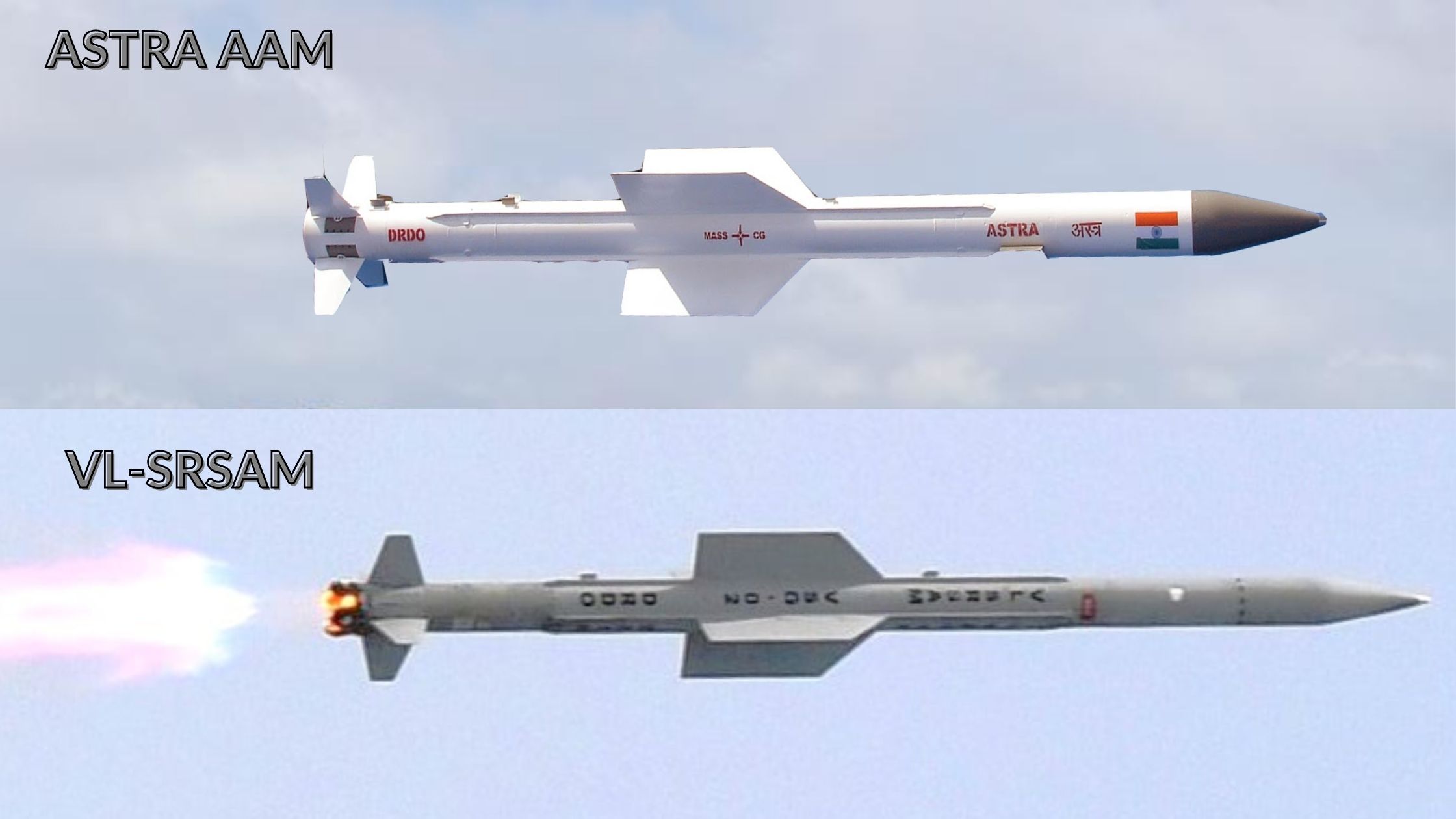

Looks very close to astra mk1. Looks like they are using Astra missile for family of missiles.
https://twitter.com/DefenceDecode/statu ... 2864796673
VL-SRSAM is actually longer than Astra. Astra 2?
If it has dual pulse, then it is for practical purpose Astra 2. Don't know if there is a requirement for dual pulse. Barak8 has it, Mica Naval is planned to have dual pulse, so it will not be out of ordinary..

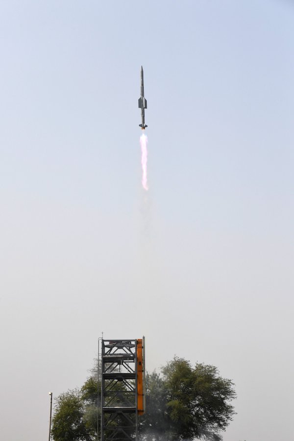

https://pib.gov.in/PressReleasePage.aspx?PRID=1700039
Defence Research & Development Organisation (DRDO) conducted two successful launches of Vertical Launch Short Range Surface to Air Missile (VL-SRSAM).
The launches were carried out today from a static vertical launcher from Integrated Test Range (ITR), Chandipur off the coast of Odisha. Indigenously designed and developed by DRDO for Indian Navy, VL-SRSAM is meant for neutralizing various aerial threats at close ranges including sea-skimming targets. The current launches were carried out for demonstration of vertical launch capability as part of its maiden launch campaign. On both occasions, the missiles intercepted the simulated targets with pinpoint accuracy. The missiles were tested for minimum and maximum range. VL-SRSAM with Weapon Control System (WCS) were deployed during the trials.
The launches were monitored by senior scientists from various DRDO labs involved in the design and development of the system such as DRDL, RCI, Hyderabad and R&D Engineers, Pune.
During the test launches, flight path and vehicle performance parameters were monitored using flight data, captured by various Range instruments such as Radar, EOTS and Telemetry systems deployed by ITR, Chandipur.
The present trials have proved the effectiveness of the weapon system and few more trials will be conducted shortly before deployment on Indian Naval ships. Once deployed, the VL-SRSAM system will prove to be a force multiplier for the Indian Navy.
Raksha Mantri Shri Rajnath Singh congratulated DRDO on the successful trials. Dr G Satheesh Reddy, Secretary DD R&D & Chairman DRDO congratulated the teams involved in successful flight test of VL-SRSAM Missile System.
https://static.pib.gov.in/WriteReadData ... 3)2L1S.jpg (3712x5568)

nam wrote: VL-SRSAM is actually longer than Astra. Astra 2?
This is older Astra MK1. The newer Mk1 is very close to this SR SAM.

Engine of VL Astra seems to be quite different from AAM version. Looks like some kind of vane like structure.
Found it:
Maybe because a booster is added to the missile for VL applications.

The extra vanes may be needed for vertical launch stability when compared to the AAM.
A vertically launched short-medium ranged naval SAM isn't going to be lofting for a majority of its intercepts. So it needs to be able to execute a very rapid pitch over maneuver to align itself to the most optimal intercept trajectory, as fast as possible. Barring any other design solution (like ACMs) this means a TVC system.
On the ESSM, for example, they put a jet vane system that aligns the missile to the right trajectory soon after VL launch, and then detaches to get you the best of both worlds (you get the initial quick snap maneuver, and you don't degrade Isp for the longer duration of flight to the intercept). Perhaps VL ASTRA is using something similar.
You can see the POM here -
https://youtu.be/Mw5f0_SQeuc?t=64
At roughly 1:11 mark you can see the vane control system being let go.
Pratyush wrote:Maybe because a booster is added to the missile for VL applications.
Booster is not the most optimal approach when you need a system that has the job of being the inner defense against sea skimming targets. Think trying to intercept a Mach 3+ sea skimmer at minimal range (last shot scenarios). Vertically launching, ditching the booster, and igniting the SRM is going to take up time and altitude. Adding a booster to a 7" or sub 7" missile (like the Israeli options mentioned earlier) to try to convert it into a medium-long-range SAM is also not optimal for a Naval SAM application. As you begin to approach BLOS (to ship radar) targets, you really want to be able to provide a 10-13" guidance section given that your ability to provide updates may be minimal against many target types. High-Low-Low and even Low-Low-Low target trajectories need to be accounted for. Med.-Long range Naval SAM's are also area-defense weapons so they need to account for different trajectories and targets that are guided towards other vessels and not just those incoming towards the launch vessel. These are less important to a short ranged ground based SAM system (like a Spyder/NASAMS etc). This is why there are generally different SAM's systems, or at least missiles, for different altitudes and intercept ranges. Longer ranged systems are larger, have more room for electronics and a larger diameter guidance section compared to the point defense or the short-med. ranged systems. As distances get large and you generally need a more capable seeker to maintain a desired probability of intercept/kill.

You cannot compare the two missiles this doesn't look like straight up Astra mk1 being converted for air defense similar to how mica was. So expect the range should be better than vl mica as it would be better optimized for that role.
John wrote: You cannot compare the two missiles this doesn't look like straight up Astra mk1 being converted for air defense similar to how mica was. So expect the range should be better than vl mica as it would be better optimized for that role.
It is not just Mica, even the Debry and Aim120 don't reach 40KM in their single pulse land fired mode. And they are not even vertically launched.
Given all the TVC disco VL-SRSAM is suppose to do, there is no way a standard Astra amount of propellant can give you a range of 40KM at such lower altitude.
It still retains the Astra's large central fins compared to Akash NG. So the drag has not been reduced either. Hence my personal view is that it is a dual pulse motor. aka Astra 2(or Astra IR with TC Vanes) They even did a rail launch, instead of using a container! No folded fins either. DRDO was in a hurry to test this missile.
Let's see how Astra 2 looks like.
