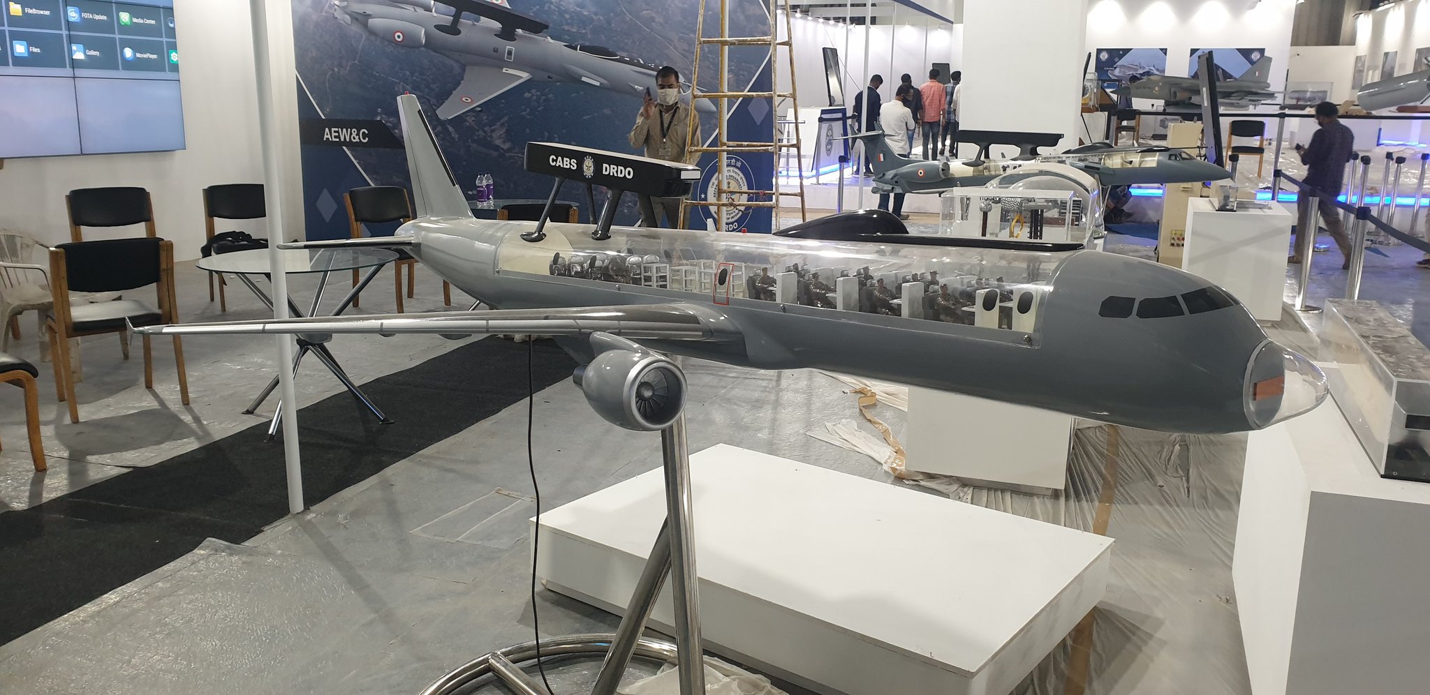

No refueling probe. A radar similar to nose radar can be put on tail also.
arvin
Posts: 687
Joined: 17 Aug 2016 21:26
Re: Airborne Early Warning & Control: News & Discussion
Post by arvin »
So the nose seems like holding an AESA going by the shape of it. If true and if its X band, I am salivating at the range it will be able to lock on given the power the platform can provide. I hope we develop an ultra long range air to air solution to take advantage of this.

May be it just me or is that antenna more "fatter" than Netra. Just wondering if there is a radar panel at the back of the antenna as well.
In all probability, it is going to be GaN based, so I expect it to be more "slim". You could technically put a antenna at the back and space it in a way(or electronically beam control) to ignore the reflections from the tail. Even if they get 100-150KM rear coverage, that would be quite good.

Is the model to scale? The antenna on top seems a bit small , more like the same one on Emb-145. Would more modules increase sensitivity and range? The Australian Wedgetail seems much bigger, but that seems to be a different design, so not a direct comparison.

putnanja wrote:Is the model to scale? The antenna on top seems a bit small , more like the same one on Emb-145. Would more modules increase sensitivity and range? The Australian Wedgetail seems much bigger, but that seems to be a different design, so not a direct comparison.
Yes, I had hoped for a much bigger radar than the one displayed, but looks like they decided to take a lower risk approach. Power generation etc is a non trivial issue. Its a bigger radar though. I hope with more of these systems, we can reserve our Phalcons for the PRC threat, and also keep the AWACS India project ongoing.

Model of the DRDO’s ISTAR airborne battlefield and ground surveillance aircraft platform drops at #AeroIndia2021.

A320 weather radar. Doesnt look like there is too much space in the nose for a big honking radar. At most a meter and half wide.
Another picture with a human for scale.

Agree 100% on this. We have barely come out of time consuming elaborate chai biskoot sessions spanning several years just to decide the type of platform jumping from ERJ145 to A330 to C295 and finally settling on Air-India's A320. Needless to re-start the cycle all over again.
What is of interest is the under belly pod which would be doing usual stuff like SAR, ISAR, GMTI etc. DRDO should focus only on the pod and make it portable like SeaVue, SeaSpray etc maybe call it SeaSmart (Sagar Shaana ?? ) so that it is adaptable not only on A320, but also on UAV like Rustom 2. Exactly same approach as followed for the Radar on top which could be ported from ERJ145 to A320.
Thanks for the pics.
The two antennas in bottom, localizer and glidescope for ILS which is used only for landing purposes. Prime real estate in nose used only for maybe 5% of flight duration. Dont know, if they can be shifted anywhere else or its removal can be compensated by other sensors.

Folks, I think you're unnecessarily focussing on the volumes of old nose whereas the model pics clearly indicate that these a320s will get a 'nose job' done too. Though the model may not be close to the real thing, it is quite obvious that some kind of nose reshaping is being done.

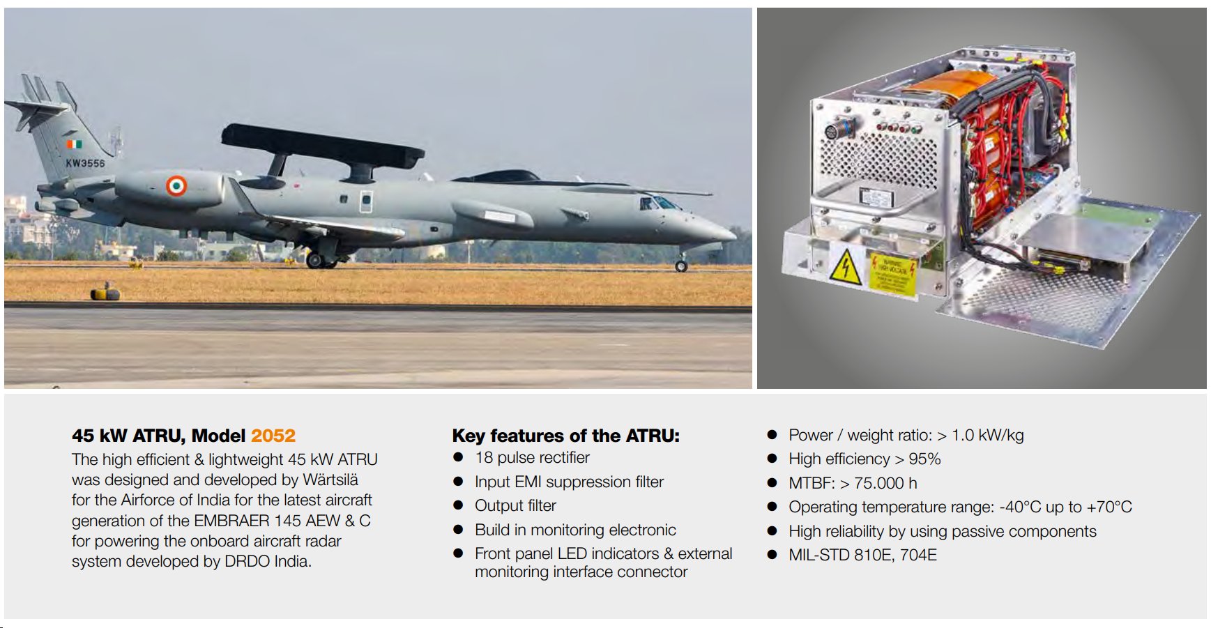

https://twitter.com/strategic_front/sta ... 01537?s=20 ---> The Auto-Transformer Rectifier Unit (ATRU) is for high-voltage AC/DC power conversion on an aircraft. They are used for running radars and associated electronics. The ATRU on the NETRA AEW&CS was developed by Wärtsilä & made in Wärtsilä's production plant in Khopoli, Maharashtra.

sudeepj wrote:A320 weather radar. Doesnt look like there is too much space in the nose for a big honking radar. At most a meter and half wide.
1.5 meters is not small even for an aew. The mkis bars is extremely powerful and no more than a meter. 50% more is huge.

^^^The A319/320 will most likely have a combined SAR and weather avoidance radar. The MKI Bars variants are most likely a decade behind developments to be fielded by LDRE.
The front radar is only going to be used in turns. Rest of the time the radar will be broadside to the area being monitored. Hopefully, the AESA means the radar can just track the already detected targets in the few minutes it takes to make the turn.

Cain Marko wrote: 1.5 meters is not small even for an aew. The mkis bars is extremely powerful and no more than a meter. 50% more is huge.
I'm just wondering if the front radar will be x band fcr for self protection...
