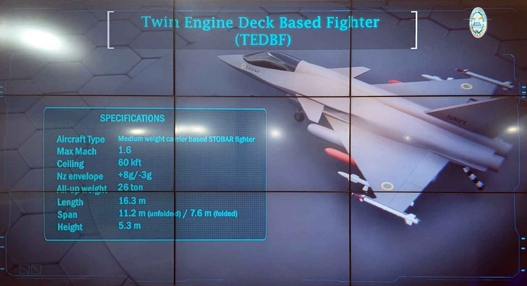

Re: Twin Engine Deck Based Fighter (TEDBF): News & Discussion
I wonder what the combat load would be, when deployed from land, or even CATOBAR ships.
Posts: 9208
26 ton AUW? I'm guessing that is a typo and it is actually the MTOW. It would approach the MKI's weight otherwise.

nachiket wrote:26 ton AUW? I'm guessing that is a typo and it is actually the MTOW. It would approach the MKI's weight otherwise.
Page 1 of this thread also states 26 ton AUW. Let me look for an info chart...
Posts: 23143
Picture courtesy of https://www.defenceview.in/ , but it is from ADA. So official...
Posts: 9208
^^ Yeah here it says MTOW which makes more sense. Perhaps they use MTOW and AUW interchangeably.
