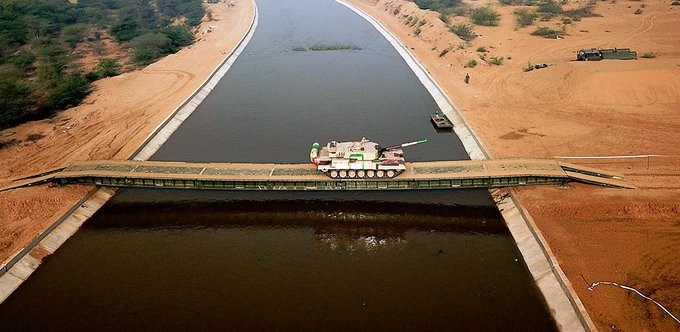

Arjun MBT fording capabilities:Manish_P wrote:^ Is the thinking along the lines that the Pakis will blow up those cross canal bridges if the Indian armor overwhelms their front ?
How deep are these canals? Enough to prevent Arjuns from fording?
- Fording 1.4 m
- Fording (with preparation) ~ 2.2 m
In reply … an old post of mine
DRDO MLC-70 class (suitable for Arjun MBT Mk.2) bridges:
- SSBS 5m
- SSBS 10m
- BLT-T-72 22m
- Arjun BLT 24m
- Modular Bridge 14m-46m
- SARVATRA 5m-75m (15m plus SSBS 5m & 10m compatible)

https://twitter.com/JaidevJamwal/status ... 78724?s=20 ---> But Arjun is too heavy to cross canals on Pakistani side.
Maybe the thinking is that Paki abdools will blow up the bridges over the canals.. a la scorched earth, the moment they hear IA rumbling on the horizon.
Then it will be left to IA engineering corps to lay bridges over the canals.
Can those bailey bridges support Arjun weight?
Incidentally what is the typical depth of these canals? Fording possible?
Deep fording is possible with lots of preparation. A bridge brings across the tank in a ready to fight state.
Deep fording needs preparation on both sides before tank becomes fight ready.
Each bridge on both side is rigged with plenty of explosives and manned by detachment of the corps of Engineers (from both armies) to delay the sudden rush of enemy forces so yes you are right they could be blown but due to anything so romantic such as russian scorched earth policy but for carefully planned delayed at each ring of concentric circle is breached.
