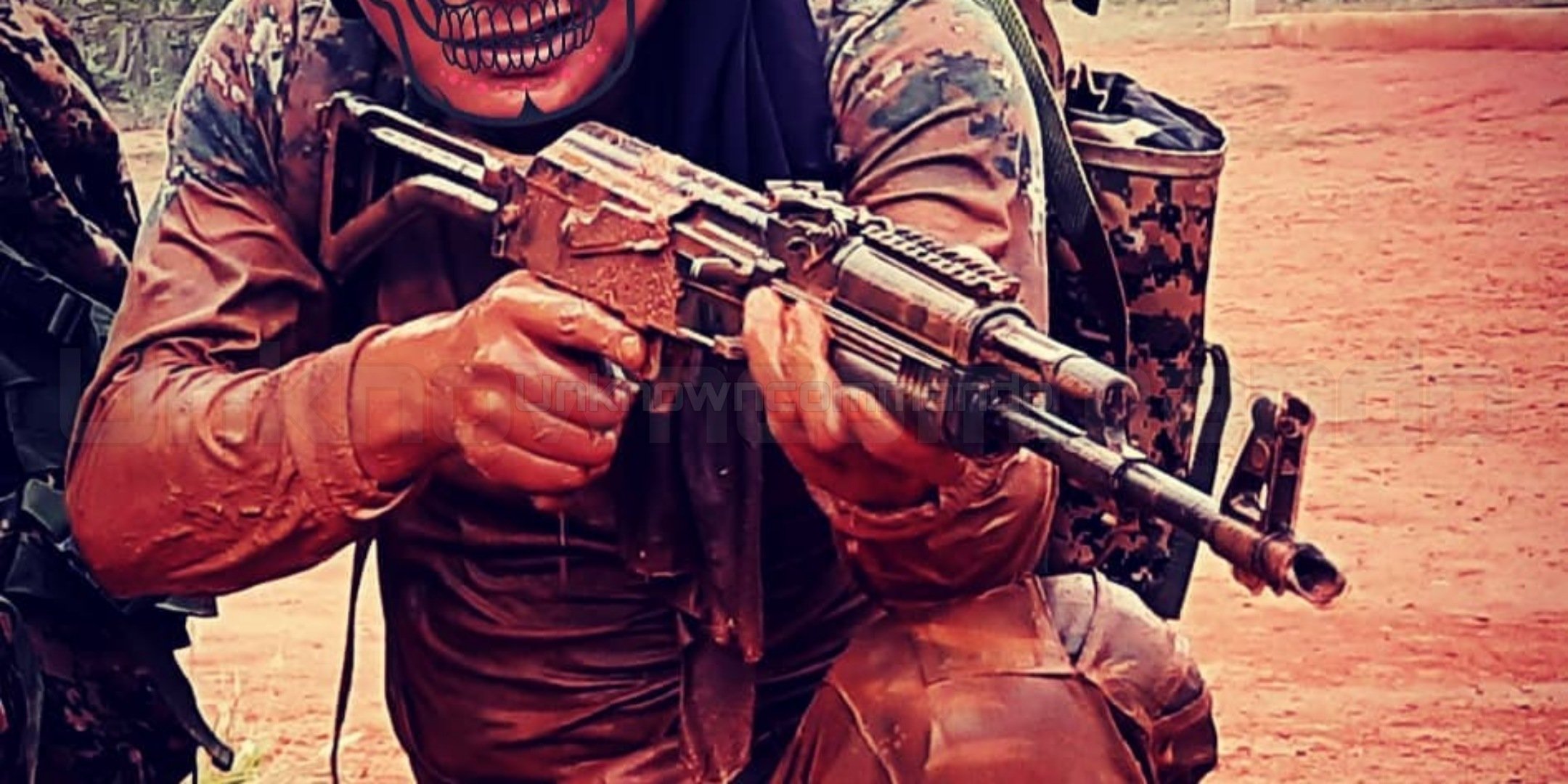

Milled receiver Insas with pic rails and modern furniture seen somewhere in service. OFB calls it Indian Assault Rifle or IAR.

Is this suit airtight? Jacket seems to be open at bottom.
