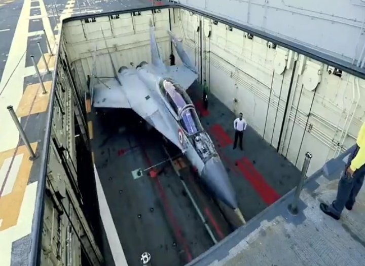

The F-18 folded wingspan vs Rafale's open wingspan doesn't seem to differ by very much (1.5 m), while the F-18's open wingspan is about 3 m wider than the Rafale's. Length too is significantly larger on the F-18, and while it might allow for some overhang off the starboard hull from the flight deck, it would very likely still take up extra real estate.
Sortie rate will be determined partly by how quickly can the aircraft be moved from the hanger, through the elevators and then on the flight deck, and how easy and quickly can weapons be loaded onto the hardpoints. While the F-18 MIGHT fit through the elevators if set at a skewed angle (i suspect the length is the big concern here), it'll certainly eat up a LOT of time in maneuvering the F-18 into and from the elevators. Plus, fewer aircraft with unfolded wings on the flight deck can also impact flight readiness.
Only real questions here will be (1) Can the Rafale fit through the Vikrant lifts, and how much will the solution found to shove off the 1-1.3 m required for clearing the 10m wide lift adversely affect sortie rate, and (2) how much do we lose in terms of hanger space and maintainability and operational readiness with the non-folding wings?
If (1) is figured out, then (2) might be a non-issue given that the Rafale is 3 m less in length than the F-18, so could actually fit more in the hanger.

In INS VIKRANT there is turntable to turn aircraft in front of both lifts.
Question is what is width of hanger. In Google Earth it is estimated at 21m. It can very well be 22 or 23 m.
Italian carrier on which INS Vikrant is based has hanger of 134 m by 21m.

Rafale M cannot go in the hanger of INS Vikramaditya as it has two lifts of width 8.6 m and 9.6m as far as I remember.
It will only be used on INS Vikrant.

sankum wrote:INS Vikramaditya deck is more cramped than INS Vikrant and will carry less Rafales.
That's assuming they can even figure out a solution to getting the Rafales through the INS Vikramaditya's aircraft lifts. Else, Vikramaditya stays with its Mig-29Ks.
As a note to my pictures above, I might have wrongly measured the length of the Vikrant in pixels -- i measured from left to right, but the ship's length, if measured slightly obliquely, will be a little bit longer, in which case, the Rafales should've been scaled to be a little bit smaller than they appear now, maybe 95%-98% of the size here. It won't change the picture a lot.
And yes, for sortie rate, it will probably be better to keep the deck not too crowded, if the weapons fit and other combat op readiness can be done in the hanger before moving up to the flight deck. That however will probably still require wingtip armaments to be loaded on the top deck, else the aircraft cannot fit on the lifts.

https://twitter.com/VinodDX9/status/148 ... 40323?s=20 ---> MiG-29K in the elevator onboard INS Vikramaditya
