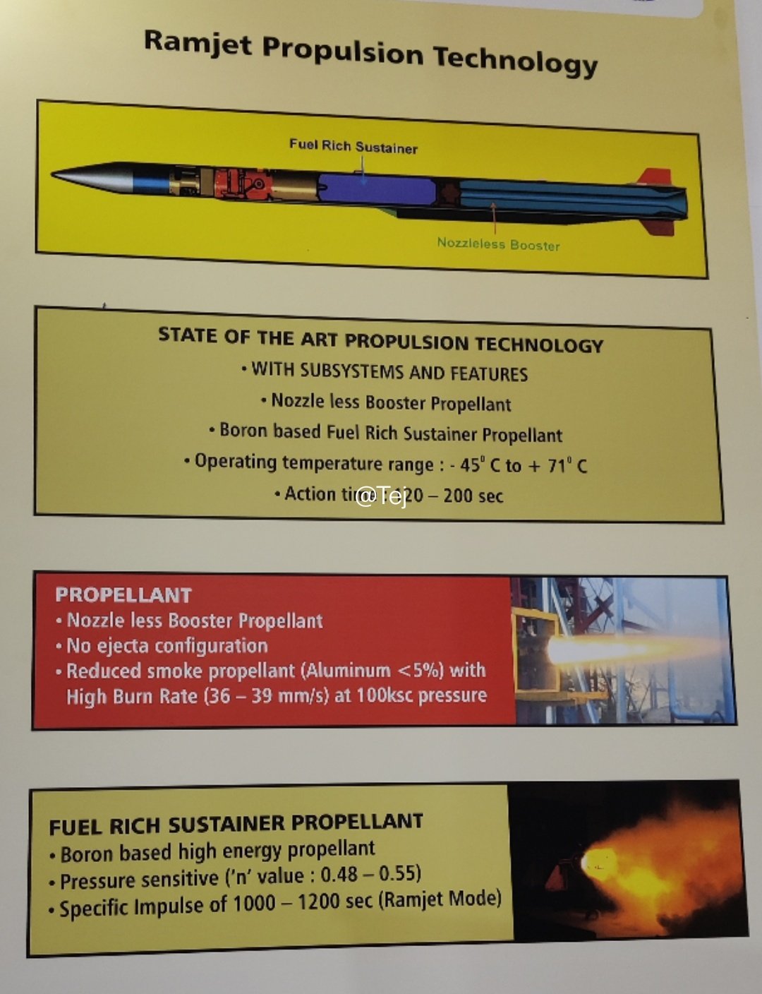

https://twitter.com/TejForTweet/status/ ... 38432?s=20 ---> Ramjet Propulsion #SFDR #BrahmosNG #AstraMk3

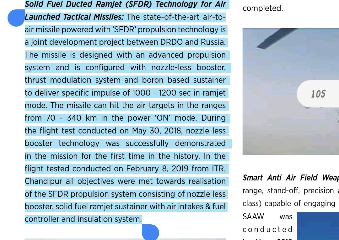

I can remember this very well. SFDR is one the most
♦ AESA seeker
♦ Regulator based air flow controller
♦ Two way data link
♦ 70-340km range (literally game changer)
♦ Ramjet sustainer for long range engagement
♦ Ballistic Trajectory

I can remember this very well. SFDR is one the mostamphibious(ambitious) projects till date.
♦ AESA seeker
