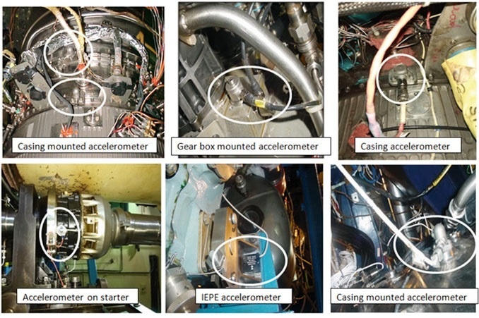

https://twitter.com/Varun55484761/statu ... 45570?s=20 ---> Vibration transducer installation on various components on GTRE Gas Turbine Engine. These sensors detects vibration signals from the components. Aerodynamic vibrations inside a jet engine should be minimum, vibrations will lead to crack in components & failure of the engine.

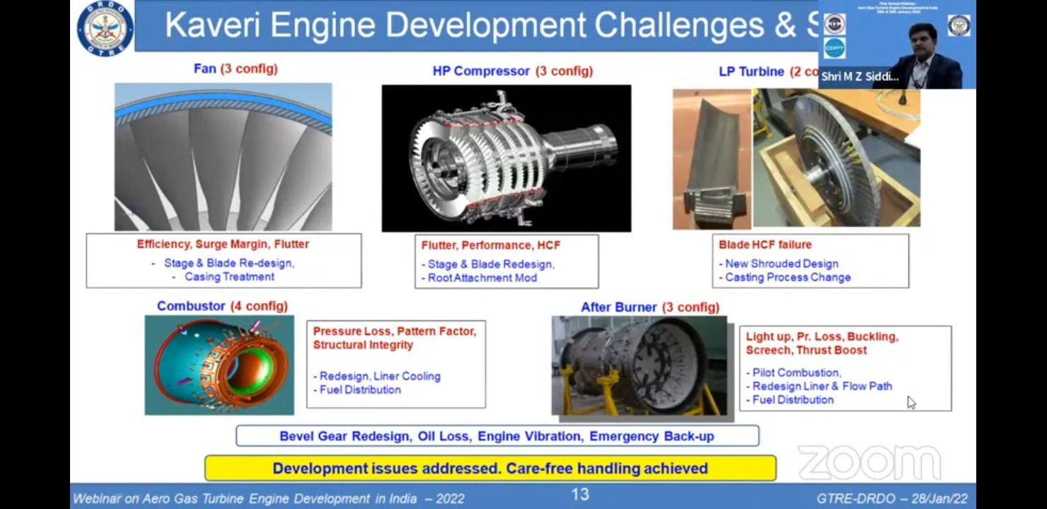

https://twitter.com/defence_in/status/1 ... 15618?s=20 ---> Presently all the R&D is focused on making a 98kN thrust Kaveri Turbofan whose LP/HP shafts needs to be optimized and synchronized with the gearbox.
https://twitter.com/defence_in/status/1 ... 86883?s=20 ---> The screech issue has been resolved as of now for the base Kaveri. But the engine has to be flight tested to know whether have completely solved it.

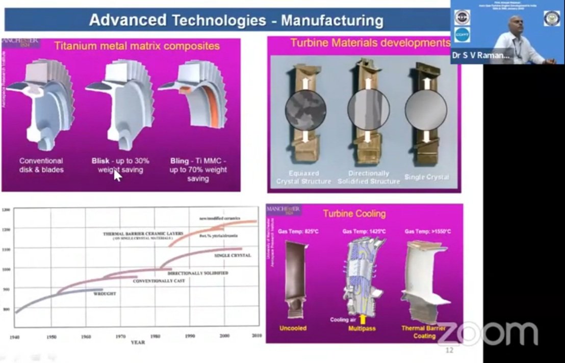

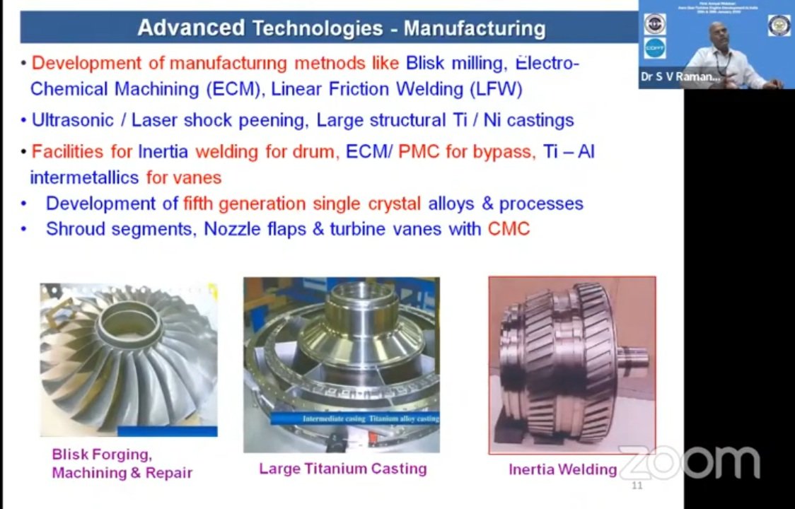

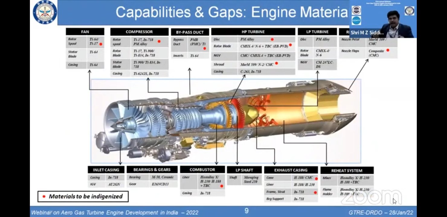

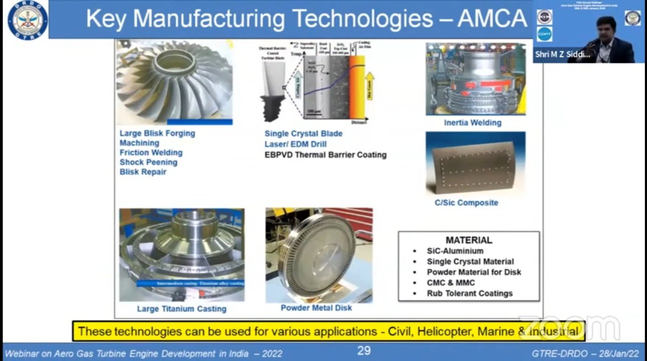

So, these interesting slides, particularly the “Capabilities and Gaps” one, has some interesting points that straightaway jumps out:
1) TBC seems to be a major bottleneck, and they haven’t mastered Electron Beam based PVD is it – but we have had multiple confirmations for the same in the Kaveri thread, from a few years back.
Are they trying to suggest that they have achieved 1425deg C TeT via multipass convectional cooling - and they need TBC to graduate to 1550deg C TeT, is it?
2) Mastering Powder Metallurgy (mostly for discs/spools) is a challenge, it seems – which is unfortunate, given the scale of technology that’s already been mastered, but nothing to scoff at, by any means.
Baffling of course is, it seems PM for LPT disc is done, but nor so for HPT discs – that shouldn’t have been a major leap wrt technology levels.
3) Saw CMC (SiC matrix reinforced by SiC fibers) mentioned for some of static components (Nozzle flaps, Turbine shrouds etc) as yet to be mastered.
However, we have had multiple news reports (again for multiple recent years) linked to this thread, that it has been achieved – maybe the mass-manufacturing technology is not mature yet.
Really baffling is if CMC for Nozzle petals are already achieved, how come not for th Nozzle flaps.
(for rotors, CMC is the cutting edge as it would provide ~100-150deg C TeT advantage straightway, apart from significant weight advantages – GE et all have already achieved and have productionized this)
4) Didn’t understand if they have already achieved Ti MMC based HPC or not – if yes, then it's like beyond-contemporary-cutting edge level

nash wrote:From last night, the Indian Defence @defence_in is lit with information from webinar. We may see some serious money finally coming to engine development.

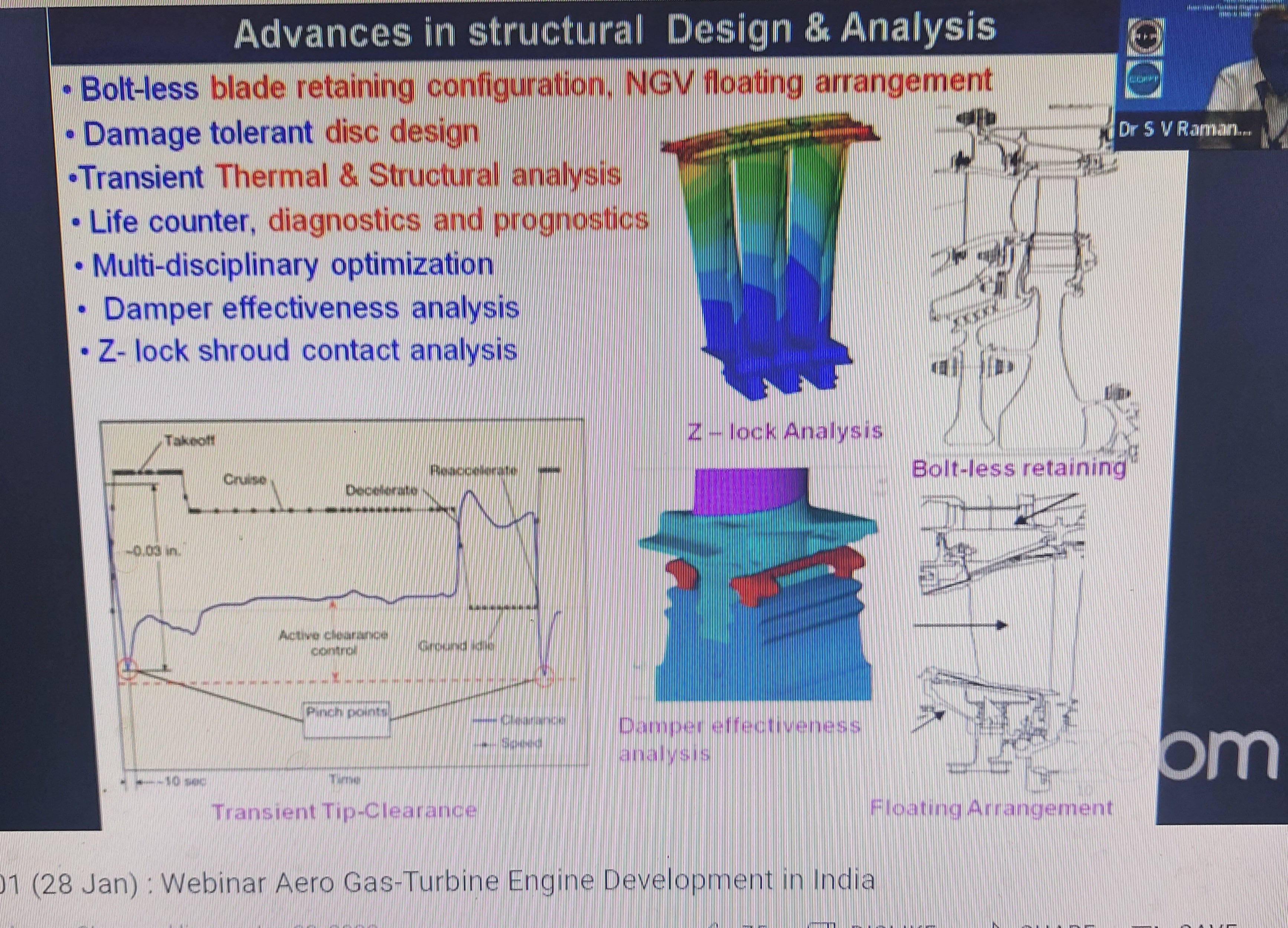

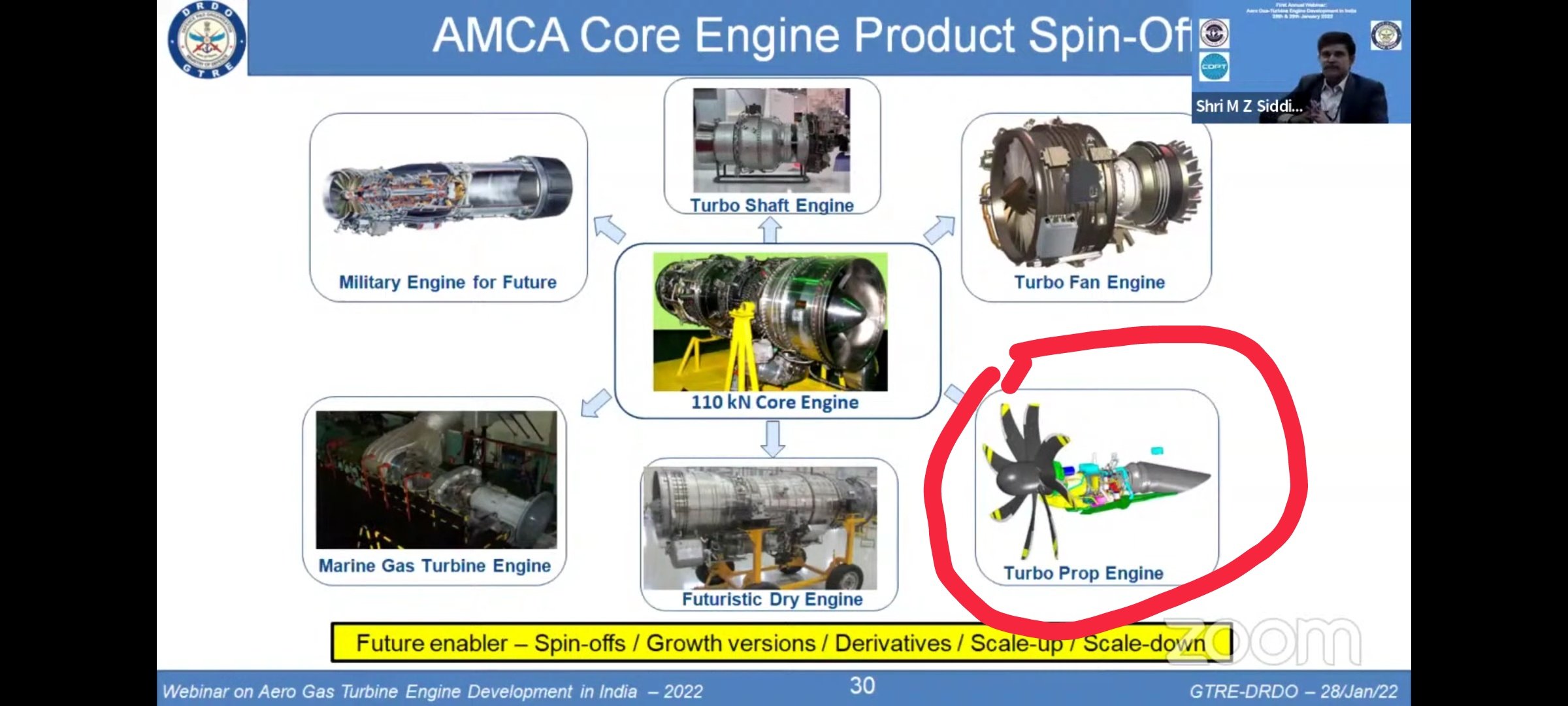

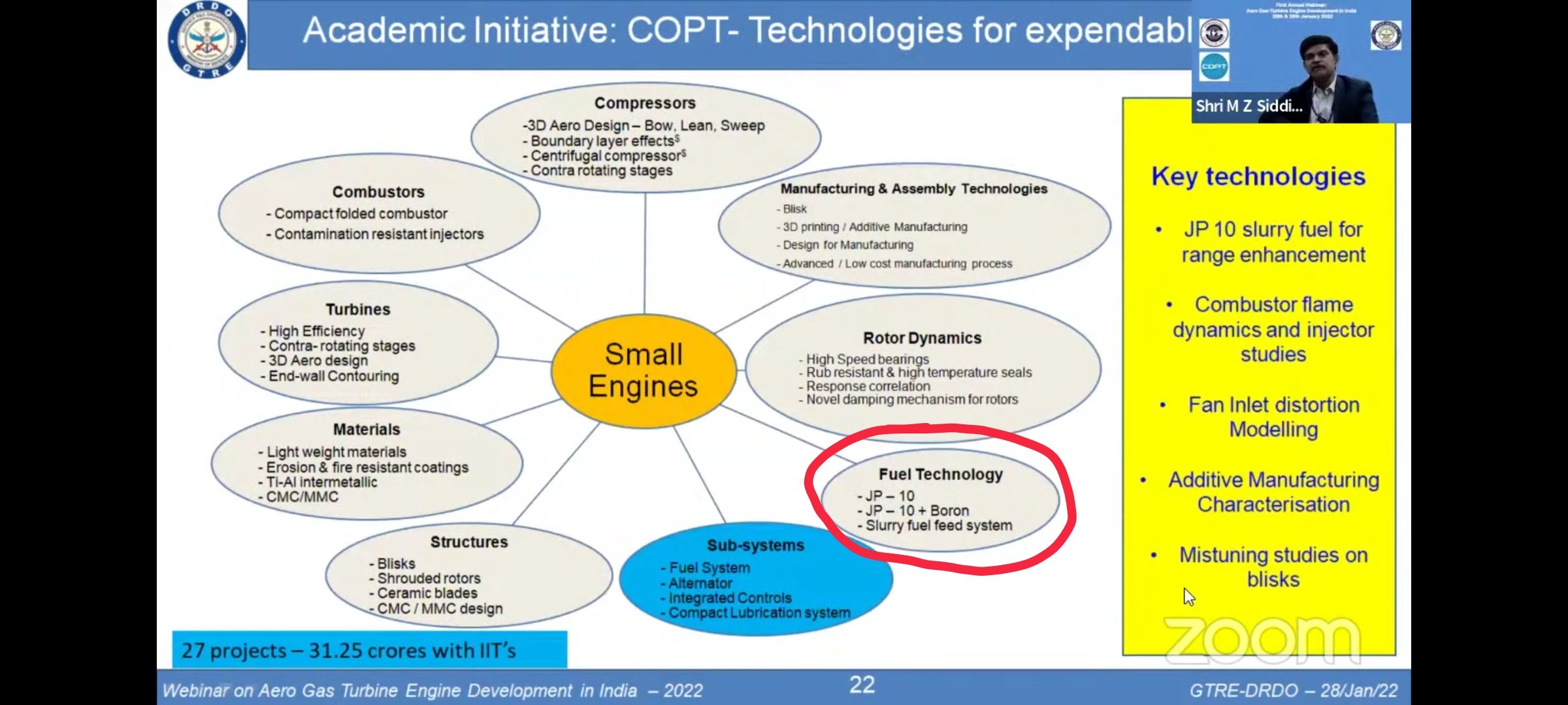

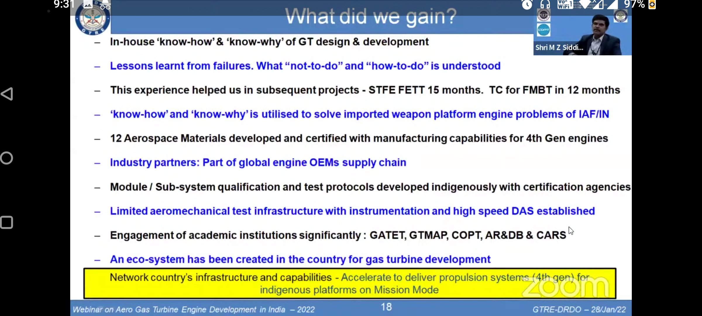

I saw that as well. sivab posted the first tweet. Posting the additional slides here...

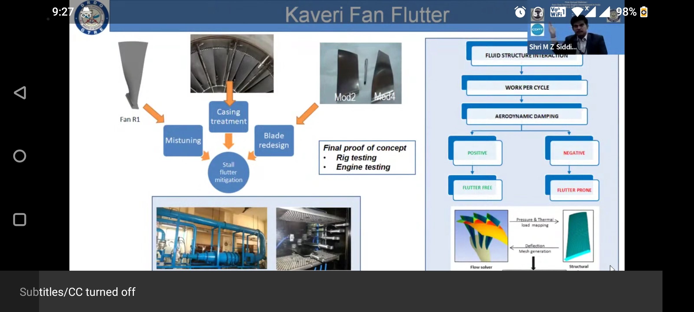

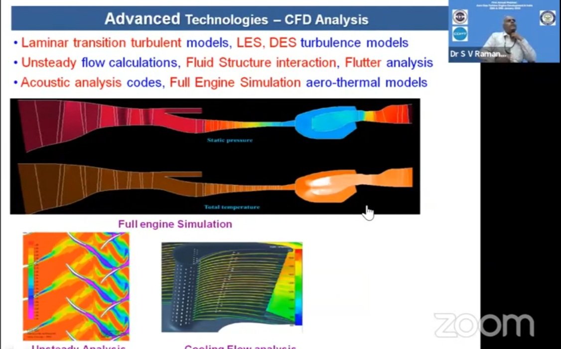

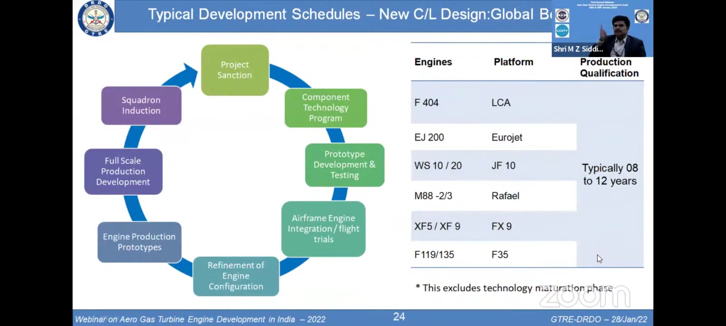

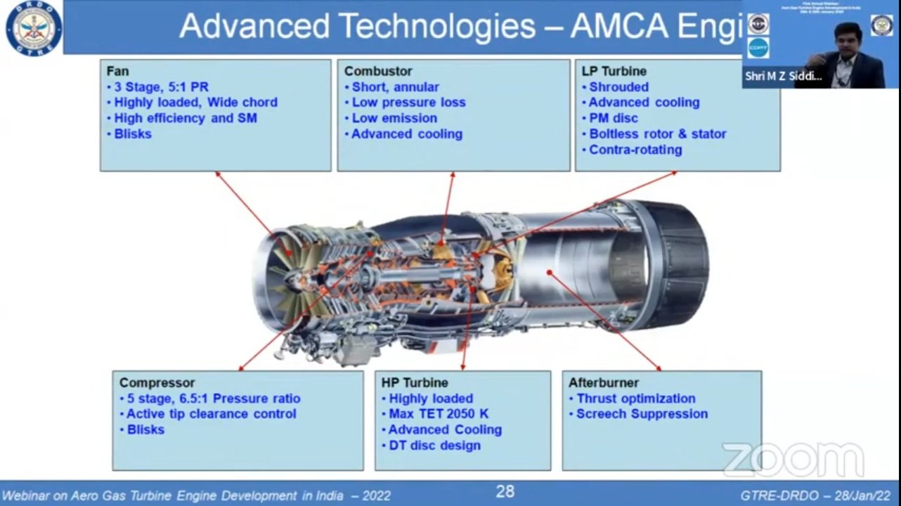

https://twitter.com/defence_in/status/1 ... tE6-etd49g ---> The flutter issues have been solved. Tool for flutter design has been realized. Then the tool was was tested, got the result in first design try. Around 2017-18, did a complete review by Safran, Kaveri be ready for flight tests with 3 yrs maximum. Courtesy: Not So Dravidian-DFI.
https://twitter.com/defence_in/status/1 ... tE6-etd49g ---> The DRDO have developed both the single crystal blade and titanium compressor disk.
https://twitter.com/defence_in/status/1 ... L5WWWQD-tQ --->
1. HTFE 25 will be integrated with afterburner and variable area nozzle.
2. A lot of work is being done in CMC, PMC and MMC.
3. An Indigenous turboprop engine is proposed for RTA and 250 hp engine is under Development by NAL.
Courtesy: Firestarter-DFI.
https://twitter.com/defence_in/status/1 ... tE6-etd49g ---> The development of the Turbo Machinery.

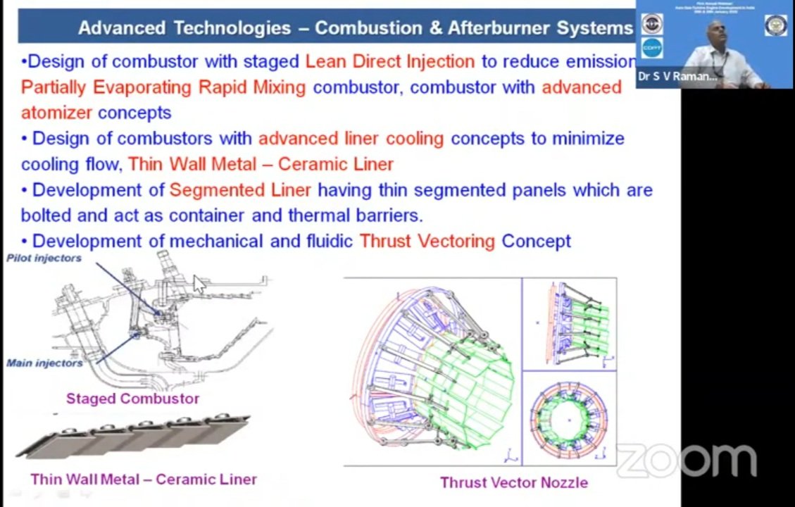

https://twitter.com/defence_in/status/1 ... tE6-etd49g ---> The combustion and the afterburner systems are fully worked out.

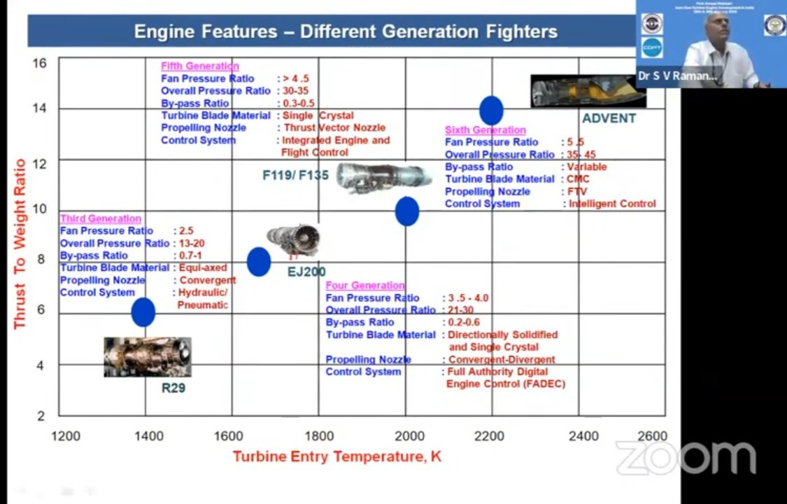

https://twitter.com/defence_in/status/1 ... tE6-etd49g ---> The AMCA's engine would be the "EJ 200 class engine" in terms of the technology.
https://twitter.com/defence_in/status/1 ... tE6-etd49g ---> Correction: T/W> =10, TeT Max 2050K, OPR = 32.5. These specs are too ambitious. Even F119 & F135 doesn't have these specs.
https://twitter.com/defence_in/status/1 ... tE6-etd49g ---> The structural design studies of the AMCA is done.

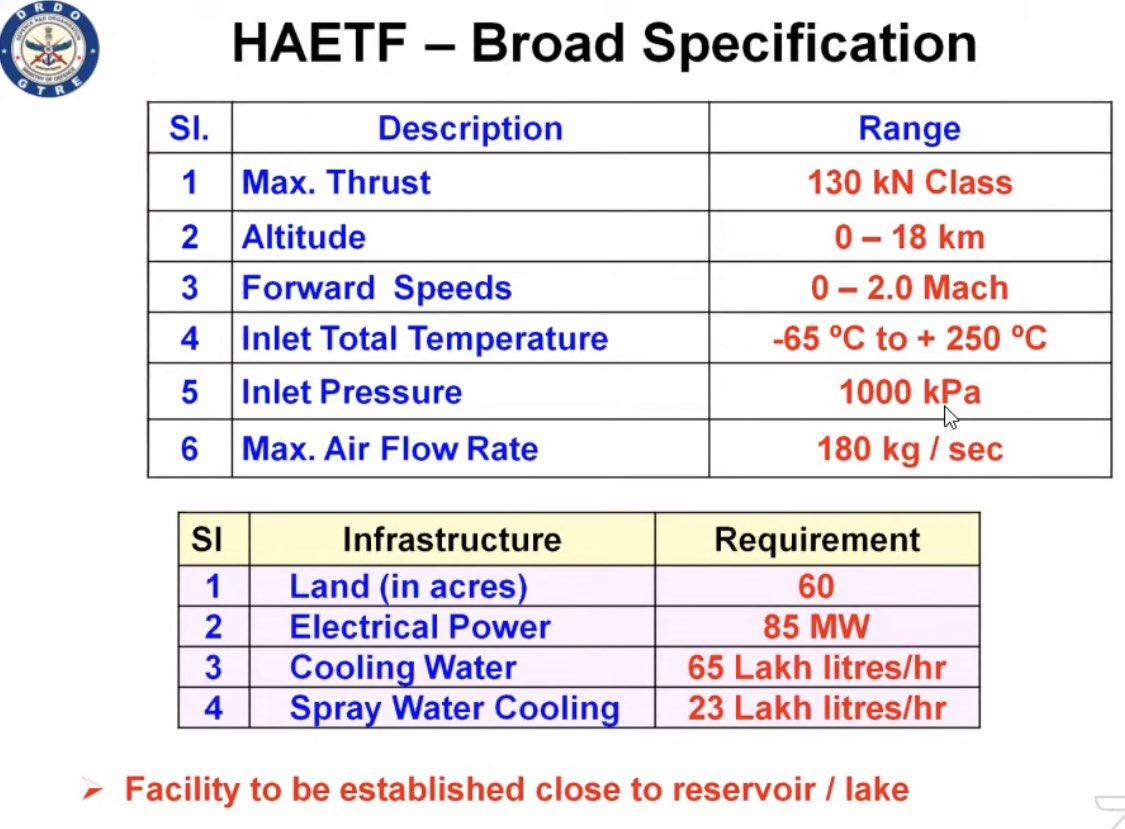

https://twitter.com/defence_in/status/1 ... tE6-etd49g ---> The HAETF specifications.

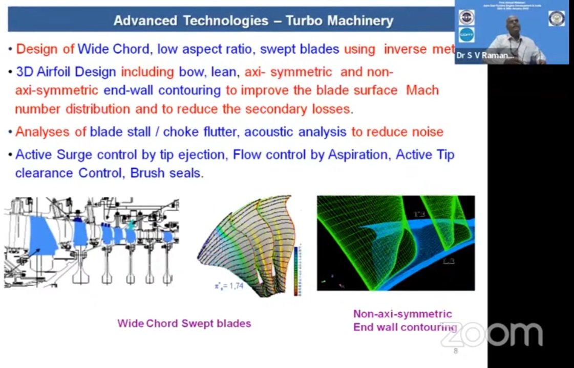

https://twitter.com/defence_in/status/1 ... tE6-etd49g ---> The advanced technologies for turbine manufacturing.
https://twitter.com/defence_in/status/1 ... tE6-etd49g ---> The CFD analysis of the Full Engine Simulations for the Kaveri.
https://twitter.com/defence_in/status/1 ... tE6-etd49g ---> The JP10 slurry fuel with boron additives is taken, which will improve range from by many hundreds kms.
https://twitter.com/defence_in/status/1 ... tE6-etd49g ---> The Kaveri budget overall is only $0.5 billion. [But there is desire for 114 MRFA, which will cost much more than $0.5 billion. Our priorities!!] :roll:
https://twitter.com/defence_in/status/1 ... tE6-etd49g ---> The critical technologies for AMCA being developed.
https://twitter.com/defence_in/status/1 ... tE6-etd49g ---> The material configuration of Kaveri engine mostly indigenously developed and made.
https://twitter.com/defence_in/status/1 ... tE6-etd49g ---> The development till now.
https://twitter.com/defence_in/status/1 ... tE6-etd49g ---> The developmental challenge faced during the Kaveri's R&D.
https://twitter.com/defence_in/status/1 ... tE6-etd49g ---> The advanced technologies of the AMCA engine.

Is there a link to that webinar or its presentation? Thanks, ramana
