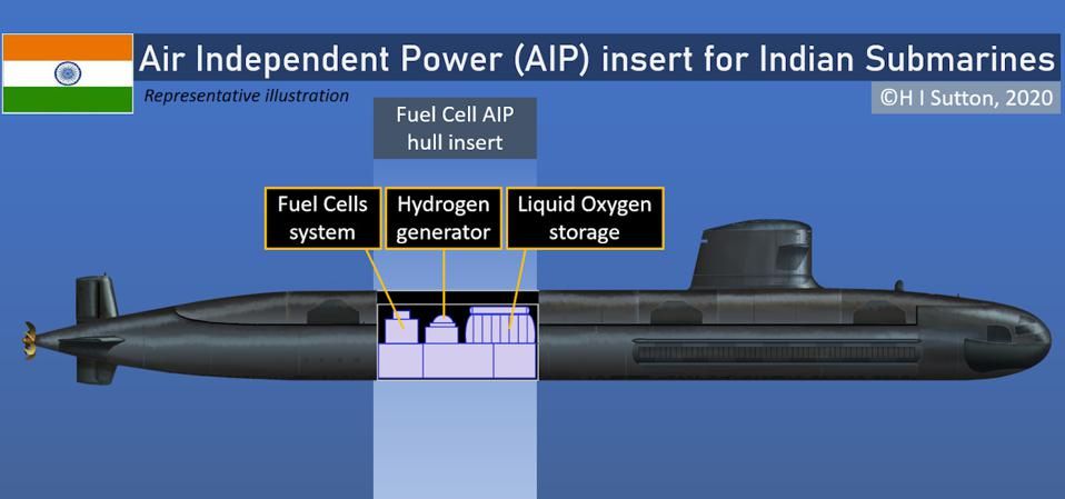

Some good news on DRDO's AIP program...
https://twitter.com/TheLegateIN/status/ ... 02VhKjedIw ---> Indian Navy's Scorpene class submarine, INS Kalvari to be fitted with DRDO AIP in 2025.
Indian subs will be fitted with AIP made in India: DRDO Chief
https://www.financialexpress.com/defenc ... f/2578408/
30 June 2022
Based on the tweet and article above, some inferences can be made;
(I googled the tweet and found the article. Simple Onlee
1) Installing a DRDO designed & developed AIP on-board the most modern SSK in the Indian Navy, suggests that the AIP design is mature for integration. Testing on board an operational submarine is a whole other ball game and will take time. But this plan is in itself a huge step forward.
2) INS Kalvari was commissioned on 14 December 2017. To go in for a refit in 2025, is a huge improvement over the Kilo and HDW 209 boats. They went in for their refits much later. Quicker and successive refits (over the life of the submarine) will keep the platform up-to-date and lethal.
3) If the marriage of the AIP and INS Kalvari is successful, this will have an impact on the Project 75I program. If the requirement of an operational AIP is dropped from the P-75I contest, many (if not all) of the contestants who walked out...will then qualify again. I am specifically looking at Naval Group of France, as building additional (albeit modified) Scorpenes is the best path forward.
4) A much needed next step (and still not taken AFAIK) is the purchase of a new generation torpedo. Either the F-21 from Naval Group of France or the Black Shark from WASS of Italy (the original choice for the IN's Scorpene boat) or the DM2A4 from Atlas Elektronik of Germany (currently used by the Pakistan Navy's Agosta 90B submarines). I believe DRDO is working on a submarine capable variant of the Varunastra, but have not heard much on that.

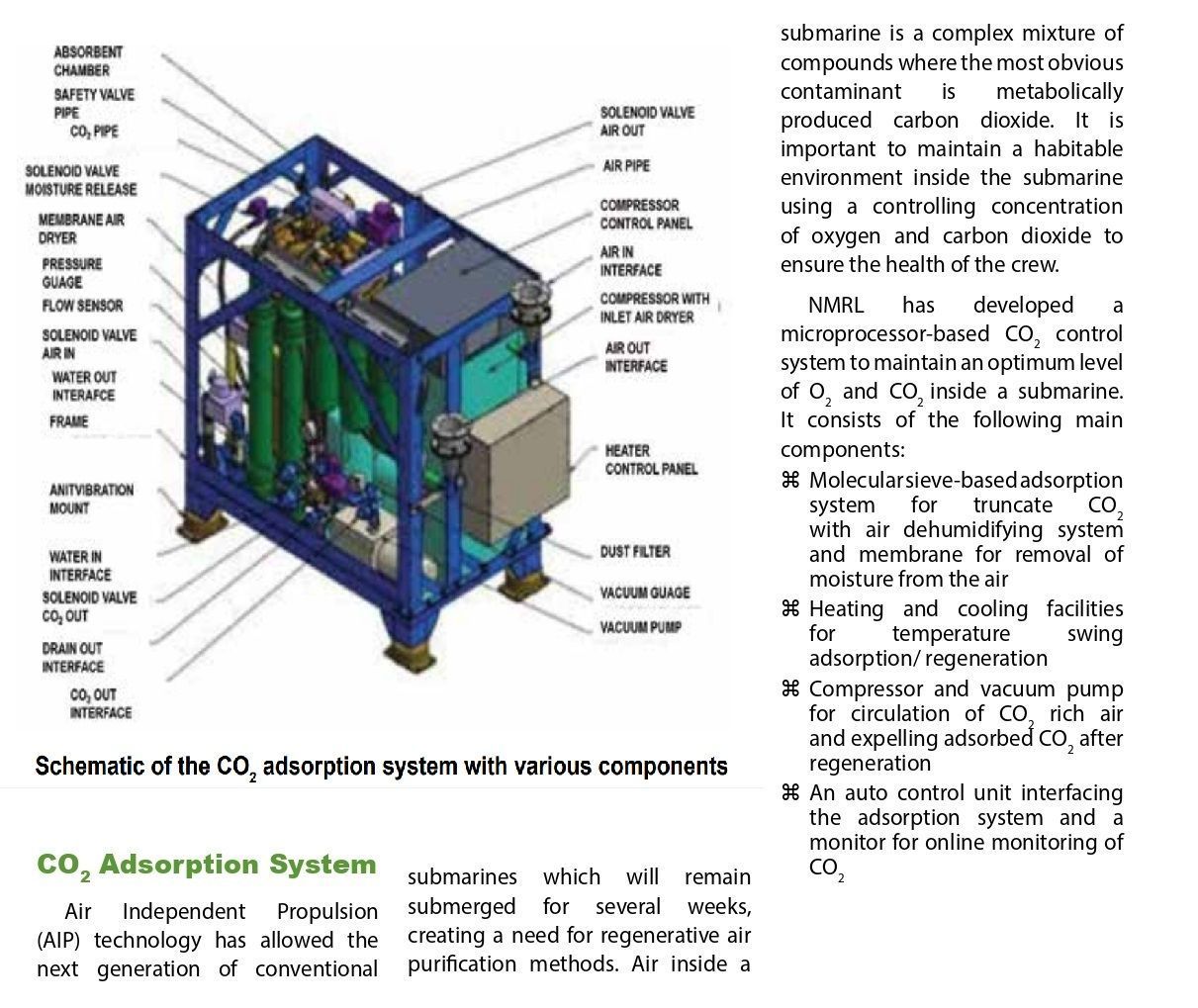

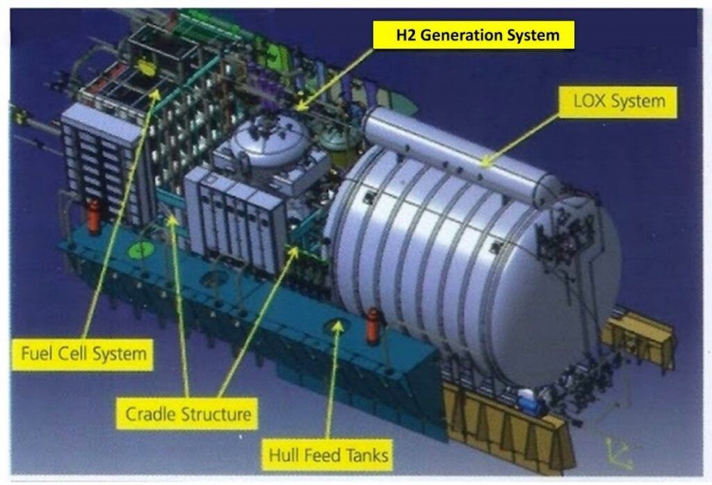

A tweet from 2021 about DRDO's AIP. Notice how the dates below have now been pushed forward in the article above.
https://twitter.com/strategic_front/sta ... 02VhKjedIw ---> User evaluation trials of the air-independent propulsion (AIP) should be completed by the end of 2021 or early 2022. The First Kalvari class submarine comes in for a refit in 2023. DRDO will have about a year to start manufacturing & deliver at least 1 AIP hull plug to MDL.
https://twitter.com/strategic_front/sta ... 02VhKjedIw ---> NMRL had developed & deployed CO2 scrubbers for Indian SSBNs. The development of AIPs for SSKs will increase their underwater endurance, thus creating a need for CO2 scrubbers on SSKs too. The Indian Navy's Kalvari class SSks will likely be the 1st to receive the AIP & scrubber.

Great news on both fronts: AIP and Zorya replacement
Thrilling news.Rakesh wrote:Some good news on DRDO's AIP program...
In March last year, DRDO successfully operated the AIP in endurance mode and max power mode on shore at Vishakapatnam.

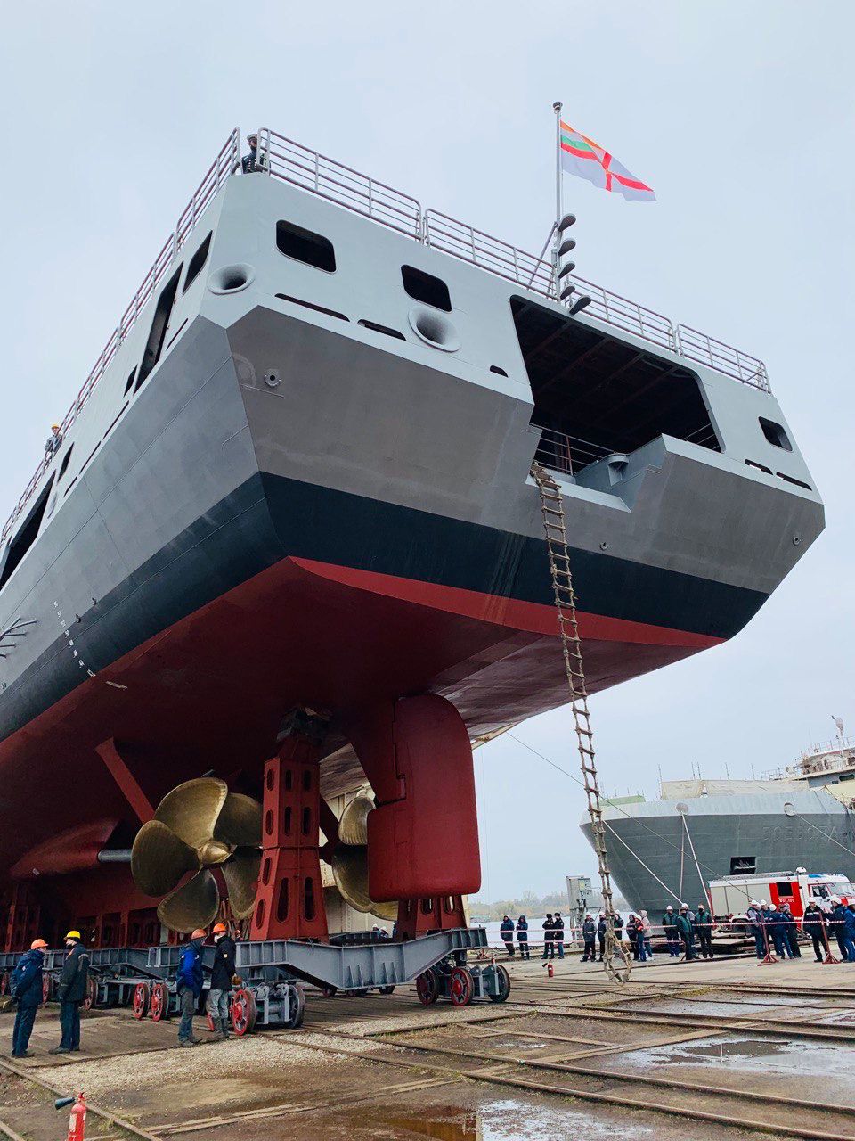

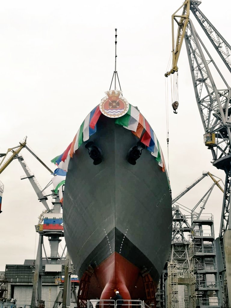

Defence Minister Rajnath Singh to launch P17A stealth frigate on July 15.
Strengthening the maritime capabilities of the Indian Navy, the second P17A stealth frigate built by warship maker Garden Reach Shipbuilders and Engineers (GRSE) will be launched by Defence Minister Rajnath Singh on July 15, a senior official said here on Saturday.
