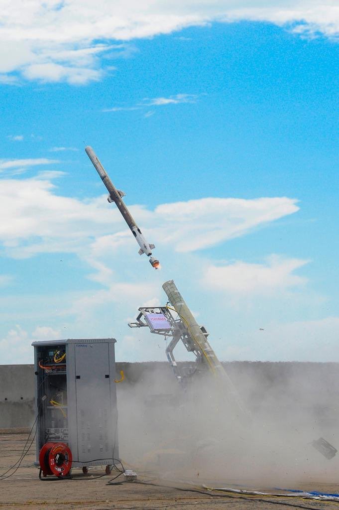

https://twitter.com/livefist/status/157 ... AwsD-IYJow ---> BREAKING: India’s @DRDO_India test-fires new indigenous VSHORADS (very short range air defence system) from the east coast. The shoulder fired system is to meet a large unmet requirement that was to be met by foreign sources but didn’t take off.
andy B
Posts: 1681
Joined: 05 Jun 2008 11:03
Location: Gora Paki
Re: Indian Missiles News & Discussions - 30 June 2022
Post by andy B »
BC finally! :twisted: been waiting for this for a very long time!!
Vid says dual thrust solid motor. You can see vanes aft the mid section before the fibs and nozzle.
Will be very interesting to see further details. In the test it's already seems to be manoeuvring towards a target or an electronic point of impact. This doesn't seem to be a first flight test system probably is fairly matured already!
Any ideas on the seeker....if this is up and running then we may see some rapid progress on IR Astra and CCM as well. Fingers crossed.

https://pib.gov.in/PressReleasePage.aspx?PRID=1862617
Successful Flight Tests of Very Short Range Air Defence System (VSHORADS) Missile by DRDO
Posted On: 27 SEP 2022 6:20PM by PIB Delhi
DRDO conducted two successful test flight of Very Short Range Air Defence System (VSHORADS) missile on 27 Sep 2022 from a ground based portable launcher at the Integrated Test Range, Chandipur, off the coast of Odisha. VSHORADS is a Man Portable Air Defence System (MANPAD) designed and developed indigenously by DRDO’s Research Centre Imarat (RCI), Hyderabad in collaboration with other DRDO laboratories and Indian Industry Partners.
VSHORADS missile incorporates many novel technologies including miniaturized Reaction Control System (RCS) and integrated avionics, which have been successfully proven during the tests. The missile, meant for neutralizing low altitude aerial threats at short ranges is propelled by a dual thrust solid motor. The design of the missile including launcher has been highly optimized to ensure easy portability. Both the flight tests have completely met the mission objectives.
Hon’ble Raksha Mantri, Shri Rajnath Singh complimented and appreciated the efforts of DRDO and industry partners and said that this new missile equipped with modern technologies will give further technological boost to the Armed Forces. Secretary DDR&D and Chairman DRDO congratulated the entire VSHORADS team for this tremendous success.

Finally we have our own MANPAD. Ideally should have been realised as part of IGMDP being so basic and necessary. At 20 kg seems to be on heavier side. Looks like it will exist along with Igla for now. I could be wrong, seeker seems to be old school type and not IIR.
Posts: 23187
arvin wrote:Finally we have our own MANPAD. Ideally should have been realised as part of IGMDP being so basic and necessary. At 20 kg seems to be on heavier side. Looks like it will exist along with Igla for now. I could be wrong, seeker seems to be old school type and not IIR.
https://twitter.com/Indrani1_Roy/status ... AwsD-IYJow ---> Igla and Mistral/RBS70 are not in the same class. The latter is heavier and is generally fired from a tripod from a sitting position. DRDO's design seems to be in the same class.
https://twitter.com/Indrani1_Roy/status ... AwsD-IYJow ---> Missile weight around 20 kg. Missile plus launcher tube around 25 kg. Similar to Mistral.
https://twitter.com/Indrani1_Roy/status ... ljS7J0r_gg ---> Trade-off between launch weight and missiles effectiveness. Igla/Stinger chose one way and Mistral/RBS70/Starstreak/VSHORADS chose the other.
They have adopted the proven Nag type propulsion layout. The booster is venting from those side nozzles which are flush with the fuselage (less drag I'd presume) and the sustainer will probably kick in from the main nozzle below. This is probably what they mean by dual thrust. If the sustainer itself is dual pulse, that would be something but very unlikely for a short range system. The nose has an aerospike, again for drag i presume, and will probably have a seeker designed around it (the aerospike comes from the middle). Or perhaps its temporary. Heavy duty missile, meant for semi-static deployment. The launcher is already fairly developed (can see in the image) and a fire control box appears to be placed on it. Cool system, as usual I expect IA may crib about weight, size but hopefully IAF picks it up in substantial number. This is a performance oriented system.

Kakarat wrote:https://pib.gov.in/PressReleasePage.aspx?PRID=1862617
The most Important operative word highlighted. Congratulations !! Realization of miniaturized RCS . That will make the missile most deadly.
Also promising future use in CRAM missile.
Also notice the folding wing tips that unfurl in flight !
https://en.m.wikipedia.org/wiki/Counter ... and_mortar

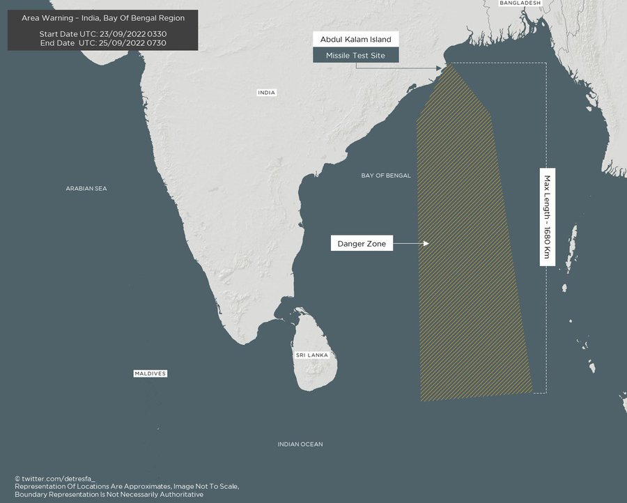

Ashokk wrote:Area warning 23 - 25 September 2022
#Areawarning #India issues a notification for the launch of an experimental flight vehicle
Launch Window | 23 - 25 September 2022
No further news ???
Posts: 60413
Any weather issues in Bay of Bengal?

That MANPad looks HUGE, will need a Bahubali to carry, lift and fire it.
Gyan
Posts: 1596
Joined: 26 Aug 2016 19:14
Post by Gyan »
Most probably it will be fired from a tripod and not off the shoulder

Cyrano wrote:That MANPad looks HUGE, will need a Bahubali to carry, lift and fire it.
Remember that not all air attacks will be standoff using MRCAs. Its simply too expensive for mobile & lightly defended targets, and helicopters/shturmoviks using strafing/rockets/bombs still have a huge role for attacking convoys, non-permanent forward bases, military camps, etc.
Its not a MANPADS, officially a VSHORADS. Will be mounted on:
1) static mounts - protection for non-permanent forward bases, military camps
2) light 4 wheeled vehicles such as jeeps/trucks - protection for moving vehicle convoys
3) landing craft/minesweepers - last ditch protection in contested areas, similar to the SA-N-5

QRSAM can take on a bulk of targets, small and fast/slow, big and fast/slow etc. It's really behind Akash in one area - that is the overall altitude of engagement. QRSAM is designed for low-altitude targets primarily.
Some of it is perspective, making the missile look bigger than it is.
It's deployment architecture will be similar to this system.
https://en.missilery.info/missile/mistral
Or this
https://www.armyrecognition.com/british ... cture.html
Might be marginally bigger etc but then again DRDO is likely looking to optimize performance. Of course, whether IA accepts their proposal is a whole different ballgame. Very cynical of their methods of late. Might stand a better chance with IAF.

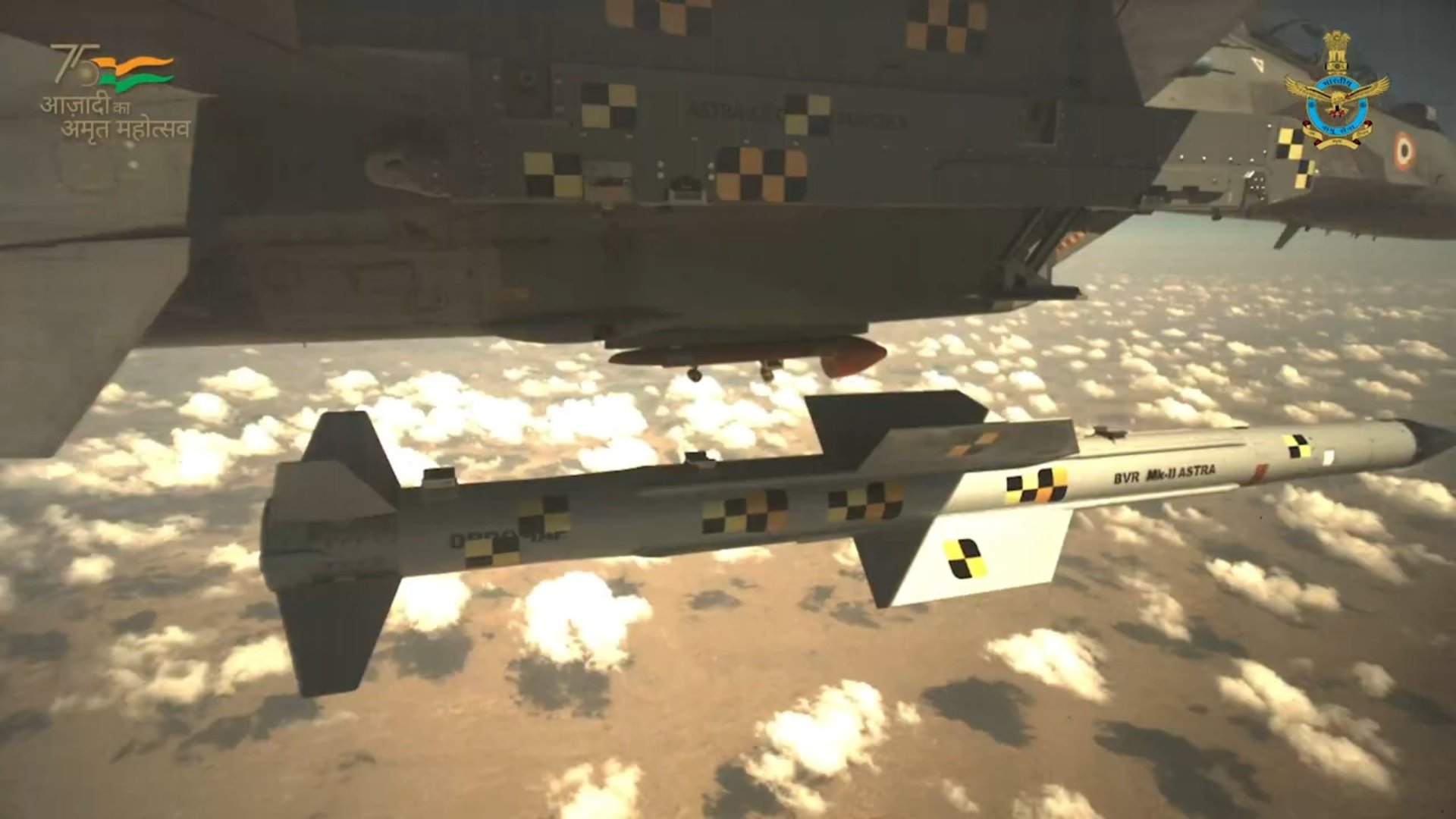

Was this a drop test?
I thought that Astra Mk2 was going to be ramjet powered missile?
If not, then what's the difference between the Mk1 & 2?
Is Astra Mk3 going to be ramjet?
Mk2 - Dual Pulse (like MRSAM/NGARM)
Mk3(nomenclature not official yet) - SFDR
Thakur_B
Posts: 2438
Post by Thakur_B »
Mk2 Dual pulse motor
Mk3 SFDR
Thanks guys.
