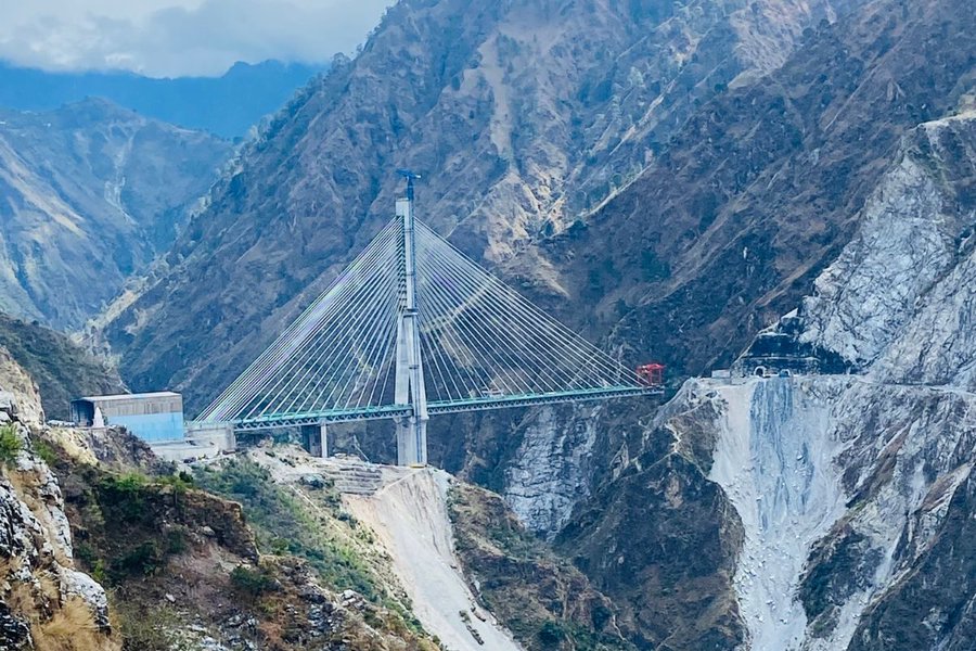

Posts: 36280
Anji Khad bridge, India’s first cable-stayed rail bridge will connect Katra to Reasi in J&K.
Its 96 cables were fully installed in a record time period of 11 months.....
It's also an asymmetric bridge, balanced on the axis of a central pylon
The Anji Khad Bridge is expected to be completed in August 2023
suryag
Posts: 4119
Joined: 11 Jan 2009 00:14
Post by suryag »
Nowadays i search for the AK bridge with the same enthusiasm i had when i used to search for tejas flight updates on ada website. There is only one more segment left to be completed and once this bridge is completed only track laying and other stuff would be pending on USBRL(there is minor excavation of about 200 m left in some tunnel) and come 2024 may be we can have Kanyakumari to Baramulla express
