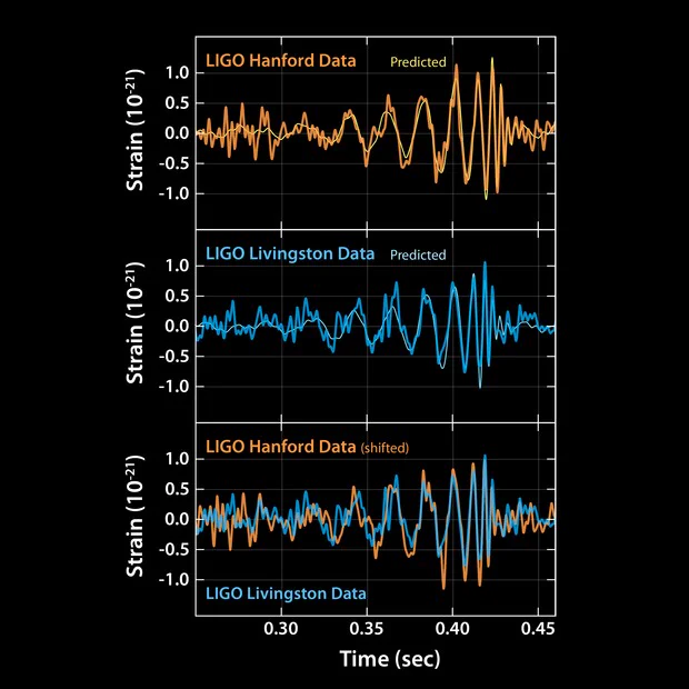

Eight Years ago, I posted in BRF a breaking news about GW150914 - The Gravitational Wave -- (ahead of most news papers in India)
I said then, it was a BIG News... Many Nobel Prizes, and others honors were awarded. India is spending Billions of dollars in LIGO-India Project.
(Unfortunately by shameless trolling by the ususal characters the thread was trashed, dozens of messages were deleted but maby messages still exist .. Here is one old one ..
Amber G. wrote: 14 Oct 2017 04:29 ^^^ Okay more on above:
- European Southern Observatory is billing as an "unprecedented discovery".
- The two organizations will be joined 70 other observatories ( with simultaneous briefings in multiple places).
IMO The scale of the announcement certainly suggests it is something big. (Bigger than their winning the Nobel this year)
NSF Statement:
The gathering will begin with an overview of new findings from LIGO, Virgo and partners that span the globe, followed by details from telescopes that work with the LIGO and Virgo collaborations to study extreme events in the cosmos,
For US people - the conference is due to take place at The National Press Club in Washington, on Monday 16 October at 8AM EST. One can watch it live on the National Science Foundation(https://www.nsf.gov/) or European Southern Observatory website.
Meanwhile today in Nature.com: Interesting article http://www.nature.com/news/global-netwo ... es-1.22828
Happy 8th birthday to the one that started it all GW150914! After Einstein predicted the existence of GravitationalWaves, it took 100 years to detect the first. Now we detect a gravitational-wave event about once every 3 days!
