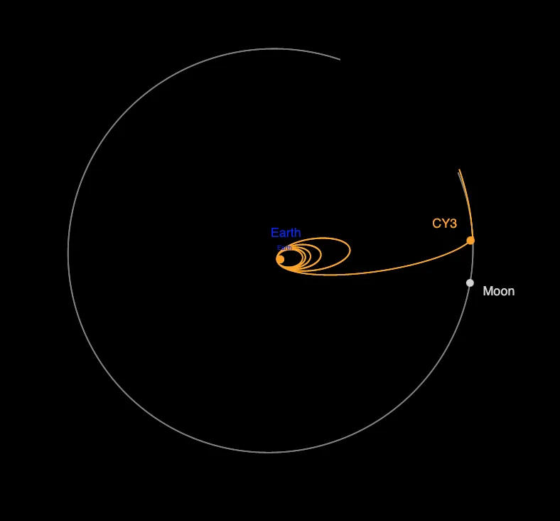

Chandrayaan3 orbit data has been updated at @NASAJPL HORIZONS post TLI. (So in Sankara V. data - so the animation link posted here is also been updated now. Looks like LOI seems to be around 5th August, 7:19 pm IST.

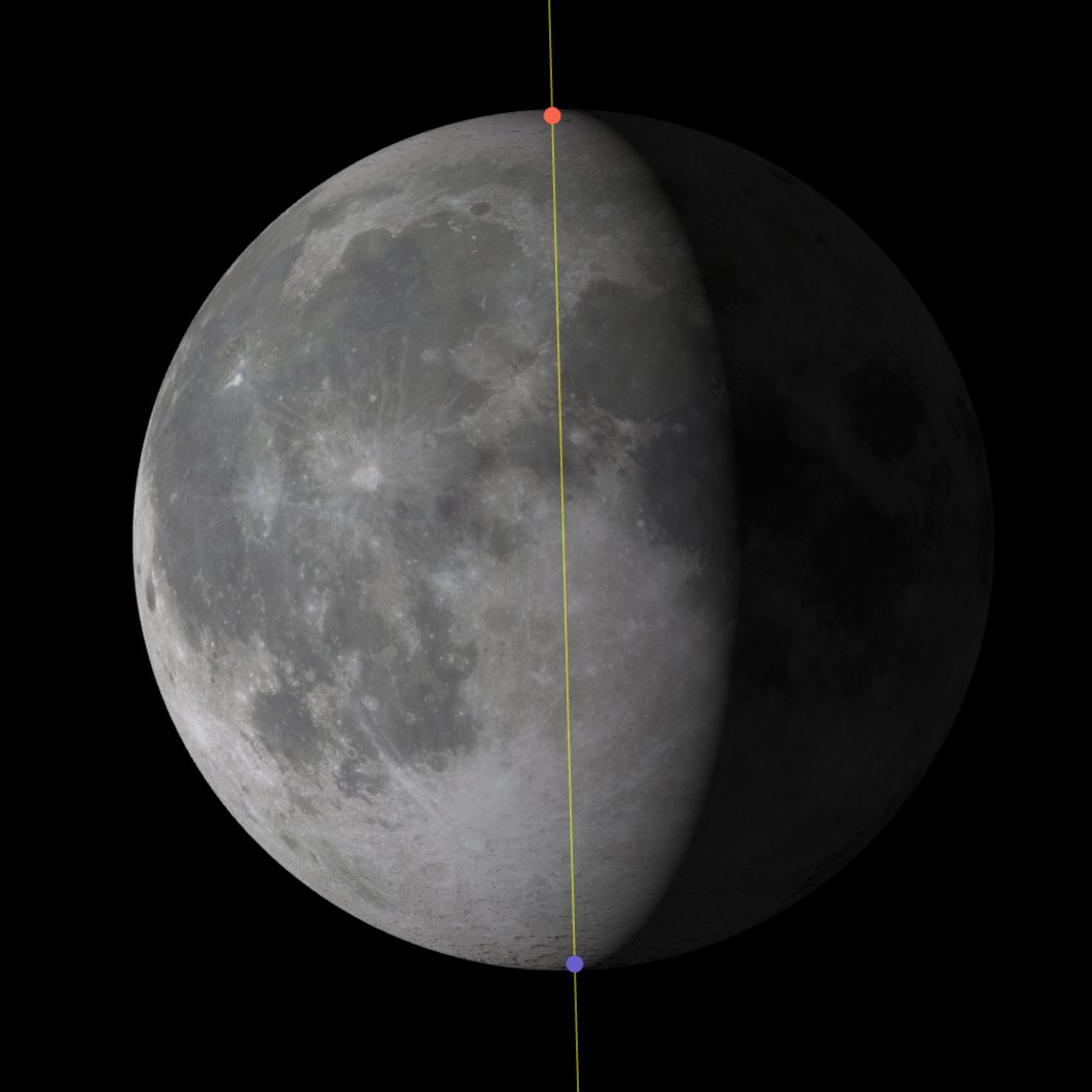

Meanwhile when I look out in our front yard, I see:
Of course, If I was on CY3, this would have been the view:
--- If you click on the above picture, you can see how moon looked, from CY3's perspective for last few weeks... you can even see liberation..

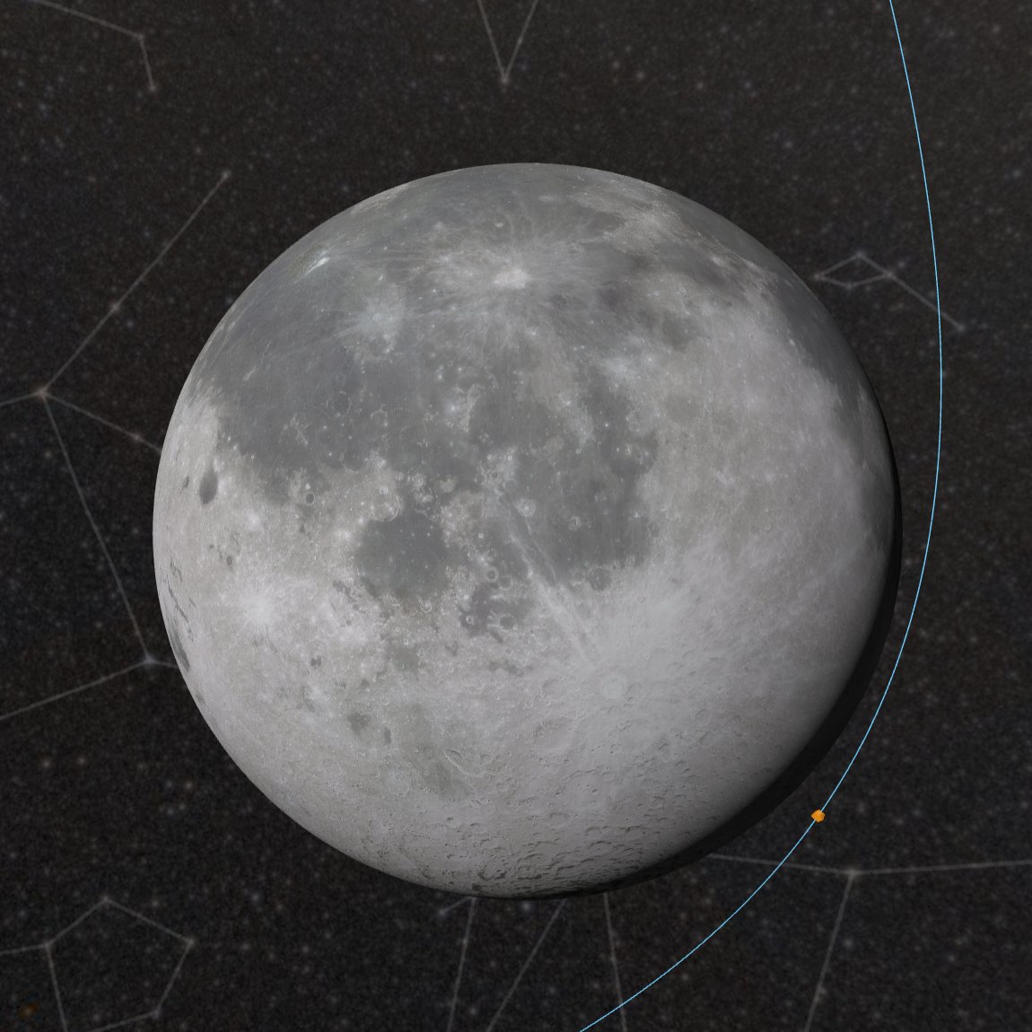

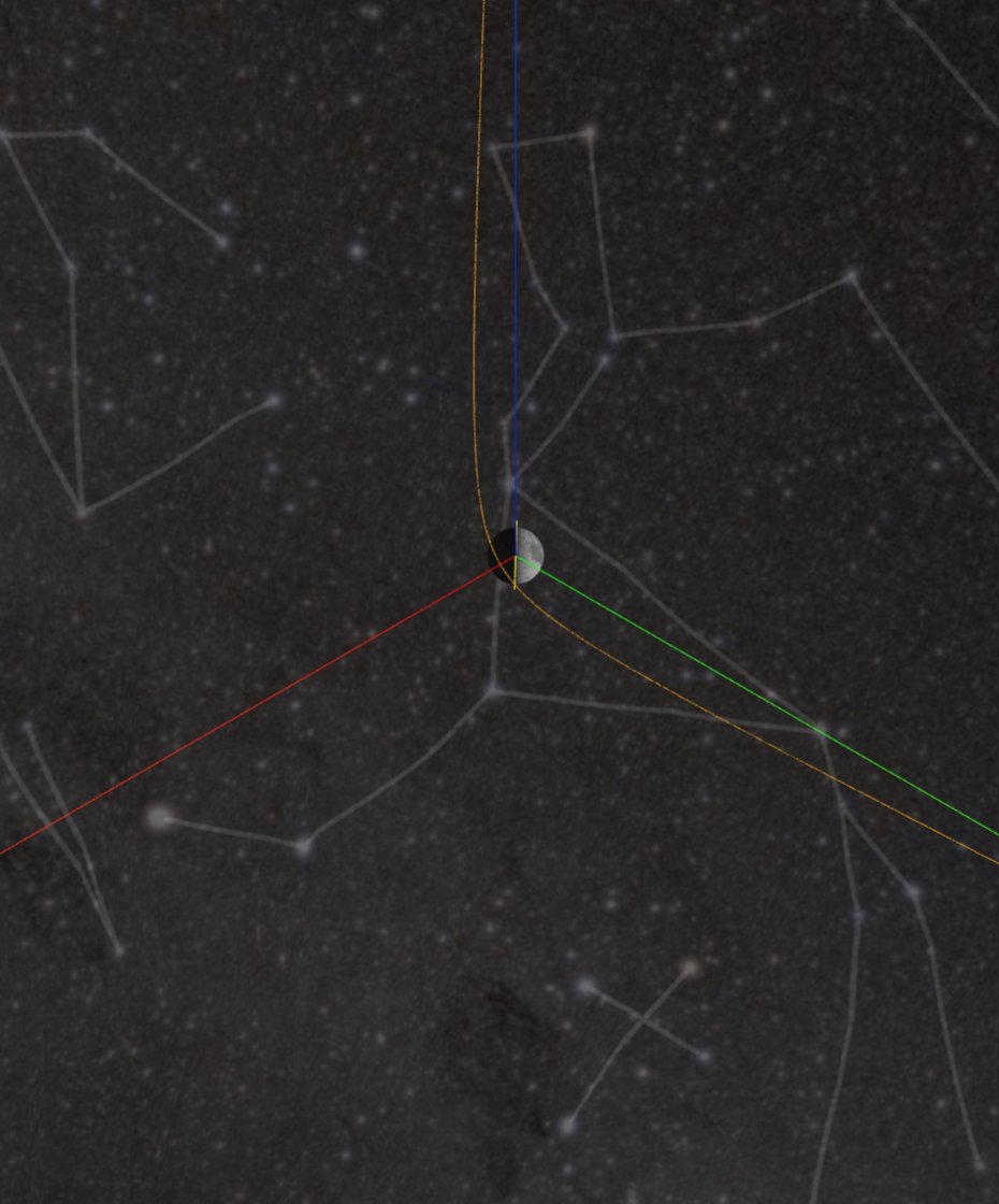

To be clear, the simulation I posted above ... posting it again, as I think it is quite nice one.. (Click on image to see the video:
This is what if we look at the moon from CY3..

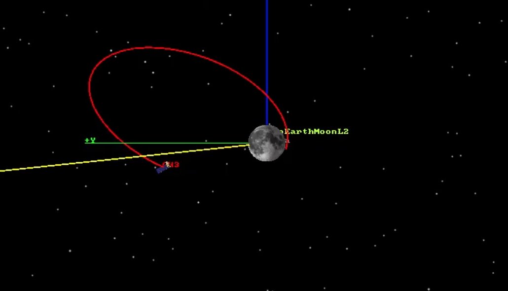

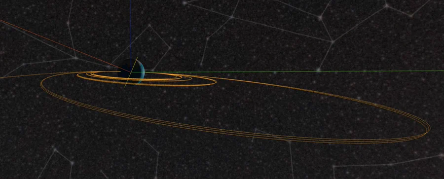

By the way at the time of the post the orbits are: (CY3 is still some distance away from the moon :)...)
Wrt to Earth (Moon goes around Earth too)
Wrt to Moon:

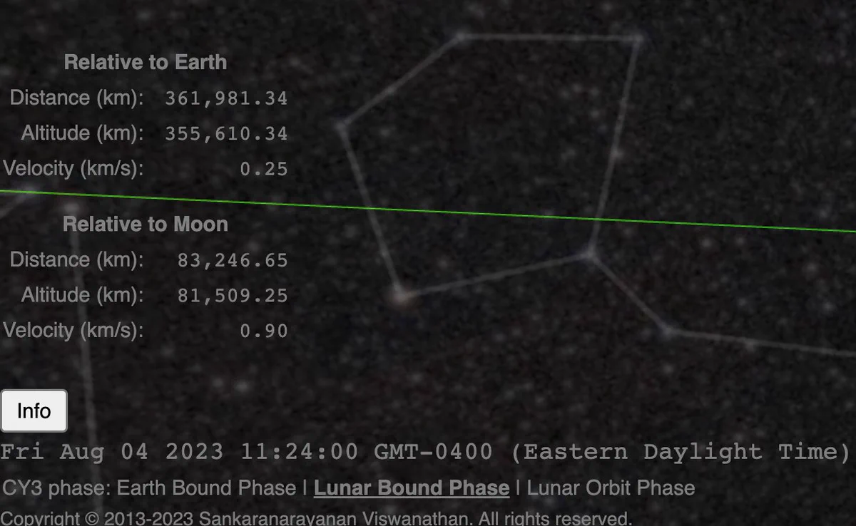

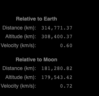

(At present, as I post, (11:24 EDT = GMT -4) CY3 is about:
From Earth - 362,000Km (from center) , speed 0.25 Km/sec (wrt to earth)
From Moon - 83,250 Km (from center, about 81,510 from surface), speed = 0.90 Km/sen (wrt to moon)
From Sun - Of course, ~ 150 Million Km, speed = 30 Km/sec (wrt to Sun) etc
Date and Time stamp:
Orbit XY- Plane (Earth Perspective) (This is 2-D plane - in which moon orbits around Earth - Most(almost all) orbits of CY3 are roughly in this plane though it does a do a small amount of up-down ( direction of North Pole of Earth/Moon is up here) on this plane -- final orbit of CY3 will be perpendicular to this plane)
At present: Image

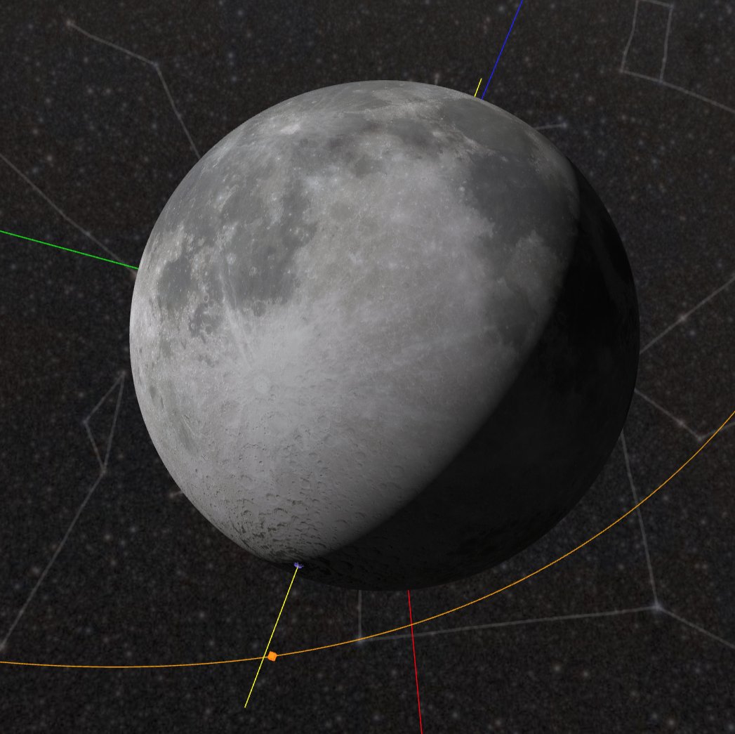

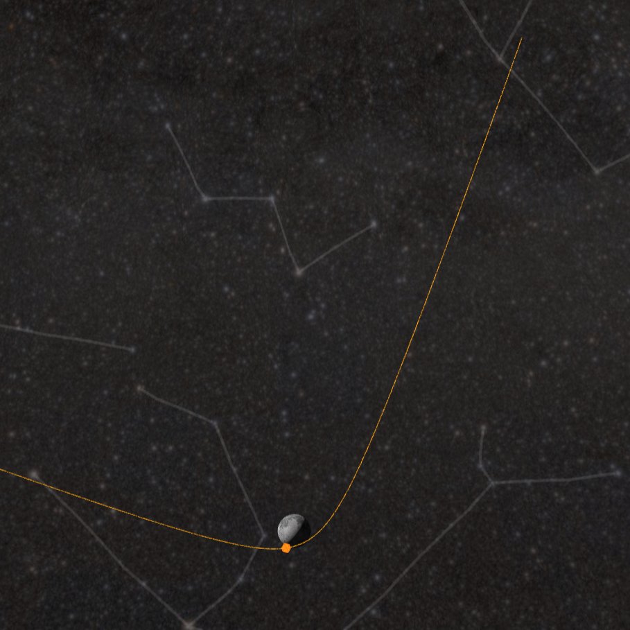

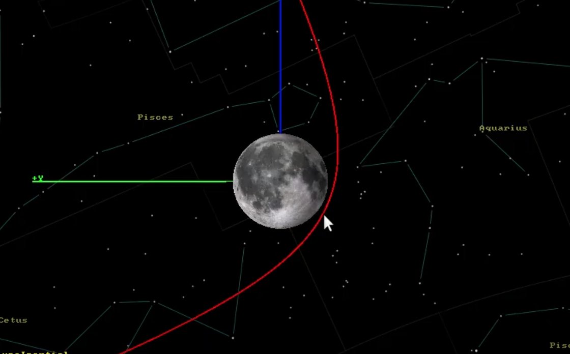

In 3D - At the time of LOI (Closest approach to the Moon)
Different perspective Orbit: YZ Plane:
Moon Perspective:
If all goes well, at LOI if you look out the window of CY3:
-- After LOI ( Tomorrow) - after last update on the burn and new orbit(s) will be more precisely calculated - Probably there will be 4- 5 burns, (all carefully planned and calculated by ISRO - I am still impressed with how accurate they can manage the burn) before a nice polar circular orbit is achieved.

Re: Chandrayaan 3: Launch and Discussions
^^^^ Yes, more details - Perhaps slightly OT for this thread - but probably not as to see how accurately we can predict orbits, and reestablish communications even with old electronics after decades, and to give some idea how powerful radio telescopes (in tracking CY3 etc) are ...... here is the story many will find interesting...

Posts: 10969
ISRO: CHANDRAYAAN3 HAS JUST ENTERED LUNAR ORBIT!! 🌕🚀
As expected here is Official Announcement from ISRO (Ⓒ BRF)

Ashokk wrote: 05 Aug 2023 22:18 https://twitter.com/isro/status/1687859829803466753
Today's maneuver has resulted in an orbit of 164 km x 18074 km, as intended.
Thanks. (Estimate I calculated/estimated (~115 Km) is quite accurate from very spotty initial data from doppler).. )..Important point is next few burns CY3 will be in as ideal position as anyone hopes for.
(Sankar V's web page will be updated soon with the updated data as soon as JPL?Horizons updates it.

For those who are familiar with Moon's geography -
From what I know one of the best candidate for touchdown on August 23 is within the southern region of the Moon’s near side is Manzinus U crater - soft landing about 20 kilometers west of the rim. CY3 will take its time to select the best landing site so that it gets full 'day' (about 14 earth days) of sunlight. (Again, if they do not find good site, they may wait a few weeks for the next opportunity).

Many/most of the shots of the lunar orbit of CY3 above (including the orginal ISRO brochure) do not show the lunar axis, hence difficult to judge if the current orbital plane of CY3 is polar (or close). The animation by Sankaranarayan (based on orbital elements) does show the axis of moon and the trajectory of CY3. Per this animation, CY3 trajectory at the end of TLI intersects the orbit of the moon around earth and gets there 'ahead of moon' and the approaching moon pulls it towards itself rightaway (roughly reversing its velocity vector) and CY3 goes into a polar orbit- going from south to north in the first orbit itself. Not sure how this aligns with what was shown in the satellete Tracking channel simulation- does not seem to, actually.

Just for general info:
Showing the significance of orbit attained.
Ground path that the orbit takes while the CH3 is orbitting.
Notice the Landing sight 'L' and the South pole 'P'
( Note: This is based on Planned orbit ... not on the achieved orbit. Will update when available including . How the sunlight illumination plays role in deciding the 14 days life of Lander. )
SSSalvi
Posts: 787
Joined: 23 Jan 2007 19:35
Location: Hyderabad
Post by SSSalvi »
juvva wrote: 06 Aug 2023 07:47 iirc the apollo lunar missions used to execute a loi burn on the far side of the moon, but it looks like chandrayan_x missions execute the burn in radio visibility of earth.
why the difference?
Depends on the sight that you want to land on surface ... as well as specific requirements based on transfer point of 'Handover' of craft to Ms. Moon ( in English language regions ) or Mr, Moon ( India and Germany region ) .

Tanaji wrote: 06 Aug 2023 00:21 Stupid q: Is the firing to reduce the orbit done at apogee or perigee? Why? Does it reverse for increasing the orbit?
General rule dictated by Mr. Kepler .....Firing at one end changes the other end.
Fire to add velocity will increase other end altitude and Fire in reverse direction of motion to reduce the altitude of other end.
Added later : Example of two types of burn in CH3 mission
If you watch Launch Video https://www.youtube.com/watch?v=q2ueCg9bvvQ at 51:00 minute, just before separation the Perigee is nearly 170 kms. That is the limit imposed by GSLV capability.
This altitude has some atmospheric drag so this needed to be increased.
In the 1st orbit burn at Perigee, Apogee alt was raised to 41760 kms ( Perigee still about 170 Kms ).
Susequently, in 2nd orbit burn ( near apogee), raised perigee from 170 Kms to 226 Kms without significantly changing the Apogee alt.
Since this did not raise the Apogee, there was no much celebration for common man so this burn went almost un-noticed.
