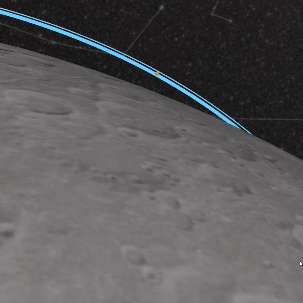

If you are looking at Sankara V's excellent orbit simulation The orbit updates include LBN5.
NASA/JPL tells us "158" will continue to be lander ID. 169 will be used for PM. Separation data not available yet but hope that it is there soon.
(If you have not tried, try "joy ride" feature from the above simulation .. to see how close to moon you are and how swiftly moon passes down there)
: Meanwhile, the PM will continues its journey in the current orbit for months/years.

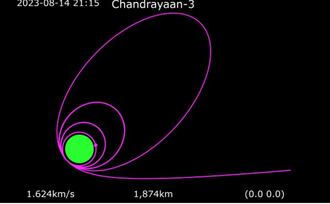

Journey so far: For BRF quick reference:
Earth Bound:
1 15 July 2023 — 41,762 km 173 km Success
2 17 July 2023 — 41,603 km 226 km Success
3 18 July 2023 — 51,400 km 228 km Success
4 20 July 2023 — 71,351 km 233 km Success
5 25 July 2023 — 127,603 km 236 km Success
Trans Lunar Injection:
31 July 2023 — 369,328 km 288 km Success
Lunar Bound
1 5 August 2023 -- 18,074 km 164 km Success (Orbit Time Approx. 21 h )
2 6 August 2023 — 4,313 km 170 km Success (Orbit Time Approx. 6.25 h)
3 9 August 2023 — 1,437 km 174 km Success (Orbit Time Approx 2.3 h )
4- 14 August 2023 - 151 km 179 km Success (Orbit Time Approx 2.07 h) (ISRO Figures: 7434 sec)
5 16 August 2023 - 163 Km 153 Km Success - (Orbit Time 2.05 h)
17 August 2023 Lander Module Separation PM Orbit Success- 163 Km - 153 Km (Orbit Time (2.05 h)
18 August 2023 Lander Deorbit Burn I Vikram - 113 km 157 km success - (Updated on August 18 by Amber G.
20 August 2023 Lander Deorbit Burn II (Planned)
23(?) August 2023 Vikram Landing. (Planned)
Click images below to see animation:
Earth Bound: (Click the image to see video)
To the Moon: (Click the image to see video)
Around the Moon: (Click the image to see video)

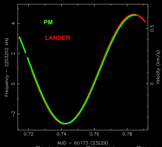

Doppler says: The PM and Lander are distinctly in separate orbit. The lander is leading with the gap increasing between revs. JPL Horizons' data hasn't been updated.

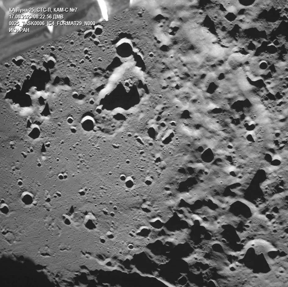

Meanwhile - I have not seen any other confirmation of Luna-25's orbit by others outside the official site...(Unlike CY3, the signals are weak - frequencies not that well-known ityadi)
But per Roscosmos - Luna-25 lander , snapped its first detailed photo of the moon's surface

juvva wrote: 18 Aug 2023 15:19 https://sankara.net/chandrayaan3.html
will it be possible for this kind of animations to include all the 3 craft of interest:
1. lm
2.pm
3.cy2 ( relay station )
of particular interest is the relative positions of lm and cy2 during the landing phase.
For CH2, orbiter,lander and ch2 were 3 separate bodies on Horizons.. same is expected for ch3

Ashokk
Posts: 1409
Re: Chandrayaan 3: Launch and Discussions
Post by Ashokk »
Update from Roscosmos on Luna-25
https://www.roscosmos.ru/39645/
Translation:
Today at 09:20 Moscow time the propulsion system of the automatic station performed an orbit correction lasting 40 seconds. Its goal is to provide the best conditions for the subsequent creation of the pre-landing orbit.
The correction went smoothly, all onboard systems of Luna-25 are working normally, communication with it is stable.

SSSalvi wrote: 18 Aug 2023 16:26
1. lm
2.pm
To add: As I posted here:
Per JPL: For CY3 158 will continue as the lander ID and -169 will be used for the PM. Separation data not yet available.
Plan is both, LM and PM will be animated in that animation as soon as data is posted (don't know if ISRO (or how quickly it) shares this data with JPL).
CY2's orbit is also well known - so it will not be difficult .. if there is interest..

Posts: 12955
After LM's successful deboosting operation that reduced its orbit to 113 km×157 km. I have updated the "Journey so far post" a few posts above. The 2nd deboosting oprtn is scheduled for Aug 20, 2023.
