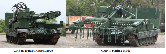

DRDO Newsletter June 2023
HANDING OVER OF PARAMILITARY VARIANT OF WhAP 8X8 TO CRPF
