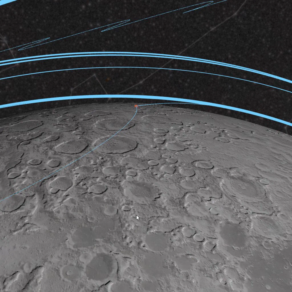

For reference: (Compiled by Amber G, on August 20, 2023
For those who are not allergic to doing simple math and want to do their calculation to know accurate velocity, position of CY3 and CY2 (till next burn). This is in simple terms (each term explained for those who have basic understanding of orbits):
I have gotten the data from JPL/ISRO figures latest available information. (Will edit any correction)
(Some calculation is my own - I believe mathematically correct but will edit if there is any error/typo)
This is one place to look up the data for CY1, CY2, CY3 to calculate their position at any time. (If you have any orbit calculating software or are handy with slide rule (:) or doing calculation on pen and paper.
It has most uptodate reference data:
It contains:
CY3 - Reference data for both Vikram and PM. (PM data, as I post this message is not available from JP/Horizon system so I put it best I could get from ISRO and math)
CY2 - Ephemerides for both Vikram and Orbiter. (Vikram, of course, we know has crashed, but it's orbit just before crash is here)
CY1 - Is inactive there, but still orbiting. Calculating the position from last known position.
Moon/Sun - so one can understand what the lighting condition would be at the landing site .. where earth would be wrt to lander, and where the landing site would be, if you aim your telescope or try to aim your radio telescope..
Written for non-experts some basic astronomy and math is required.

Chandrayaan 3 Vikram JPL/Horizon id: CH3 - 158 EPOCH: JDN(Julian Day Number)=2460176.5 = August 20, 2023 at 00:00:00 UTC
Brief explanation of Reference system Below and values.
Reference center (origin) : Moon Center
Center radii 1737.4 km (To calculate altitude, subtract this from distance)
Keplerian GM : 4.902.8 km^3/s^2 (µ I used in previous BRF posts .. unit here is converted in km^3/sec^2 for ease of calculation)
Output units : KM-S, deg, Julian Day Number for Tp
Reference frame : Ecliptic of J2000.0 (Which NASA/JPL uses - it is essentially same as ecliptic - plane of earth's orbit around the sun)
So X-Y plane is ecliptic , Z axis pointing to ecliptic north. (This is within 1.5 degrees of Moon's equatorial plane)
X - axis is ICRF - points towards vernal equinox (first point of Aries वसंत विषुव )
e = (eccentricity) = .0294 (roughly circular), Inclination = 89.9 degrees (Nearly polar)
perigee = 1763.66 Km (Altitude 29.3 Km), Apogee = 1870.6 Km, a = (Semimajor axis) = 1817.1 Km
Period = 6950.7 Sec.
Longitude of Ascending Node = 268 deg Argument of Perifocus, = 228 degree
Tp= 2460176.471497831400 (Time in JDN when the spacecraft was at perigee.. so that at any given time you can find its position)
Mean Motion = .0518 degree/sec MA= 127.5 degree TA= 130.2 Degree
(MA is Mean anomaly - angle, if the orbit was circular, TA = True Anomaly - Actual angle at focus, from the major axis of the ellipse)

JPL has updated the orbit data for landing ! ( updated just a few hours ago)
Yes!
The landing is at 18:04 IST (12:34 UTC) on 23rd August
the excellent animation has been updated.
Enjoy!
You can watch the animation in real time
( The animation plays advancing at 1 second per second or faster if you wish)

Posts: 12799
Re: Chandrayaan 3: Launch and Discussions
<Click the image below for excellent video>
Landing time lapse from above the south pole of the moon. As you can see from this angle, Chandrayaan3 is aiming for a lunar day (14 earth days post landing.
HT/Credit Sankara V. Animation.

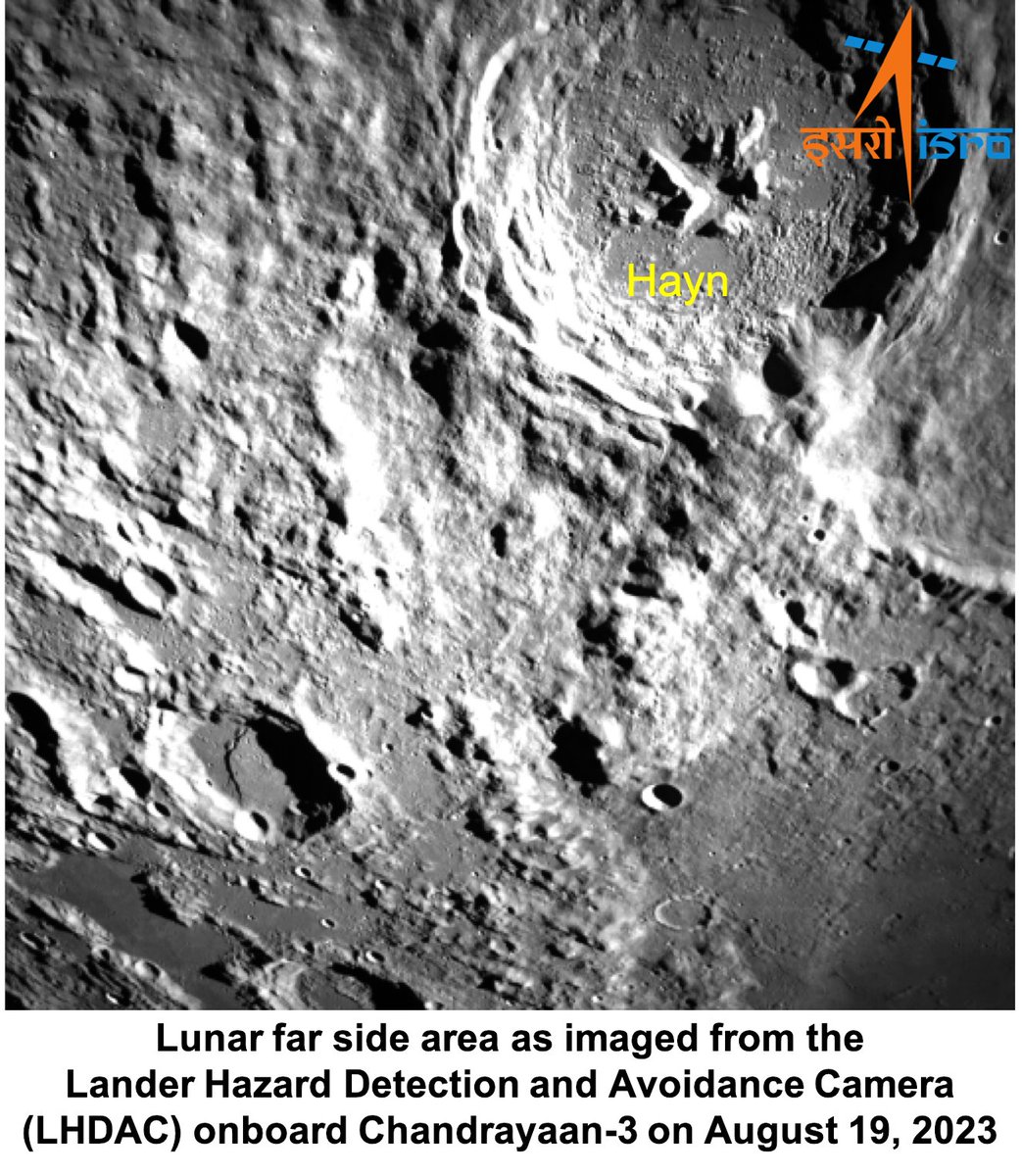

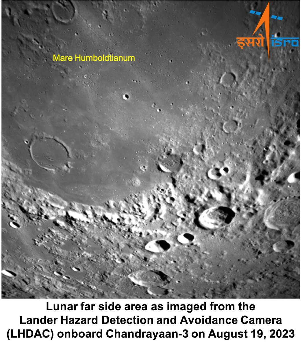

Thought I might post the images of Lunar far side area captured by the Lander Hazard Detection and Avoidance Camera (LHDAC).
This camera that assists in locating a safe landing area -- without boulders or deep trenches -- during the descent is developed by ISRO at SA
