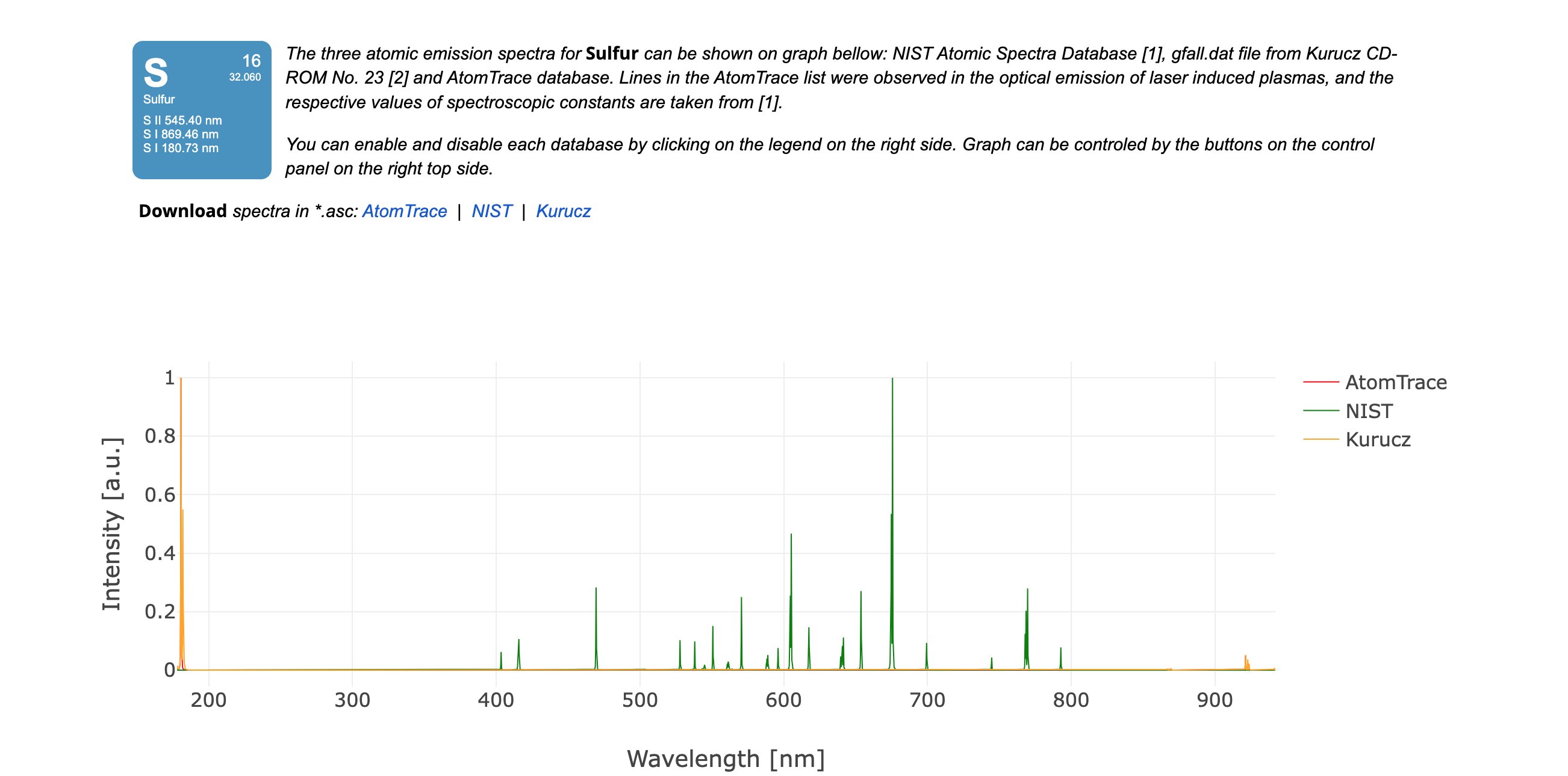

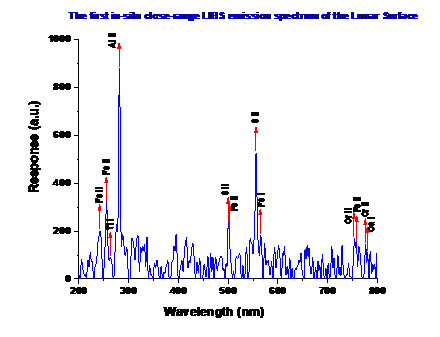

While we wait for more details, here are a few comments, why this may be a major item..
Ref: LIBS confirms the presence of Sulphur (S) on the lunar surface through unambiguous in-situ measurements
August 28, 2023
The Laser-Induced Breakdown Spectroscopy (LIBS) instrument onboard Chandrayaan-3 Rover has made the first-ever in-situ measurements on the elemental composition of the lunar surface near the south pole. These in-situ measurements confirm the presence of Sulphur (S) in the region unambiguously, something that was not feasible by the instruments onboard the orbiters.
LIBS is a scientific technique that analyzes the composition of materials by exposing them to intense laser pulses. A high-energy laser pulse is focused onto the surface of a material, such as a rock or soil. The laser pulse generates an extremely hot and localized plasma. The collected plasma light is spectrally resolved and detected by detectors such as Charge Coupled Devices. Since each element emits a characteristic set of wavelengths of light when it's in a plasma state, the elemental composition of the material is determined.
Preliminary analyses, graphically represented, have unveiled the presence of Aluminum (Al), Sulphur (S), Calcium (Ca), Iron (Fe), Chromium (Cr), and Titanium (Ti) on the lunar surface. Further measurements have revealed the presence of manganese (Mn), silicon (Si), and oxygen (O). Thorough investigation regarding the presence of Hydrogen is underway.
Image..
==> The LIBS technique involves analyzing materials using powerful laser pulses.
A concentrated laser pulse hits a material's surface, creating plasma. This plasma's emitted light is then captured and analyzed, with each element producing specific wavelengths in this state.
By identifying these wavelengths, the elemental makeup of the material is revealed
==> Finding deposits of sulfur near the south pole of the Moon, has interesting implications for our understanding of the Moon's past and its potential for the presence of water ice.
Few points :
-- Volcanic Activity: Sulfur is commonly associated with volcanic activity. If sulfur deposits were found, it might suggest that there were volcanic eruptions in the Moon's history that brought sulfur to the surface. This information could help us better understand the Moon's geological history and the processes that have shaped its surface over time.
-- Water Ice: The presence of sulfur might also have implications for the potential presence of water ice. The Moon's polar regions are of great interest because they are believed to have regions of permanently shadowed craters where temperatures are extremely cold. These areas could serve as "cold traps" for volatile compounds like water ice, which would be stable in these conditions. If sulfur deposits were found in close proximity to areas of potential water ice, it could provide clues about the interactions between volatile compounds and the Moon's surface.
-- Astrophysical Insights: The presence of sulfur could also provide information about the sources of material that impacted the Moon. Analyzing the composition of lunar materials can offer insights into the sources of material that have bombarded the Moon over its history, which can contribute to our understanding of the broader solar system and its formation.
-- Cutting/pasting

Amber G. wrote: 30 Aug 2023 00:02 Image
The interrogation is in the UV/ visible/ near IR range, which means the method is identifying electronic transition energies, not vibe-rotational?
Posts: 6662
Re: Chandrayaan 3: Launch and Discussions
IR is too low energy for orbital transition and is likely solely vibrational. I can’t think of elements or compounds that have an IR emissivity when irradiated by visible light, akin to the Stokes shift. Must be examples.

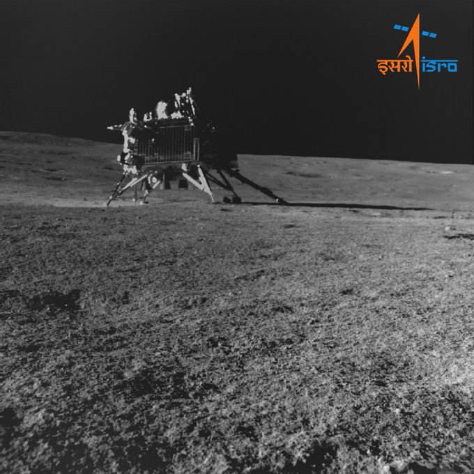

Here we go! A picture of the lander taken by the rover -- at last!
https://twitter.com/isro/status/1696792992718442558

sanjaykumar wrote: 30 Aug 2023 09:05 IR is too low energy for orbital transition and is likely solely vibrational. I can’t think of elements or compounds that have an IR emissivity when irradiated by visible light, akin to the Stokes shift. Must be examples.
No, I think the method relies on generating plasma where pretty much all components are in elemental state, and then identifying electronic orbital transitions as the plasma cools back down (and electrons cascade to lower orbits). So it's not actually looking for vibe-rotational bands as in water or water vapor, but flashing the water (if any exists - probably the wrong technical term here) to elemental hydrogen and oxygen and then looking for transitions in these elemental states. The oxygen probably came from metal oxides rather than water, which is why oxygen was found, but not hydrogen.
From the chart, it seems the IR transitions occur for heavier elements like Cr - makes sense, since electronic orbitals would be closer spaced in heavier elements, hence lower energy differentials (i.e. - leads to lines in the near IR range).

https://twitter.com/isro/status/1696906614194807178
Beyond Borders, Across Moonscapes:
India's Majesty knows no bounds!.
Once more, co-traveller Pragyan captures Vikram in a Snap!
This iconic snap was taken today around 11 am IST from about 15 m.
The data from the NavCams is processed by SAC/ISRO, Ahmedabad.

That photograph makes it clear that attitude control was critical in the mission. I did not see any data display, accelerometers or star backgrounds, during de orbiting. Or was it included in the graphic of the lander as the most intuitive representation?

sudarshan wrote: 30 Aug 2023 05:46
FWIW: Did those atomic spectrums 50 years ago (before lasers)..:)
Here is S --
(Find all not so prominent lines, say here:https://physics.nist.gov/PhysRefData/Ha ... table2.htm
Or https://www.atomtrace.com/elements-data ... nt/16#NIST

Vikram picture shows the amount of light available due to low Sun Elevation.
