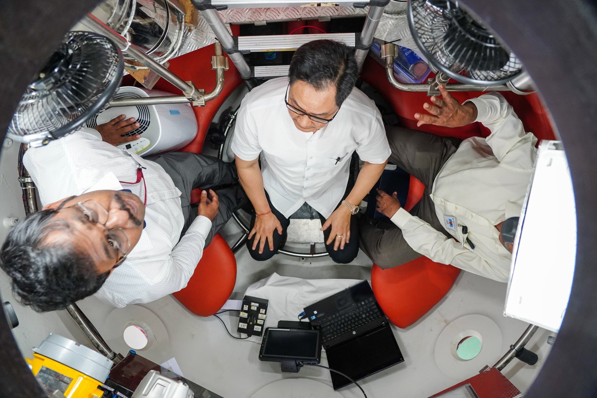

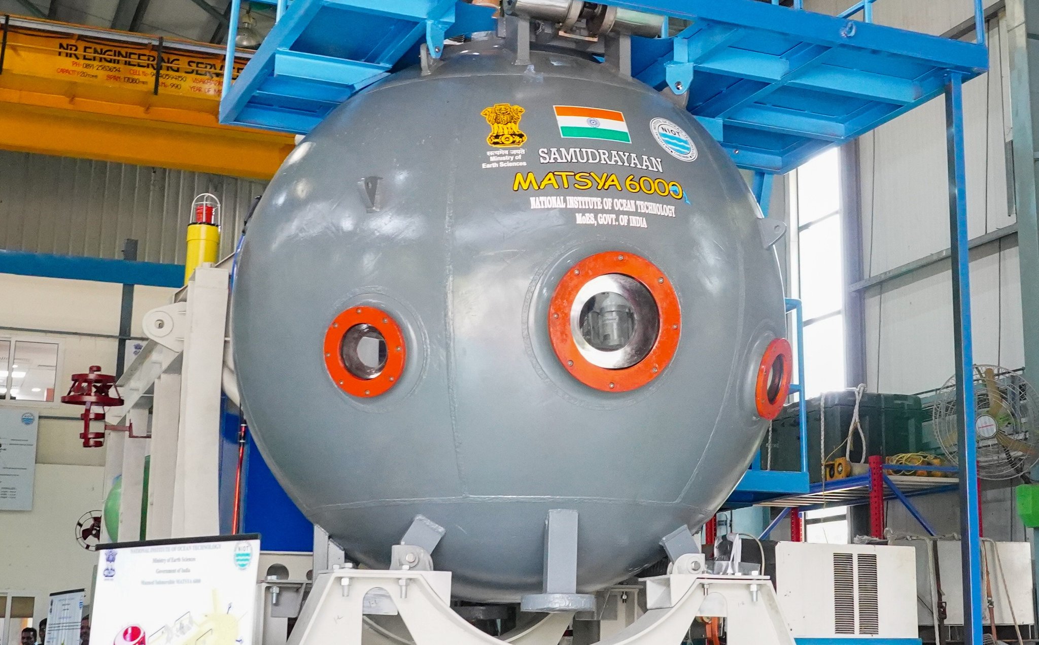

This is 'MATSYA 6000' submersible under construction at National Institute of Ocean Technology at Chennai. India’s first manned Deep Ocean Mission ‘Samudrayaan’ plans to send 3 humans in 6-km ocean depth in a submersible, to study the deep sea resources and biodiversity assessment. The project will not disturb the ocean ecosystem. The Deep Ocean Mission supports the 'Blue Economy' vision of PM @narendramodi
ji, and envisages sustainable utilization of ocean resources for economic growth of the country, improve livelihoods and jobs, and preserve ocean ecosystem health.

At a depth of 6,000 metres, the weight of water would be nearly 600 times that at sea level which make the pressurised hull the most important component of the submersible.
At present, NIOT has made multiple, prototype steel hulls into which personnel can climb into, one at a time, and test the necessary instruments to steer the vehicle. While strong, steel is heavy and the corrosion from marine environments means unsuitable for long-term research and hence the material of choice for submersibles globally is titanium alloy.
At present, NIOT has made multiple, prototype steel hulls into which personnel can climb into.
At present, NIOT has made multiple, prototype steel hulls into which personnel can climb into. | Photo Credit: R. Ravindran
However, no commercial fabricators in India were capable of fashioning such a titanium hull, until the NIOT found an ally in ISRO.
Two hemispheres of titanium alloy have to be fused to create a single hull becoming thus the only barrier between the inhabitants of the submersible and the crushing water columns, but at the same time be no more than 80 millimetre thick – to be relatively light, manoeuvrable and eke out a few more precious inches of space for the crew.
“Only ISRO here can make this. We will have two such hulls manufactured and that we hope will be sufficient for our research and exploratory programmes for many decades,” said Dr. Ramadass. By early 2024, NIOT is expected to undertake a 500-metre exploratory dive in the titanium sphere and a few more at greater depths prior to the main mission.
About 60% of the submersible, said Dr. Sathianarayanan, was manufactured in India. These mainly comprise the external frame, ballasts and pressurised casing. Components such as cameras, sensors, communication systems were bought from international vendors. “The software that details the submersible’s position, movement is developing in-house at NIOT,” he added.
