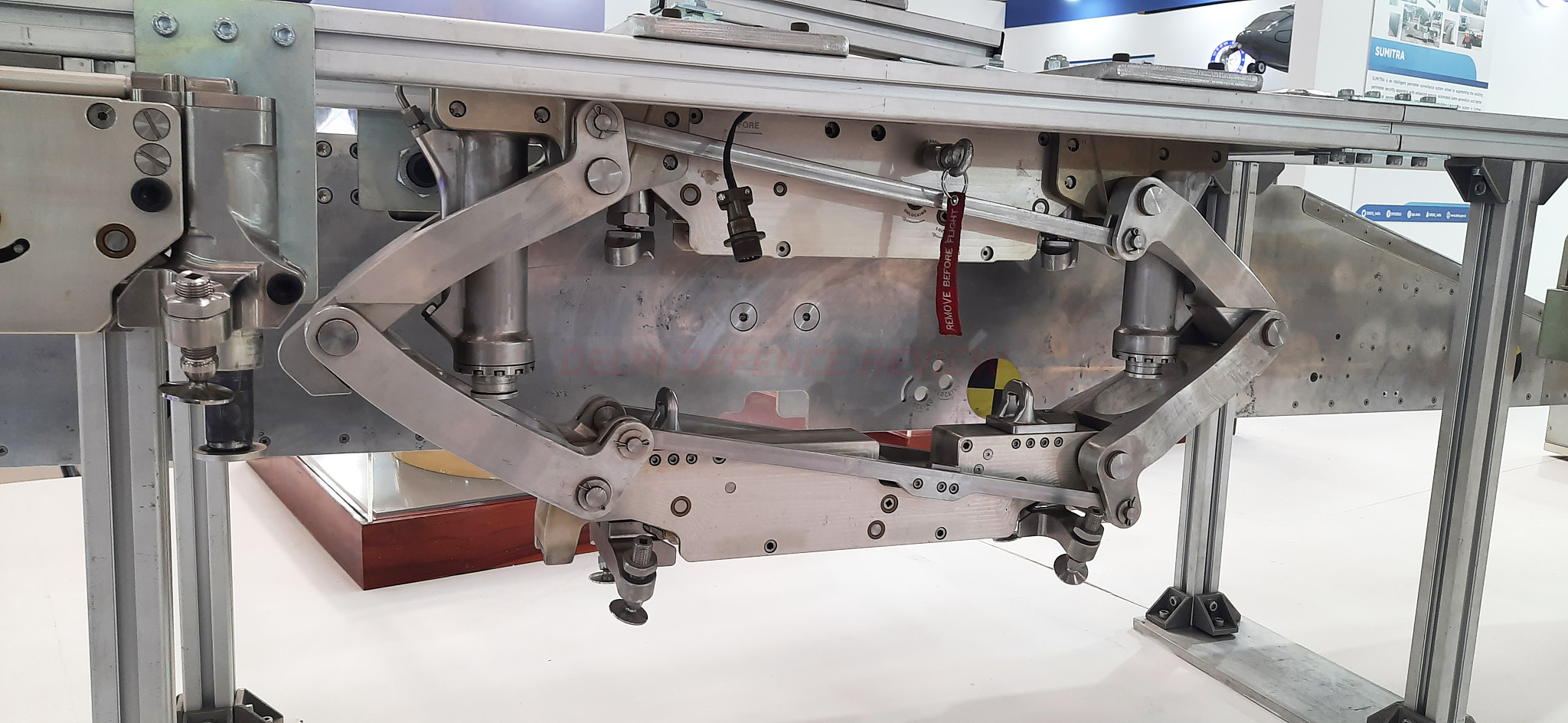

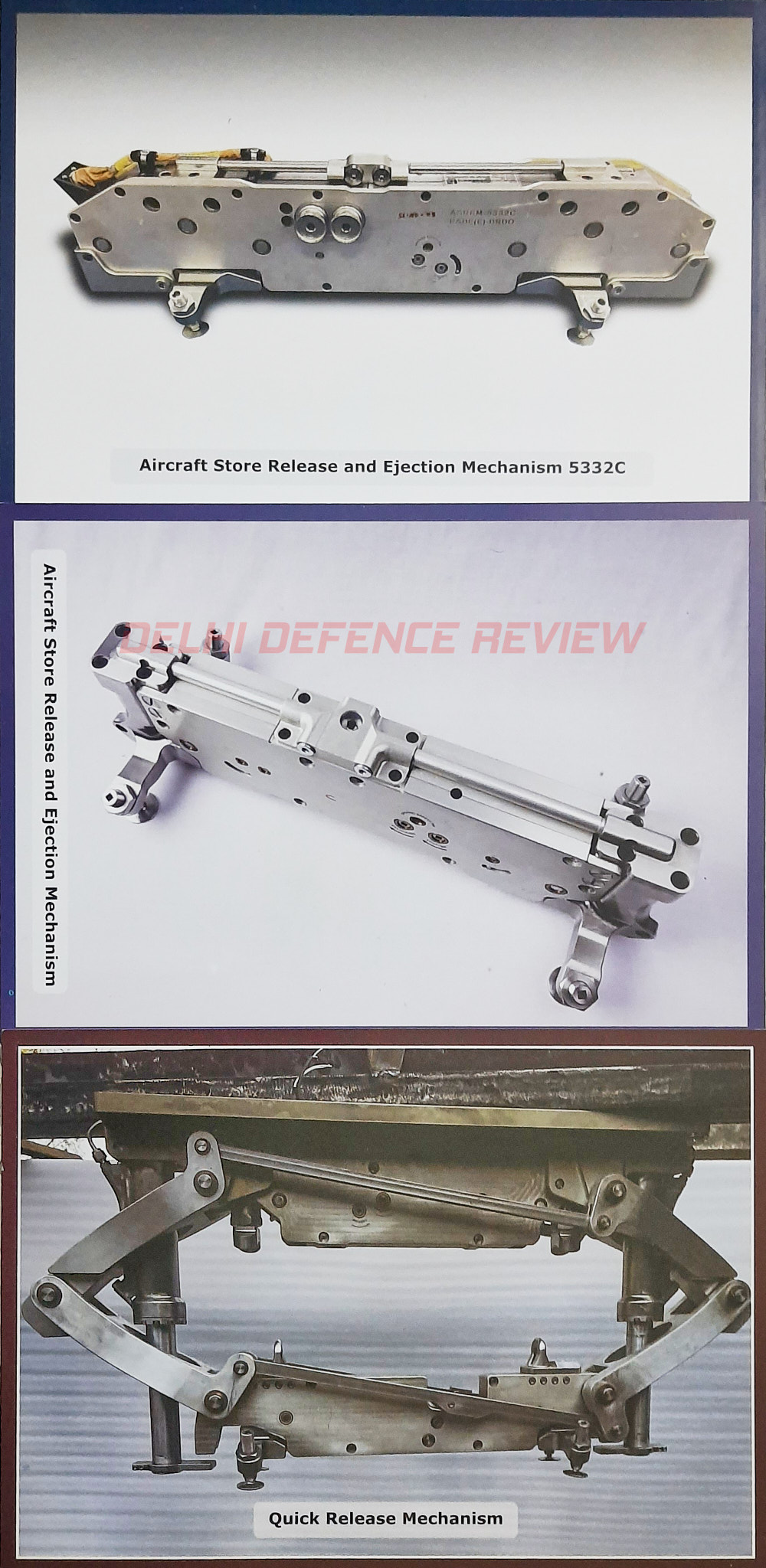

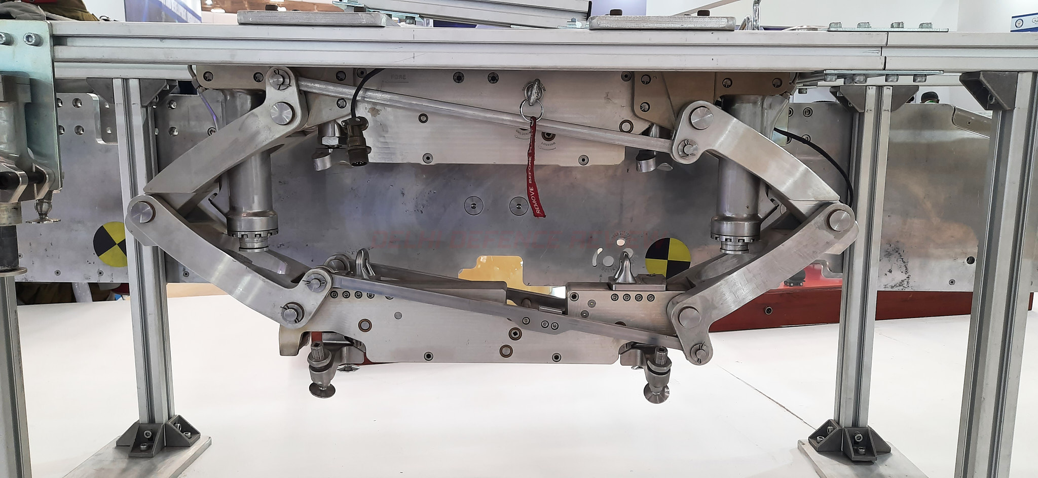

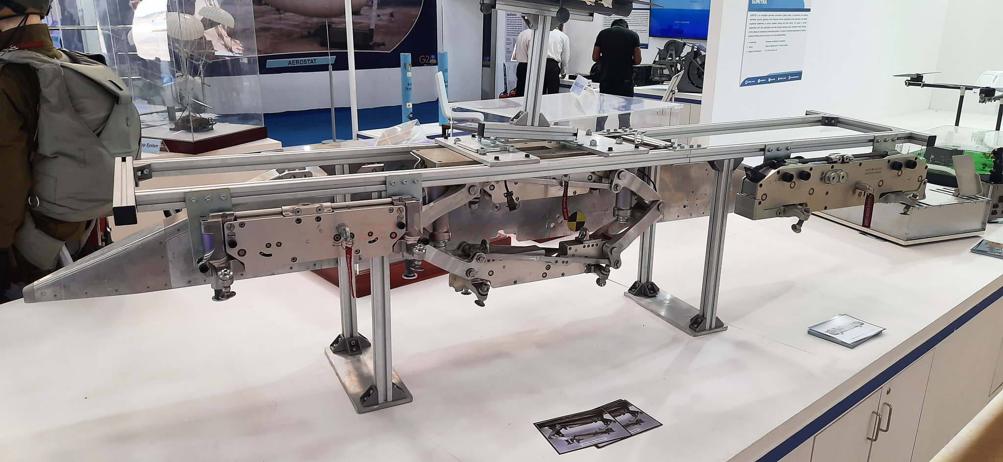

https://twitter.com/delhidefence/status ... 17120?s=20 ---> Store Release & Ejector Mechanisms developed by R&DE(E), DRDO for launching weapons from aircraft.
https://twitter.com/delhidefence/status ... 61280?s=20 ---> Quick Release Mechanism is a launcher for the internal weapons bay, presumably for the Advanced Medium Combat Aircraft AMCA.

https://x.com/SJha1618/status/1764541925120680248?s=20 ---> For the umpteenth time, a plane cannot fly or even be prototyped if no funds have been sanctioned for it. So, this talk of what Korea is doing or Turkey is doing is meaningless till such time the AMCA actually receives sanction for full scale engineering development with the attendant funds being disbursed expeditiously.
