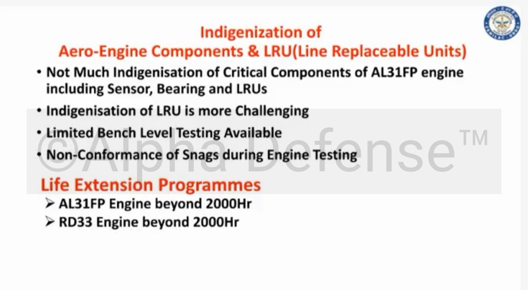

maitya
Posts: 871
Joined: 02 Feb 2001 12:31
Post by maitya »
Rakesh wrote: 16 Jul 2024 00:10 https://x.com/alpha_defense/status/1812460243898818627 ---> The recent delaying tactics from 🇺🇸 Firm General Electric should be sufficient for officials in PMO, MoD, IAF, GTRE and HAL to kick start the 𝗟𝗶𝗳𝗲 𝗘𝘅𝘁𝗲𝗻𝘀𝗶𝗼𝗻 𝗣𝗿𝗼𝗴𝗿𝗮𝗺 𝗼𝗳 𝗥𝗗-𝟯𝟯 engines with 𝗵𝗶𝗴𝗵𝗲𝗿 𝗹𝗲𝘃𝗲𝗹 𝗼𝗳 𝗶𝗻𝗱𝗶𝗴𝗲𝗻𝗶𝘇𝗮𝘁𝗶𝗼𝗻. The proposal has already been sent to the MoD.
I'm confused ... how is life extension of AL-31F or RD-33 TFs linked to F404 delays wrt the LCA program.
If somebody is getting any thoughts about MK1A etc being powered by RD-33 (AL-31F etc won't fit) etc, then a much larger (multi-year) dedicated program would be required, along-with OEM deep involvement.
For import-bahadurs like us, much easier would be go get some ready-made F404-402s from either US or other global operators themselves and band-aid the current impasse - should keep everybody happy.
That doesn't ofcourse mean we shouldn't ask for greater indigenous content, more specifically in the critical subsystems like both HPT and LPT (Blades, Vanes, and Discs), HPCs, Combustor, Shafts etc of these 2 TFs.
Technologically, there're no LRUs or subsystems in these two TFs, that can't be designed and manufactured indigenously - i.e. both manufacturing technology and the raw-material processing technology for all LRUs and subsystems of them, exists indigenously.
The only challenge, apart from contractual/IP violation, may be the volume-demand, to make them economically viable.
In fact, it's well within GTREs reach to design and implement an "updgrade" of both of these TFs - but will however require quite a bit of effort, schedule and cost to do so.
But then again, achieving "true self-sufficiency" in nether easy nor cheap.
Of course, fact remains, when the original contracts for the so-called ToTs for them were negotiated, we should have insisted on the LRU level replacements with indigenously produced (from raw materials) LRUs without voiding the whole warranty etc - now, fat chance of Russians agreeing to any of it though.
So all that will happen, more and more "assembling" (from SKD/CKD kits) of LRUs and Systems and stocking them up, that's about it, really.
Nothing changes ... :((
