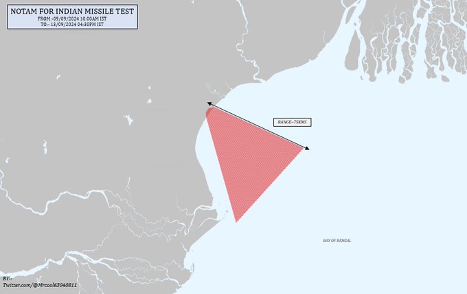

What is this new missile being tested by DRDO? Alpha Defense says it could be a Long Range Attack cruise missile, saying it's got a turbofan (like Nirbhay) but a pointy nose like Russia's Kalibr (apparently the pointy nose helps the missile stay in trans-sonic regime in terminal phase)
Would this missile be for use against China, primarily?

https://x.com/TheHemantRout/status/1834146969033605611
Hemant Kumar Rout
@TheHemantRout
Hemant Kumar Rout
@TheHemantRout
People from 6 villages shifted to temporary shelters for 10 hrs ahead of a missile test from a defence facility off Odisha coast. DRDO is likely to conduct vertical launch of a SAM system. Notam issued for a range of 75 km.
