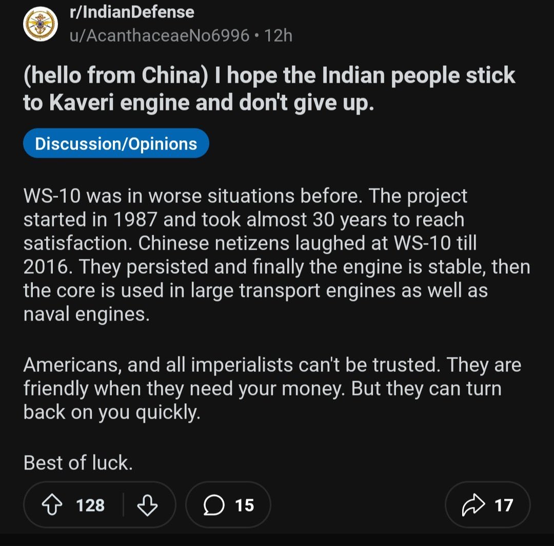

Posts: 23187
Even the Chinese (the enemy) are telling India not to abandon the Kaveri program.
Each and every word below is true. Now I have seen everything. I can die in peace.
https://x.com/livefist/status/1873013628133318754 ---> Someone from China couldn’t take the Indian self-flagellation on Reddit. Wise words, though.

Rakesh wrote: 28 Dec 2024 20:32 Even the Chinese (the enemy) are telling India not to abandon the Kaveri program.
:shock: .. that seriously a Chinese handle ?!.. wonders will never cease
IAF now needs to be told by the Chinese :((
Posts: 36700
drnayar wrote: 28 Dec 2024 22:29
or someone who is trolling us, drnayar ji. The cheen have no love lost for India
