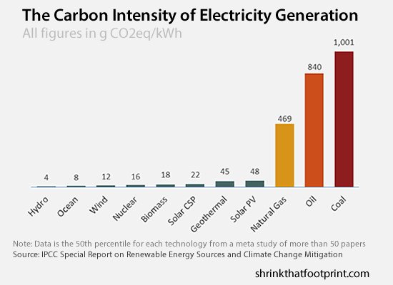

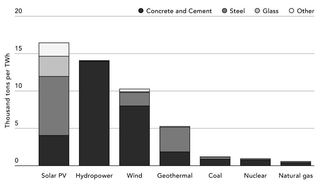

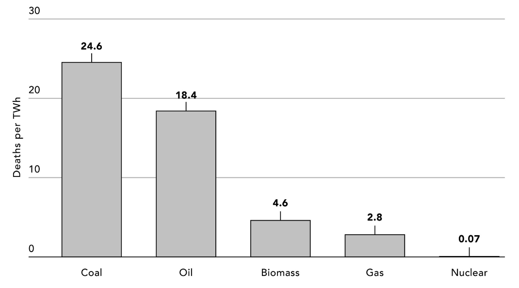

I have posted such data here before but these graphs make as good a case for nuclear as any I have seen :
1. Amount of carbon-intensive material needed for different power plants.
2. Number of deaths by energy source.
3.Carbon intensity .
(Image credit: Bill Gates and other well known sources)
