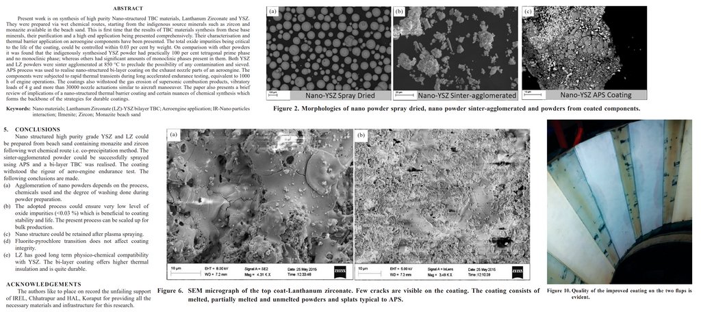

DRDO has assembled and validated the bi-layer YSZ-LZ coated flaps in an aero-engine

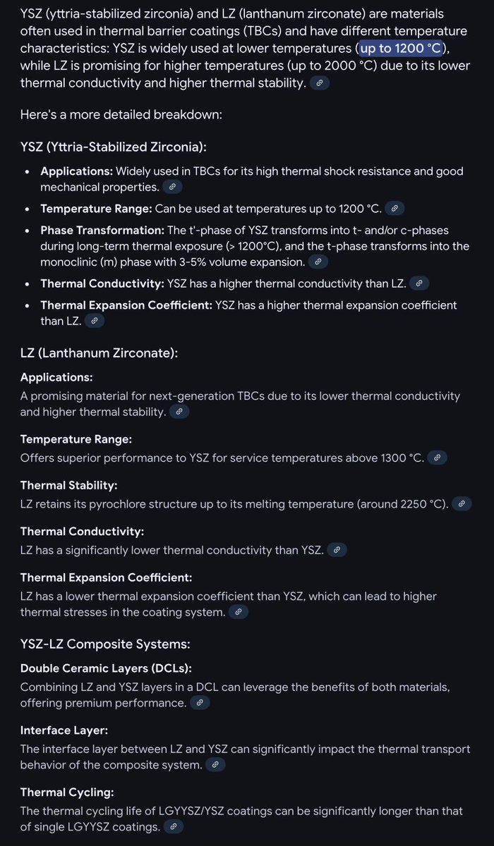

Atmanirbharta Bhakt
@MacaulaysMonkey
Gemini provided a pretty good description.
https://x.com/MacaulaysMonkey/status/19 ... 2567146606
maitya
Posts: 866
Joined: 02 Feb 2001 12:31
Post by maitya »
uddu wrote: 31 Mar 2025 11:57 https://idrw.org/lt-proposes-indigenous ... over-cost/
shreedhar singh
@shreedharsingh9
Atmanirbharta Bhakt
@MacaulaysMonkey
LZ coats, in practical applications, will not survive beyond 1450deg C ... something called CMAS attack, refer to my TBC series of posts - part 4 (of that series) delves into this aspect.
Also there are various types of YSZ like - PSZ and FSZ etc. For example, the so-called advantages of LZ, is possble via FSZ as well.
In fact, LZ coats are not suitable for high-rm rotor surfaces etc ... all details in that post series.
