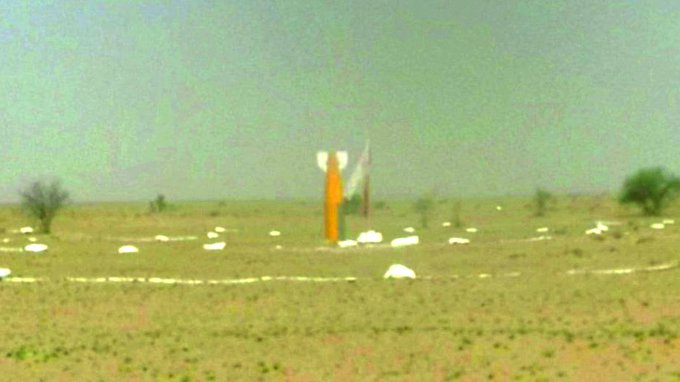

The May 24 test of
@DRDO_India
developed 500-kg class Inertial Guided Bomb (IGB) is significant. Assuming a satnav position update capability, such a bomb could, if well implemented, achieve Spice 2000 precision against a visually obscured target at a significantly lower cost

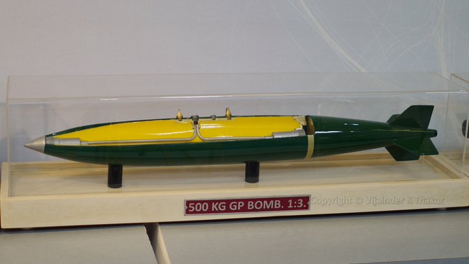

500-kg class bombs - guided or unguided - are variants of the 450-kg High Speed Low Drag (HSLD) bomb displayed at #AI2017
Vijainder K Thakur
@vkthakur
The variants include the 500-kg GP bomb & the 500-kg PG HSLD bomb. The HSLD bomb also serves as the warhead for the Griffin LG kit.

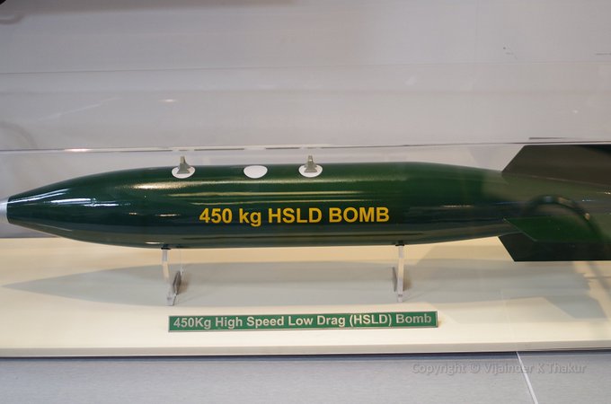

@DRDO_India
has similarly developed a family of bombs around its 250-kg HSLD. SAAW most likely belongs to that family of weapons.

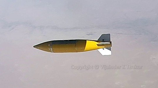

The ability of the IGB to fly near horizontally after separation from its pylon suggests a good range that would vary with the speed and height of the releasing aircraft.

The vertical strike by the weapon could suggest a capability to program flight path as is the case with the Spice kit.

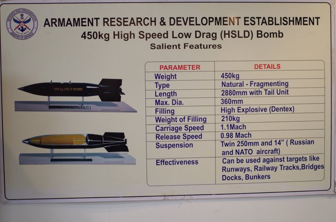

The specifications of the 450-kg HSLD bomb / warhead as displayed at #AI2017

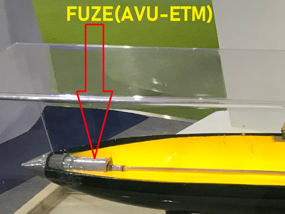

Most significant is the fuze system for air-delivered bombs. Earlier IAF sued to get Russian versions.
Since this is TBRL its reliability will be in the high 90s.
See the inset diagram. The nose plug initiates(probably a piezo-electric signal generator) the precursor charge and the follow-through warhead in the tail or aft. That means this is a precision fuze with timing delays. An example of MUNITRONICS.
