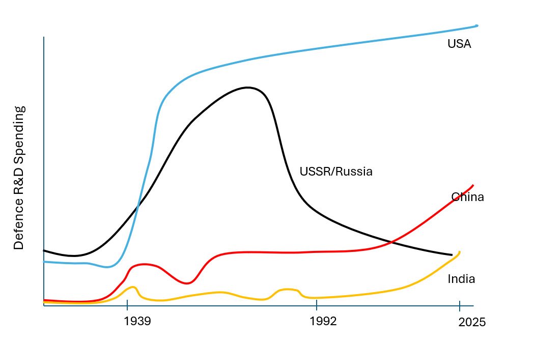

https://x.com/cvkrishnan/status/1925762951706714133 ---> I thought Indian defence discussions, after some initial immaturity would move beyond the, “will GE share us its core engine technology?” , “will Dassault share source codes for its jet?” “Will Naval Group provide its sub data tables?” And now these post Balakot and post Sindhoor, defence aficionados have also picked this up. When did getting access to a foreign developed tech become an entitlement, Just because one pays money? You think R&D and IP creation is a simple process of pouring money and getting results? It takes creating an ecosystem. Identifying talents bringing them together trying a 100 & 1000 things and their failures persisting through and getting the elusive tech. In this, they’ve spent their political capital and their nation’s resources away from stuff.
While we spend on public welfare and later Come up with few Billion$$ and expect those nations to give it away for money? “We are a huge market, they will have to acquiesce” is a weird entitlement. This is not just with the armed forces but DRDO too. While trying to sell a proprietary code for commercial use, as a sense of entitlement they’ll ask underlying equations which are trade secrets. I mean “LOL” are we idiots? These efforts are the sum of generations of research built on top of each other. A previous research would contribute to “what to do” or “what not to do” in this research. R&D in Rafale came out of R&D in Mirages. It was not 0 —> 1.
It is a kind of a weird combo of national laziness and a sense of entitlement that we do not want to do these hard steps to develop own ecosystem but expect other nations to give it for money. Get off your high horse. If we are worth the civilizational state and regional power we claim we are then damn well invest in national R&D. No civilization/nation state is entitled to greatness. It has to work to earn that technological dominance and ownership to build it across national power. Ask our leaders, not the foreign OEMs.

India needs its own testing facilities for aircraft engines. ISRO has such facilities for rockets in Mahendragiri. Babus have been stalling on funding such testing facilities since it costs a lot of money.
For Modiji, the simple formula for all defence, ISRO, BARC funding: 10 x R&D funds over the remaining term. These funds are well worth the investment. We are #4 in nominal GDP, very soon going to be #3. We all know how piss poor China maal is in defence sector from actual usage and China is #2.

bala wrote: 27 May 2025 20:12 India needs its own testing facilities for aircraft engines. ISRO has such facilities for rockets in Mahendragiri. Babus have been stalling on funding such testing facilities since it costs a lot of money.
They have that facility built in Rajanukunte, KA (https://eparlib.nic.in/bitstream/123456 ... /36494.pdf). This is for all the different types of ground testing. The missing piece in the puzzle is the hight altitude test bed. As mentioned above, it was never about funding but national will.
