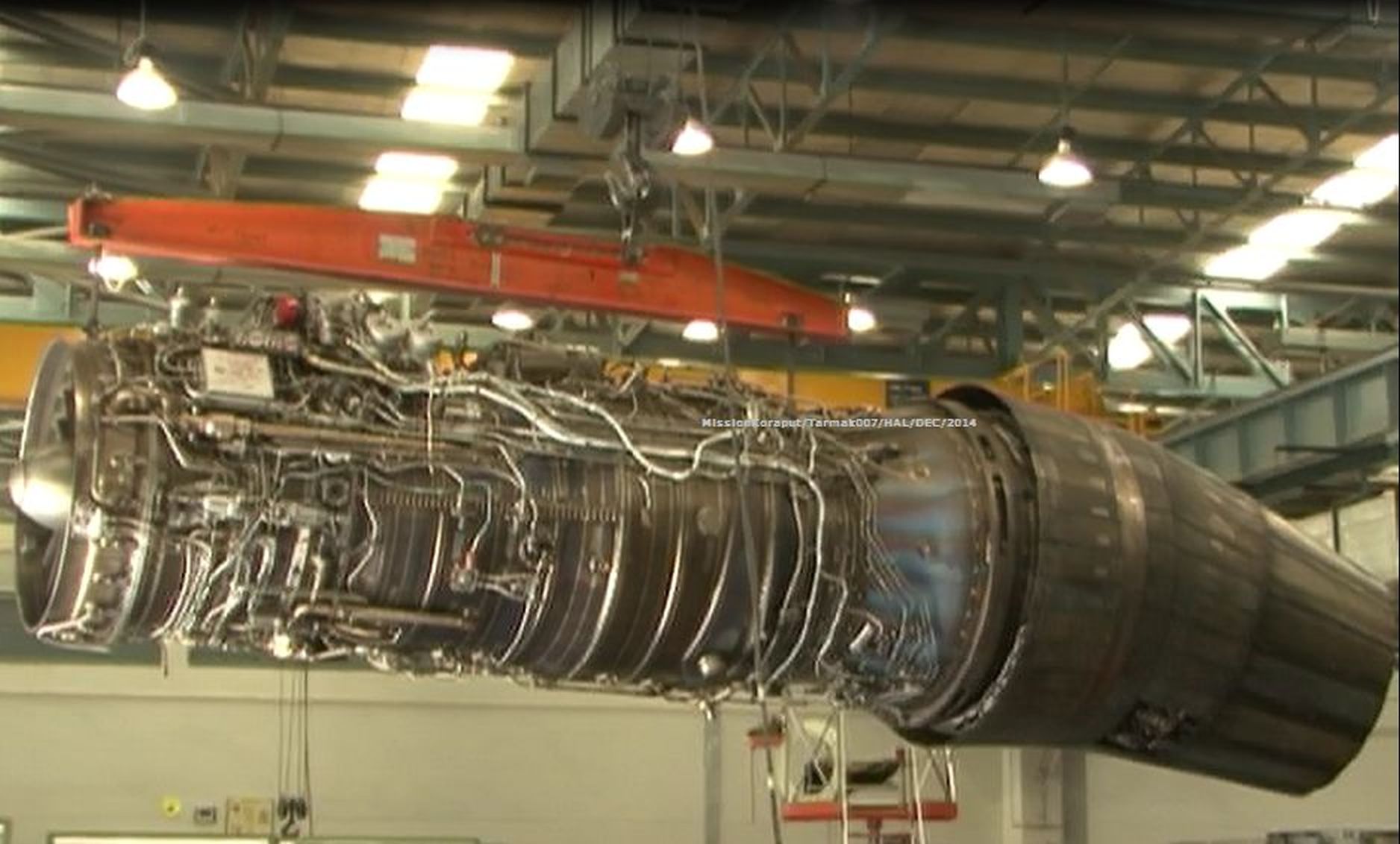

Posts: 5566
Rakesh wrote: 25 Jun 2025 20:28 https://x.com/Ray70409890/status/1937456087147675974 ---> All the 237 castings and 919 forgings of the AL-31FP turbofan have been indigenised and are made from raw material. 136 numbers of critical heavy forgings like turbine discs are imported due to absence of 20k ton forging press. All the 2,819 numbers of sheet metal, machine components, pipelines are made here.
https://x.com/Ray70409890/status/1937458368609943934 ---> Out of 129 non metallic components, 45 have been indigenised so far. 23 of the 58 LRU are now made here in India. 484 out of 815 spares needed for AL-31FP are made here by HAL and other MSME. 1385 lines of raw materials are required for maintenance of the AL-31FP turbofan. 399 lines have been indigenised.
This is what the Tejas should've been designed around once they found out shortages in thrust...

Posts: 14774
ritesh wrote: 11 Jul 2025 09:40
But, isn't both belongs to different class?
To make the point further a Mahindra Scorpio 2.2 Ltr Diesel will never fit in a Maruti 800 no matter what you do, we could try to get the M-53 , RD-33 Engines in Tejas - it will take a few years. All these take money and resources and Surplus orders which we are loathe to do. And this at a time when the import lobby was waiting for 1 crash to cancel the Tejas. At that time the Russians did not want to have an indigenous fighter and hence never helped in even integrating R-73 missiles on the fighter, the French were similar in attitude and saw us as long term cash cows. USA did not believe we can build something competitive outside their ecosystem unlike say Gripen, South Korea KF 21, which uses thier FBW, Radar, Weapons etc. Only when we were getting serious the US started delaying supplies. So I can understand the historical decisions. Russia is still not fully cooperating with Testing results for Kaveri Derivative engines. The French also seem less than enthusiastic and still behind the scenes pushing for MMRCA.
It like when it rains heavily it floods in Japan, China, USA, Germany, UK but we Indians should be ashamed for a few hours while the water drains absorbs in India.
Ideally we should be doing it over the last few years now that the GE is showing us the middle finger trying to see if M-53, RD 33 Fit- easier said than done and if we could get is flying in the LCA Tejas were reliable enough, Had low enough fuel consumption and low enough MTBF. Our experience with RD 33 engines in the late 80's/ 90s were terrible.
