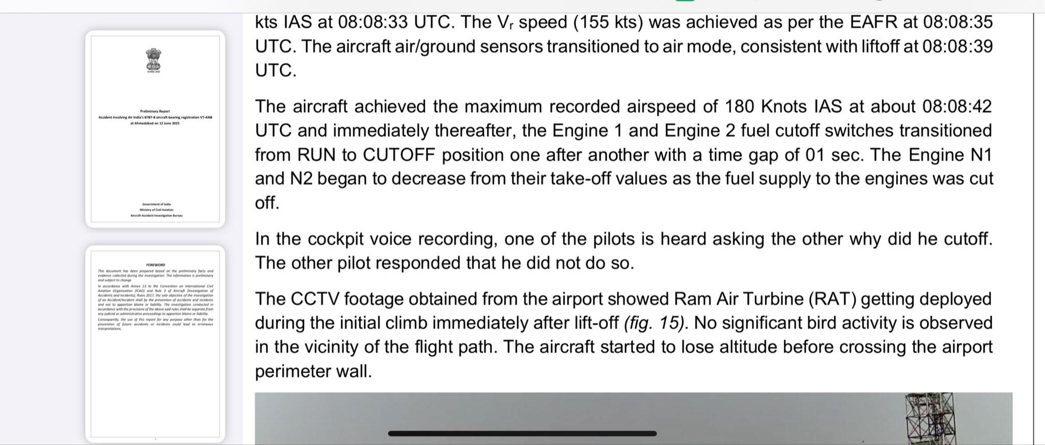

"As per the EAFR data, the aircraft crossed the take-off decision speed V1 and achieved 153
kts IAS at 08:08:33 UTC. The Vr speed (155 kts) was achieved as per the EAFR at 08:08:35
UTC. The aircraft air/ground sensors transitioned to air mode, consistent with liftoff at 08:08:39
UTC.
The aircraft achieved the maximum recorded airspeed of 180 Knots IAS at about 08:08:42
UTC and immediately thereafter, the Engine 1 and Engine 2 fuel cutoff switches transitioned
from RUN to CUTOFF position one after another with a time gap of 01 sec. The Engine N1
and N2 began to decrease from their take-off values as the fuel supply to the engines was cut
off.
In the cockpit voice recording, one of the pilots is heard asking the other why did he cutoff.
The other pilot responded that he did not do so.
The CCTV footage obtained from the airport showed Ram Air Turbine (RAT) getting deployed
during the initial climb immediately after lift-off (fig. 15). No significant bird activity is observed
in the vicinity of the flight path. The aircraft started to lose altitude before crossing the airport
perimeter wall.
As per the EAFR data both engines N2 values passed below minimum idle speed, and the
RAT hydraulic pump began supplying hydraulic power at about 08:08:47 UTC.

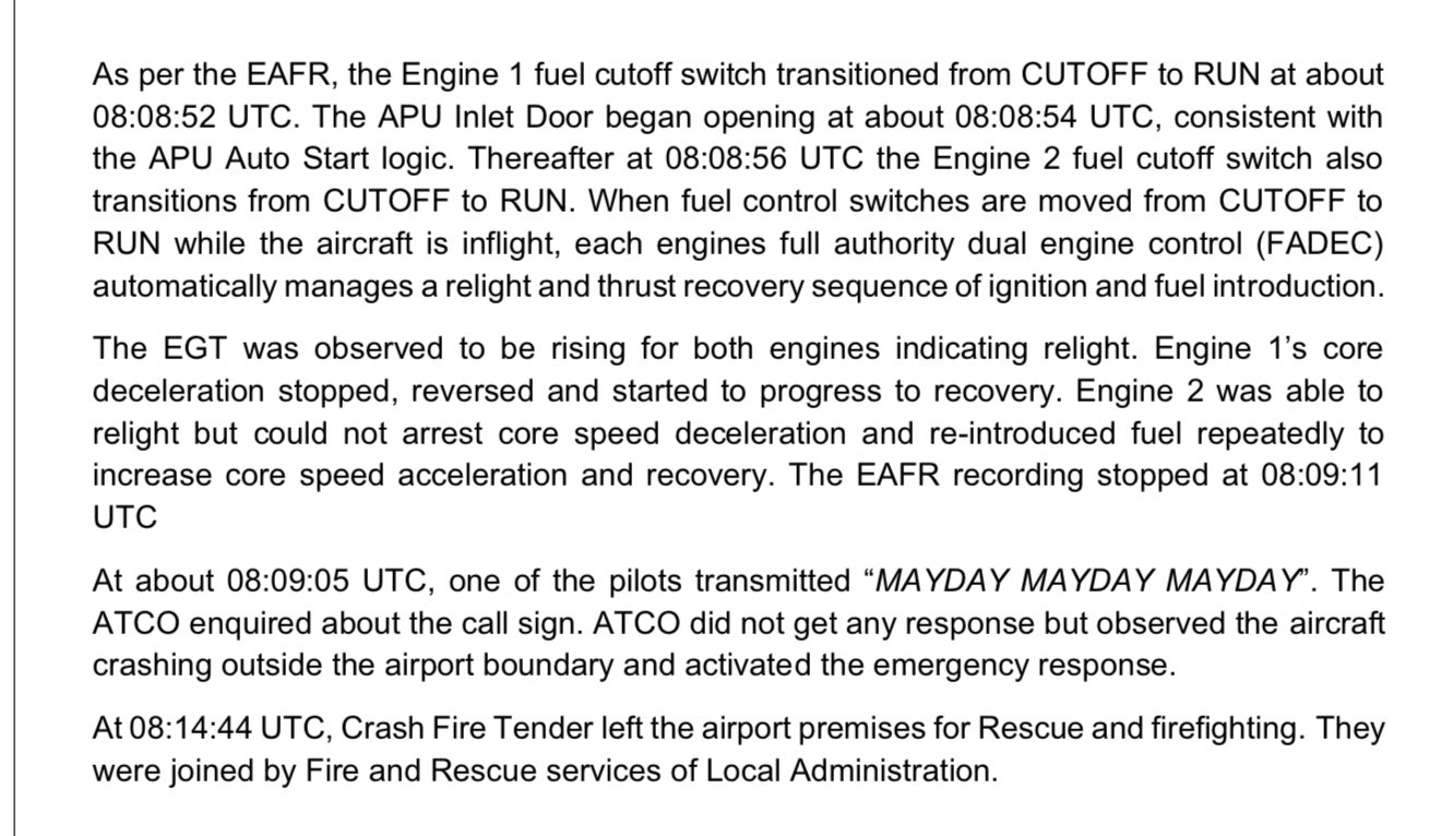

As per the EAFR, the Engine 1 fuel cutoff switch transitioned from CUTOFF to RUN at about
08:08:52 UTC. The APU Inlet Door began opening at about 08:08:54 UTC, consistent with
the APU Auto Start logic. Thereafter at 08:08:56 UTC the Engine 2 fuel cutoff switch also
transitions from CUTOFF to RUN. When fuel control switches are moved from CUTOFF to
RUN while the aircraft is inflight, each engines full authority dual engine control (FADEC)
automatically manages a relight and thrust recovery sequence of ignition and fuel introduction.
The EGT was observed to be rising for both engines indicating relight. Engine 1’s core
deceleration stopped, reversed and started to progress to recovery. Engine 2 was able to
relight but could not arrest core speed deceleration and re-introduced fuel repeatedly to
increase core speed acceleration and recovery. The EAFR recording stopped at 08:09:11
UTC
At about 08:09:05 UTC, one of the pilots transmitted “MAYDAY MAYDAY MAYDAY”. The
ATCO enquired about the call sign. ATCO did not get any response but observed the aircraft
crashing outside the airport boundary and activated the emergency response

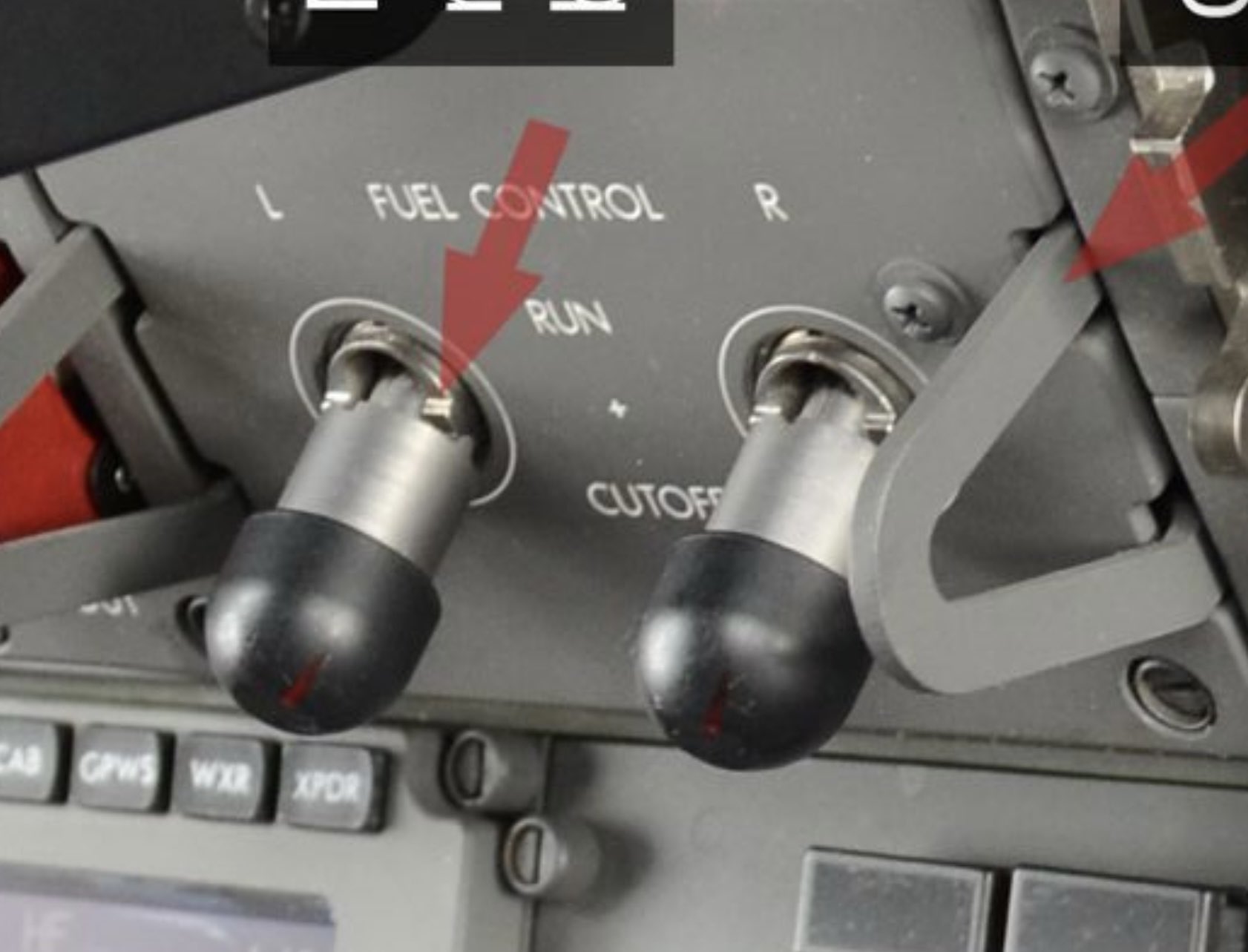

From retired IAF pilot Augustine Vinod,
https://x.com/mjavinod/status/194392509 ... Bf-9w&s=19
LET ME ASK THIS QUESTION TO ALL YOU INTELLIGENT BEINGS OUT THERE
Can you move TWO switches, which has three distinctive actions to switch it on or off?
WITHIN 1 SECOND ?
CAN YOU?
ANSWER ME
This is the position of the hands of both pilots when allegedly, fuel cut off switches went off within one second of each other.
Anyone who believes that it was done by pilots, need to get their head examined
Ramana in X,
https://x.com/ramana_brf/status/1943876 ... IqQMw&s=19
What did you find confusing?

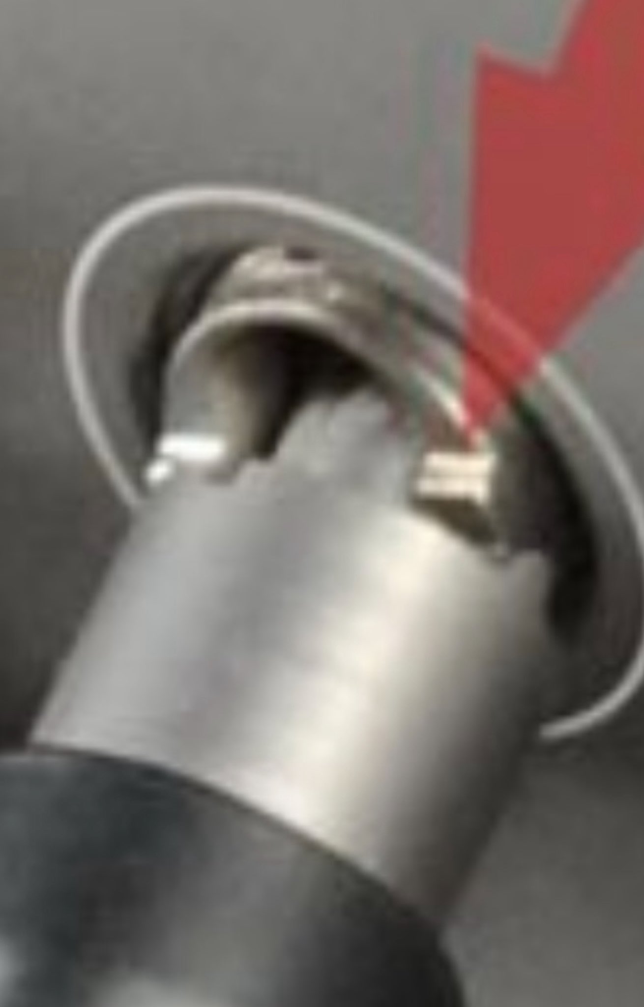

The fuel switch cutoff is a latent defect. FAA erred in issuing a SIAB instead of an AD. SIAB is an advisory while AD is mandatory.
Knowing the high consequence of a twin engine failure both FAA and Boeing erred.

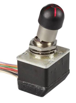

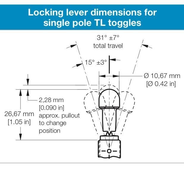

Here is a closeup of the Honeywell manufactured switch in question & the schematic of how it has to be lifted by 2.28 mm. It would require at least 5 deliberate actions to cut off fuel to both engines
The crucial part. It says the fuel control SWITCH TRANSITIONED (Not that the fuel cut off automatically, which happened in response to the switch transitioning). The switch can’t automatically transition. It has a hard metal gate - it has to first be pulled up & then moved
A pilot has made a video and posted on reddit of him moving both switches to off position one after another and it took no more than 2 seconds. Now if someone wants to do it in a hurry and grabs both switches at once then it is possible to move them simultaneously to cutoff in a second.
As for the FAA SAIB-NM-18-33, nowhere does it mention switches moving to cutoff position by itself during operation! If that were to be the case, all Boeings with similar switches would have been grounded immediately! It is an advisory that says the Boeing Company received reports from operators of Model 737 airplanes that the fuel control switches were installed with the locking feature disengaged. Each switch is controlled independently with built in redundancy, both engine switches cannot move to cutoff positions unless they are physically moved, lock or no lock!

Thanks. But these situations, warrant 2 step process with "Are you sure?" type question for engine shut off.

The Boeing Company (Boeing) received reports from operators of Model 737 airplanes that the fuel control switches were installed with the locking feature disengaged. The fuel control switches (or engine start switches) are installed on the control stand in the flight deck and used by the pilot to
supply or cutoff fuel to the engines. The fuel control switch has a locking feature to prevent inadvertent operation that could result in unintended switch movement between the fuel supply and fuel cutoff positions. In order to move the switch from one position to the other under the condition
where the locking feature is engaged, it is necessary for the pilot to lift the switch up while transitioning the switch position. If the locking feature is disengaged, the switch can be moved between the two positions without lifting the switch during transition, and the switch would be exposed to the potential of inadvertent operation. Inadvertent operation of the switch could result in an unintended consequence, such as an in-flight engine shutdown.
The FAA recommends that all owners and operators of the affected airplanes incorporate the following actions at the earliest opportunity:
1) Inspect the locking feature of the fuel control switch to ensure its engagement. While the airplane is on the ground, check whether the fuel control switch can be moved between the two positions without lifting up the switch. If the switch can be moved without lifting it up, the locking feature has been disengaged and the switch should be replaced at the earliest opportunity.
Apparently uel control switch locking mechanism can be disengaged -- it needs to be examined if an engaged locking mechanism can be disengaged.
If so,, what if someone disengaged the locking mechanism?
If this is a valid failure mechanism, only then need we start speculating on who could have caused this disengagement.

bala wrote: 12 Jul 2025 22:16
The two step process is the mechanical process where step1 is to lift the switch toward you and step 2 being toggling it to the desired position.
Posts: 3268
Jay wrote: 12 Jul 2025 23:27 The two step process is the mechanical process where step1 is to lift the switch toward you and step 2 being toggling it to the desired position.
Not sufficient to have mechnical barriers which are easy to operate and override. (If mechanical vibrations can flip it then it is even more dangerous having just mechanical barriers) We need more prevention of such a thing to happen in flight especially. Things like fire in engine can be monitored by sensors and allow for switch off if required by the pilot and even then that must be done in a multi step manner.
Just anecdote: Steve Jobs of Apple Computer Inc. was obsessed with not providing an OFF switch for computers. He initially worked at HP which had computers with built in power fail recovery circuit, i.e. you switch it off or pull the power plug but it does not shown down, requires further steps to bring it to "OFF" condition. In Apple Mac Books the power switch has be kept depressed for some time to reboot the system.
Aircraft engine operation is vital for its flight and having human errors must be minimized to a large degree.

The toggle switch is Honeywell 4TL837-3D.
Datasheet for this and related switches is here:
https://www.mouser.com/datasheet/2/187/ ... 735572.pdf
If one could buy a single instance of it, it is not expensive. Then one could take it apart and satisfy oneself whether the locking mechanism can be disengaged without perceptible damage to the switch.
Unfortunately, it is out of stock at the places where a single instance can be bought. At other places it must be bought in multiples of 50, and likely they won't sell to an individual.
