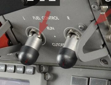

We don’t know if the switch is a physical switch or just one masquerading for a software one. I suspect it’s the latter.
Tanaji saar,
The switches are physical (switch is a two-position 'latching' switch with a physical detent to prevent inadvertent operation-- see red arrow in picture showing the detent) and the physically selected position of either "run" or "cutoff" is electrically sensed and recorded with time stamp by the flight data recorder
Ultimately, it is an electrical signal that is sent by this fuel cutoff switch(es) (when selected to the cutoff position) to the spar fuel valve(s) that cuts off fuel supply to the selected engine(s), and causing either one or both engines to shut down immediately

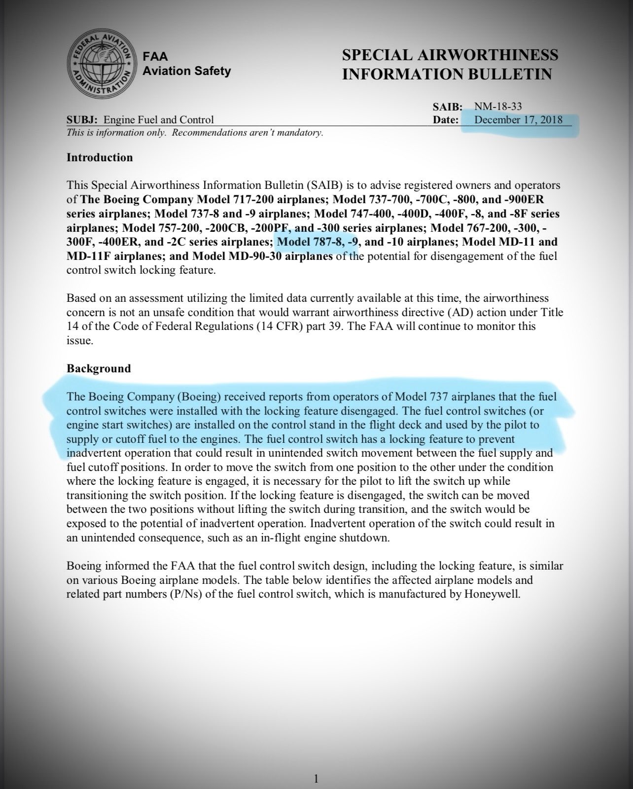

This 2018 FAA bulletin (SAIB NM-18-33) warns of a flaw in fuel control switches on Boeing models like 737 MAX, 787, etc. The locking mechanism can disengage, risking accidental engine shutdown mid-flight if a pilot bumps it. It's advisory, not mandatory—recommends inspections and replacements. Tied to recent Air India 787 crash probe, but no proven link yet. Boeing's fix: upgraded switches.
Posts: 3286
The above is a advisory and not mandatory because you may accidentally "bump" into one of the switches but not both which have independent controls. A pilot has made a video of him cutting off the engines by operating one switch after another and you can watch for yourself and see how likely it is for an experienced pilot to accidentally cut off both engines at the same time.

Ambar wrote: 13 Jul 2025 19:30 The above is a advisory and not mandatory because you may accidentally "bump" into one of the switches but not both which have independent controls.
I am questioning why Boeing didn't make into an AD, i.e. directive which is mandatory. The problem seems top be serious enough to warrant a mandatory directive.

Amid Air India probe, US FAA, Boeing notify fuel switch locks are safe, document, sources say
The FAA's notification to Civil Aviation Authorities, seen by Reuters, said: "although the fuel control switch design, including the locking feature, is similar on various Boeing airplane models, the FAA does not consider this issue to be an unsafe condition that would warrant an Airworthiness Directive on any Boeing airplane models, including the Model 787."

vera_k wrote: 14 Jul 2025 01:21
It is quite possible that someone at FAA called this incorrectly. I am still at a loss as to why and how the locking mechanism can be disabled. Whether a pilot can cutoff both within a second accidentally is besides the point. I am inclined to believe that this is a red herring and make way to the accusing one or both the pilots of incompetence at best.

That said, Boeing was wrong in not issuing an AD on the lock disabling installation of the switches.

The DGCA (by July 21) and also Etihad airlines + other airlines have ordered immediate inspections of these fuel switches
The DGCA (Directorate General of Civil Aviation) has ordered Indian airlines to inspect fuel switch locking mechanisms on all Boeing 787 and 737 aircraft by July 21. Etihad Airways, along with other international carriers, has also initiated similar inspections

Reuters reported that Boeing sent letters saying that there is no need to inspect the switches.

The switch position and fuel valve status are normally individually recorded. Cockpit switches are normally wired 0V/open logic. Whether the status is picked up for the EAFR from the wire itself, or from the electronics of the FADEC is unknown. It is highly possible that it is picked up from the electronics. I have seen the design of another LRU where it is done that way.
The 'locking' feature consists of bumps on the switch body and the lever. These are integral parts of the switch components. So, the wording "installed disengaged" is totally and deliberately vague. The only way the switch not having locking is installing the wrong switch part. The switch have a number of options for locking in different positions, and a batch of switches might have been supplied with wrong locking.
It is Boeing. Anything can happen.
But.... Having no lock itself is not critical. The lever doesn't move without considerable force on it. The only way it can move without pilot action in the given scenario is some object falling on it. But it is impossible to escape the attention of pilots. So, we can discount the switch moving on its own. If the switch physically moved, the pilot did it deliberately.
Let us see the possibilities:
1. The pilot actually moved the switch. Is it possible to move both within 1 sec? Answer is yes, if he tries really hard. Then it should be audible in the CVR.
2. There was an electrical problem with the switch wiring and it wrongly sent the cut-off command. It is quite possible. But then, difficult to explain the move to RUN, which looks like pilot action. One engine ON and after it started spooling up, the other ON, which should be SoP for relight.
3. There is electronic / software issue. It is Boeing. Anything can happen.
The pilot asked (as per the report) "why did you cut-off". It should be by the pilot monitoring observing the display, not the switch. Pilot Flying only looks at the Primary Flight Display and out through wind screen during takeoff. Pilot Monitoring looks at the engine status, speed and once rotated, climb rate. He would have seen the engine shutting down in the EICAS and seen fuel flow zero and warnings. It is unlikely he will actually turn the head and look at the switch, since pilots are trained to trust the instruments.
Then they would have initiated the re-light.
If the switch was actually moved by the pilot, and he lied, I expect the other pilot to say something in surprise / anger. Human nature only. If such a thing was recorded, it would have indicated in the report. What we see is simply the re-light procedure.
So, I am eliminating the "pilot did it" theory. It could be many other things, but not pilot action.
