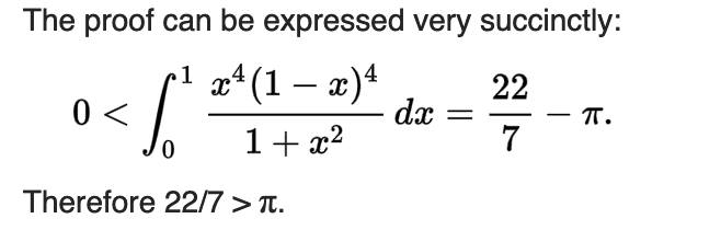

Other one, one of my favorite (also came in one JEE exam) is this beautiful and famous integral, one from the earlier Putnam..
Beautiful! can be evaluated by elementary methods (tedious - express as polynomial + (something)/(1+x^2) and integrate).
My question is - how can one discover such an integral?
Added -
1. I want a positive definite integrand.
2. I use Integral of 1/(1+x^2) from 0 to 1 is Pi/4
3. I possibly want a 6th degree term in the integrand to get a factor of 1/7 on integration.
What else?

A_Gupta wrote: 09 Aug 2025 21:43 My question is - how can one discover such an integral?
The history is here. The recent oldest discovery seems to be by Mahler.
Look at this paper by Lucas.
https://paperzz.com/doc/8519004/integra ... %3E-%CF%80
or PDF at ResearchGate page of Lucas https://www.researchgate.net/publicatio ... t_355113_p
Evaluation of the integral itself easy but tedious using partial fraction expansion.
