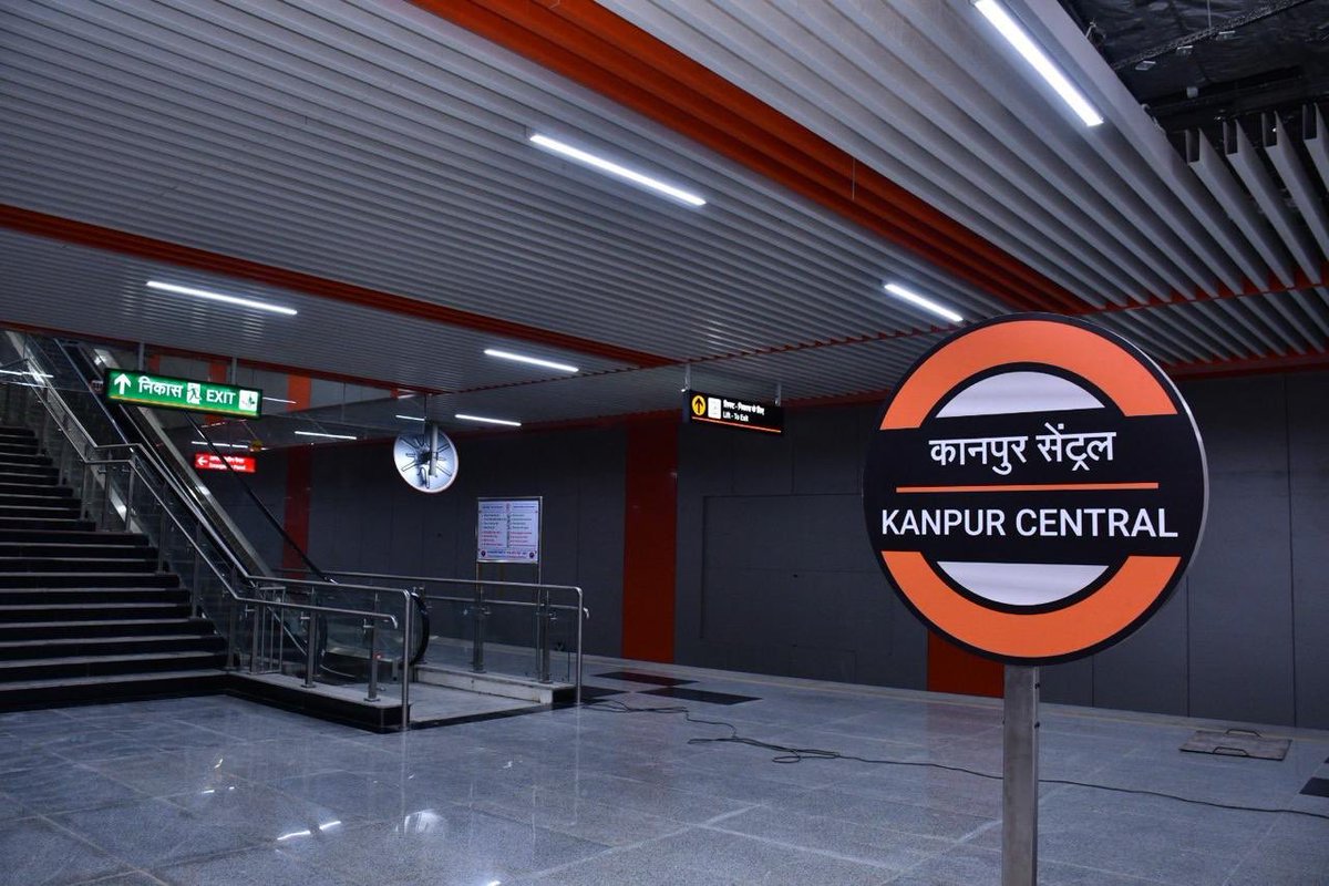

Good news..( Railway Minister does not forget his alma mater IIT K)
Great news for Kanpur!
The entire Metro Line-1 (IIT Kanpur to Naubasta) is all set to open on 26th January another big step towards a smarter, faster, and modern Kanpur.
A new era of smart travel begins!
