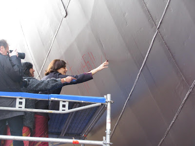

India's new Fleet tanker launched in Italy. Pics at livefist link given below
http://livefist.blogspot.com/2010/02/ph ... anker.html
Re: Indian Naval Discussion
Nihat wrote:India's new Fleet tanker launched in Italy. Pics at livefist link given below
Look at those grotesque welding joints!
What u get outside is what u get inside in this case.
Shame on Fincanti, India gets short changed.
Shoddy job now shabby stuff 2morrow!

The ship is LAUNCHED...not commissioned. There is a big difference. Lets see the pics when she is commissioned. Whenever welds are done, they are done this way (yes sir)...and then they are polished down (and this applies to almost any welding which is done).ankit-s wrote:Nihat wrote:India's new Fleet tanker launched in Italy. Pics at livefist link given below

The Visby was not a pure metal ship. Having said that, check out these pics when the USS Nimitz was launched...ankit-s wrote:The ship is LAUNCHED...not commissioned. There is a big difference. Lets see the pics when she is commissioned. Whenever welds are done, they are done this way (yes sir)..
Did U see such a difference when Visby corvette was launched ?
A simple question!
http://www-tc.pbs.org/weta/carrier/asse ... _large.jpg
You can clearly see the weld lines.
Also the ship is not considered a capital ship and is comparable to most tankers across the world and is manufactured in a general shipyard.

Take a look at this : http://upload.wikimedia.org/wikipedia/c ... skrona.jpgankit-s wrote: Show me ANY such naval Item from sweden please (leave Visby) - sweden never compromises on quality, it depends on countries who want to preserve thier business on quality control. Look at kockums VLCC construction, it is certified for welding according to EN 15085. And they are European standards, means every european company complies within europe that is, but they cheat when it comes to India.
and this: http://upload.wikimedia.org/wikipedia/c ... Harbor.jpg
The Carlskrona is a mine layer and one of the largest ships in the Swedish Navy. You can clearly see the weld lines in both pictures. So your point about Sweden is moot. I can show you numerous European ships that are exactly the same.
You have yet to prove that the Italians have in any way "cheated" the Indian navy with their construction. Failing that everything else you've said is irrelevant to the discussion. The Fleet tanker was not in fact build shoddy as you want us to believe merely because you could see the weld beads clearly in a close-up of the hull.ankit-s wrote: Every country should follow higher international standards for the benefit of thier own future business if not for recipient countries - repeat orders is the name of the game! If they dont, thats where we have problems because they do it selectevely, where they can get away.

These four photos, the first is a frigate commissioned in the 80s, the second a destroyer commissioned in 2005, the third is an amphibious landing ship commissioned in 1995 and the fourth another LPD commissioned in 2009, show weld lines. These are USN vessels.
http://www.navybook.com/nohigherhonor/art/servant3.jpg
http://upload.wikimedia.org/wikipedia/c ... ose_up.jpg
http://upload.wikimedia.org/wikipedia/c ... SD-49).jpg
http://tinyurl.com/yewp8jm
http://ongofu.files.wordpress.com/2008/ ... york-1.jpg

Look at this photo of the welding job done as under and compare it with your 2009 USN and see the difference (also note the one inch plate shoddy patch job up close) All they need is to grind the raised weld beads and make it look like a quasi seamless finish. But its a laborious job and they skipped it.
http://tinyurl.com/ya6tlac
Boss, arc welded joints are like that onlee...and nobody grinds it to make it look better - not only that it is not necessary, but is detrimental to the strength of welded joint - something like applying powder on the butt of your girl friend!
And when plates (even thick ones) are welded to the frames inside, there will be a wavy appearance - it is unavoidable, whether in India or abroad. It happens because, while welding, there is stress/strain on various metal parts due to the sudden rise and fall of temperature.
Slightly off topic, wrt the launch of the fleet tanker Deepak by Fincantieri. This picture of the launch appeared on Livefist of Mrs Farida Khan, wife of the Indian ambassador 'christening' the ship.
I can see a cross, a swastika. She is in the process of writing something else.
The navy ship launches I have seen, I have been too far away to see anything more than the coconut being broken. My understanding is that the prayer is followed by writing the signs of the 4 major religions like in the army's combined temples, which cater to the 4 major religions.
Anyone know more on this? Please add to this. I would love to know more tradition.
