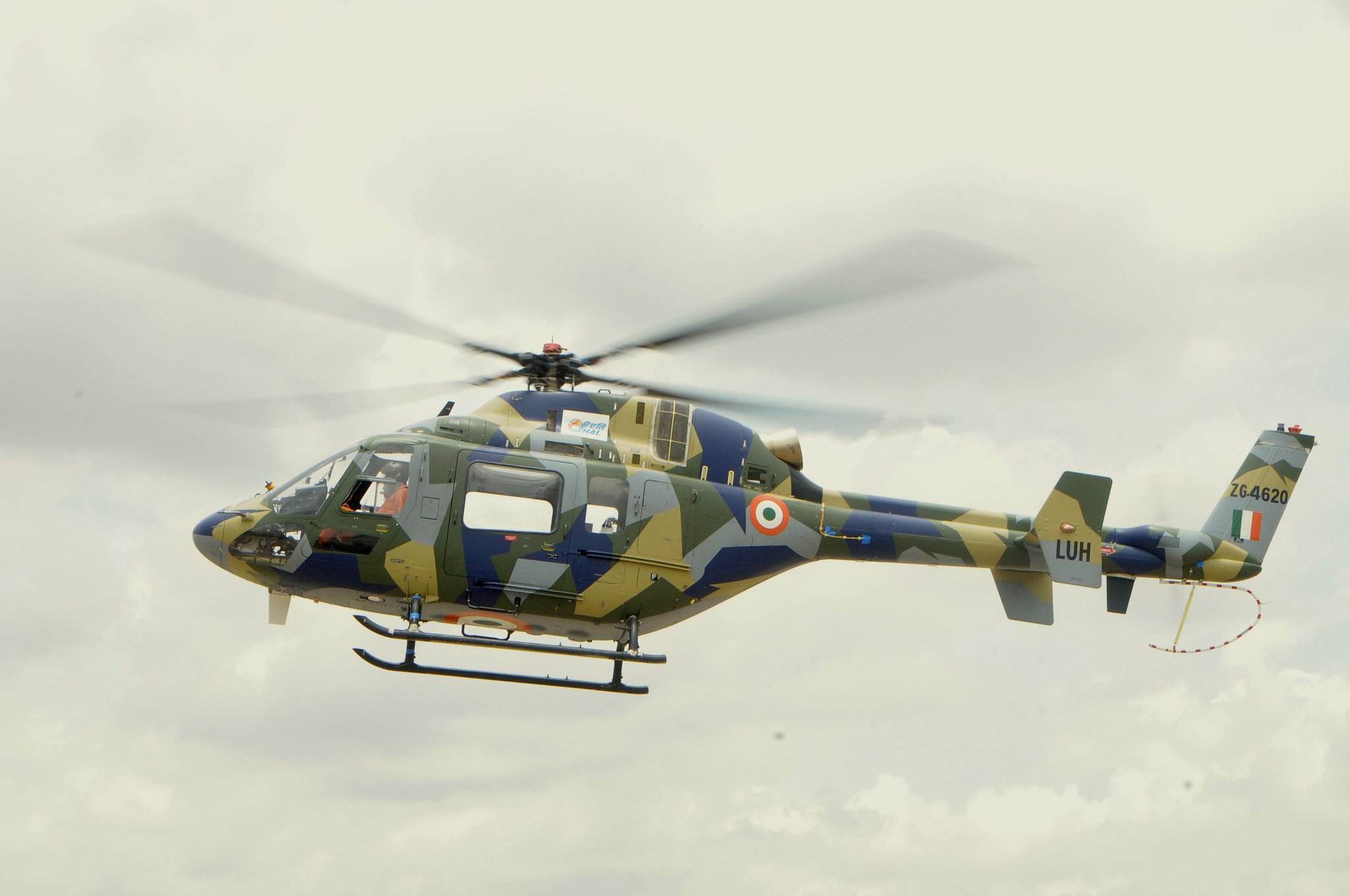

Another From @livefist
Another photo from today's first flight of HAL's Light Utility Helicoper. 3.1ton / Range: 350km / Ceiling: 6.5km

It's in Army Camo already for the first flight!? Nice!
