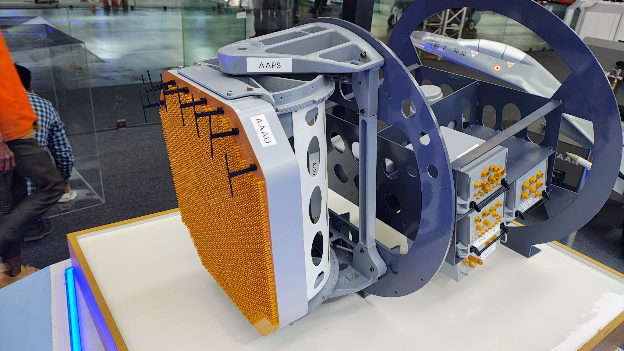

Explained: The Indian Navy's New Game-Changing Radar
On 31 July, a Hyderabad-based company named Astra Microwave Products Pvt. Ltd. issued its annual report. Buried in dry text, under the heading “Major projects due for delivery during the year 2023-24”, was an innocuous line item: “6 Mtrs S-Band AAAU for strategic Naval application of DRDO”.
Astra Microwave’s new radar is a major step forward in this challenging domain.
With a diameter of 6 meters, it is a whopper!
Even the Americans, whose strategic planners have been screaming for a 6-meter antenna for years, have been restricted to a 4.3-meter radar because that is all the deckhouse of an Arleigh Burke-class destroyer can accommodate.
In technical terms, this radar is called an AAAU – an Active Antenna Array Unit.
Very little information is available about it in the public domain (and rightly so), but we do know that it has been installed on the Indian Navy’s secretive testbed, the INS Anvesh (which was commissioned into the Navy in a low-key ceremony early last year).

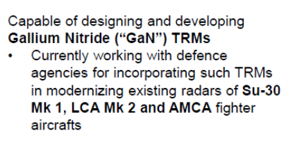

Don't know the source of the image, but FWIW...
https://x.com/Rethik_D/status/1724662047806570977?s=20 ---> It's confirmed! GaN-based AESA radar for all our upcoming fighter jets!
- LCA MK2
- AMCA
- Su-30UPG
- TEDBF

Below is part of a twitter thread from a twitter user who went to the IDAX (Indian Defence Aviation Exposition) at Jodhpur.
Representative picture of Uttam below (from Kuntal Biswas) indicates that the # of TR modules is 784.
https://x.com/Tanishq_bafila/status/1835002549583462488 ---> News regarding UTTAM AESA. Will have close to 1,000 TR modules for the Tejas Mk1A.
