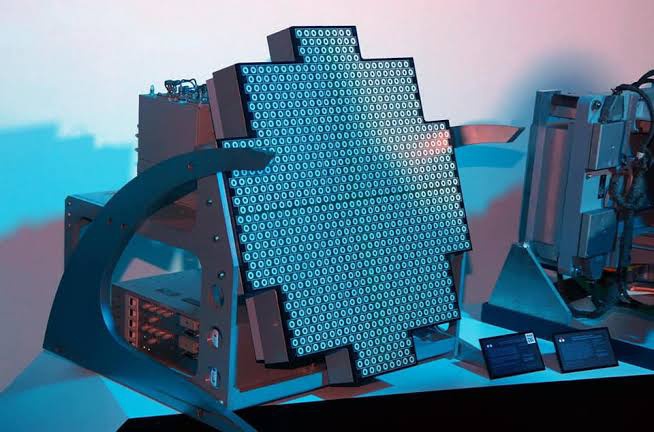

SaiK wrote:
http://media.bharat-rakshak.com/aero/ma ... temId=4216
I counted 904 t/r modules!
Pit commented in his article "Mig - new developments" in the Fulcrum mag that it has 680modules !!!
Pit -- can you comment on that !!!
siva wrote: It has 680 modules only. SaiK check again (28x8 + 24x12 + 20x4 + 16x4 + 12x2).
sorry, you are correct siva: i doubled the center one, thiis i made 28x8 twice, and hence 904. it is 680. my boo boo.
